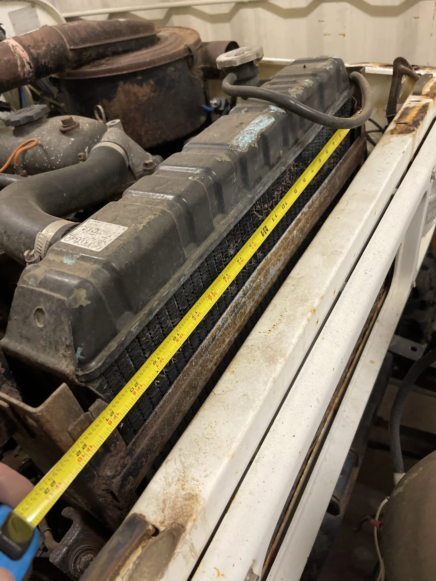

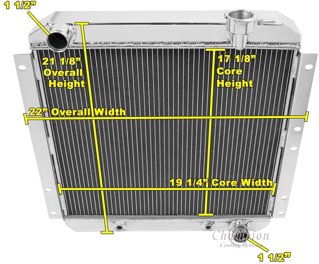

With the search on I found that most all radiators shown for 1970-1980 FJ40/45 listed had a width of 22" . That measurement is from the lip/edge of one side of the mount brace to the outside edge of the other sides mount brace on the radiator. Not from center line of the mounting holes, edge to edge. This is what holds the radiator in place in the core support with 4 or so bolts on each side.
The Champion C-180 and the CSF-180 were the ones I was considering but after I did a bit of measuring of the radiator that is in place now found out that the 22" in width radiators sold would not be able to be mounted or the holes on the new radiators would not reach the mount holes on the core support (cradle).

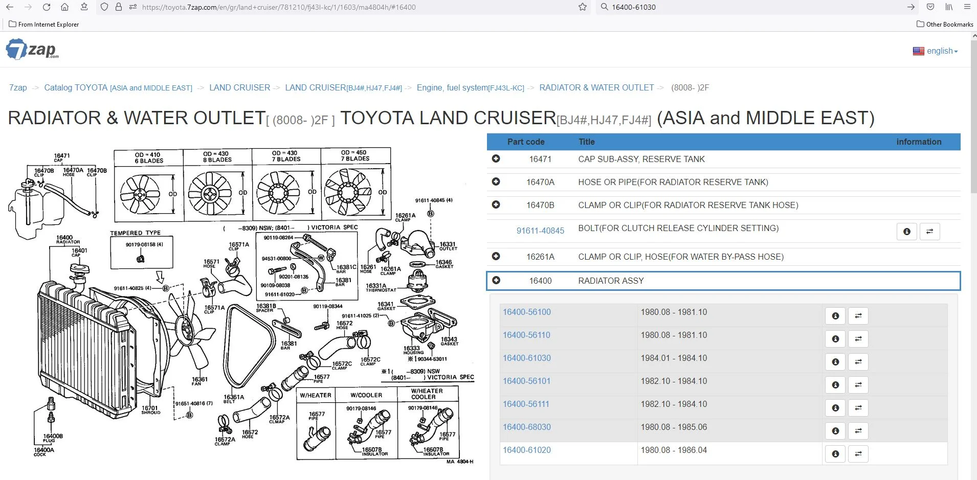

For an Australian 1982 FJ45 the book calls for a part number 16400-49356. The part number in the picture below is the old PN. The Champion and CSF listings referrer to the part number as a part to replace the original equipment.

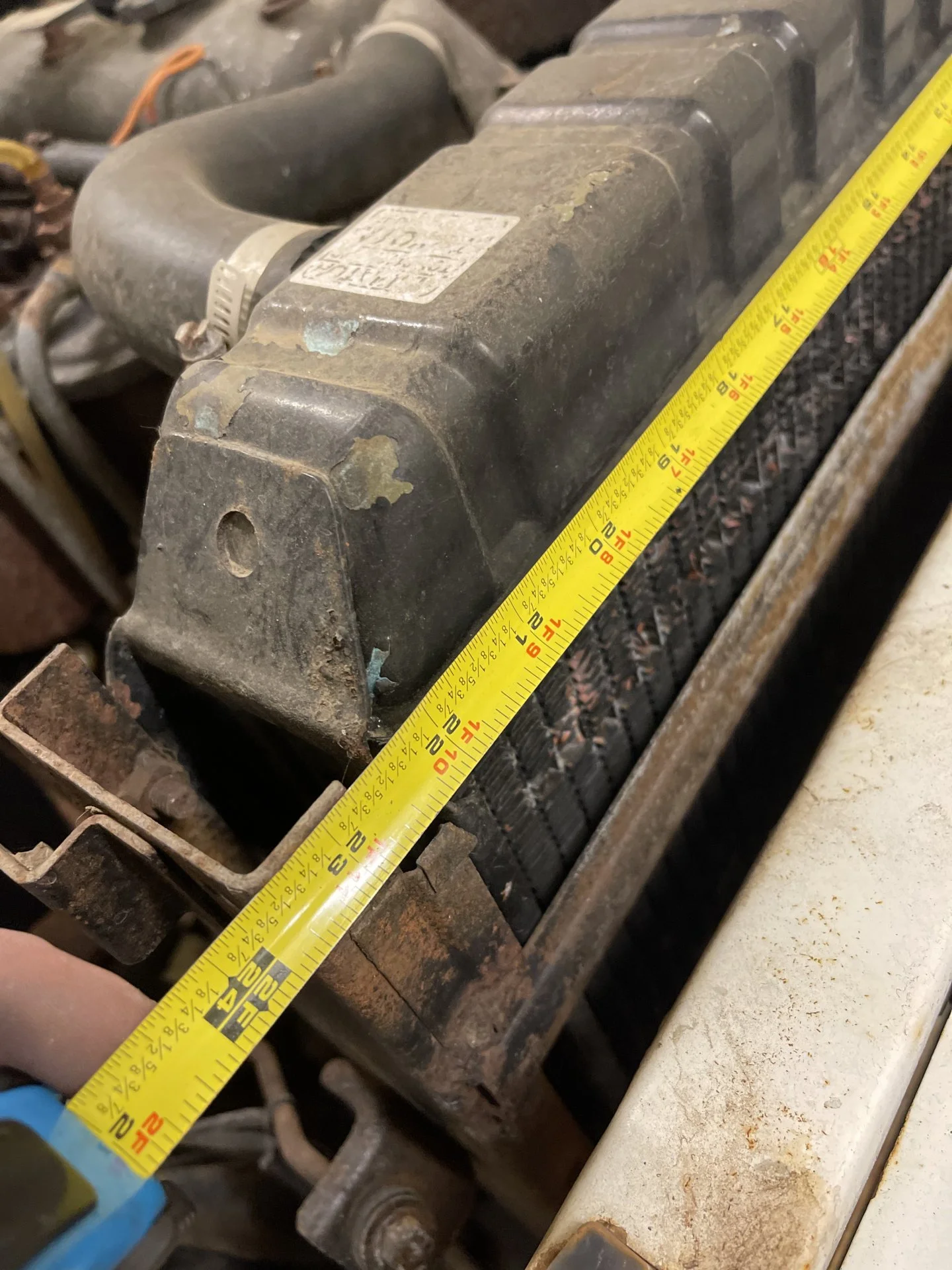

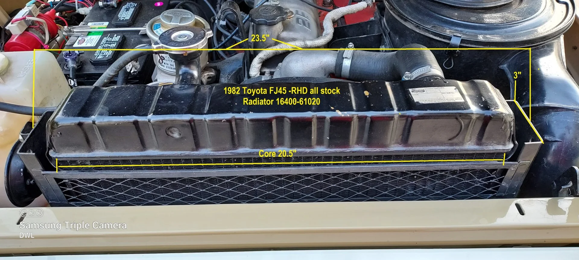

With a few more measurements I found that the radiators core on the 82 was also larger (see picture). I measured a 1981 FJ40 (stock USA) and it's core support was 22" across that was good for the USA sold radiator.
So either the radiator/core support in the 1982 is not correct, or the Australian FJ45 and possibly Troopy's in the 1980's were stocked with a larger radiator for the high temps of the outback.
I am interested in if this maybe true that the USA models were with a 22" wide core support and smaller radiator and the Australian rigs had a much wider support and lager radiator installed or maybe it was an option at the time.
Out of curiosity I would like to ask if any other owner of a FJ45 of the RHD Australian models or others would take a moment and measure the core support and the core width in your rig and maybe post your finding, maybe I just have a strange setup from years ago.

Okay after days of searching for a replacement radiator for my 1982 FJ45 from OZ, seems as like most parts for the old rigs they are pretty much gone.
I found that the radiator I have is what is called an Oversized radiator part number 16400-61030. The 16400-61020 the has a new number of 16400-493556 is for mostly the FJ40 series with the 22" core supports sold just about everywhere.
I could not find any picture dimensions for 16400-61030 but what was shown in written dimensions pretty much fit what I was looking for.
I did find one radiator in OZ with that PN for $600 and no price on shipping. Also that part number comes up as a Forklift radiator replacement but with very little detail and at $800 plus.
So the conclusion as with most older parts is fix what you have or adapt what you can. I am now going to see if I can have this 16400-61030 oversized radiator completely rebuilt before the online replacement radiators take over completely and there are no more radiator shops left, I guess its coming.
The picture here shows several part numbers radiators for the FJ45s of different years so maybe this posting will be a help to us 45 owners.
