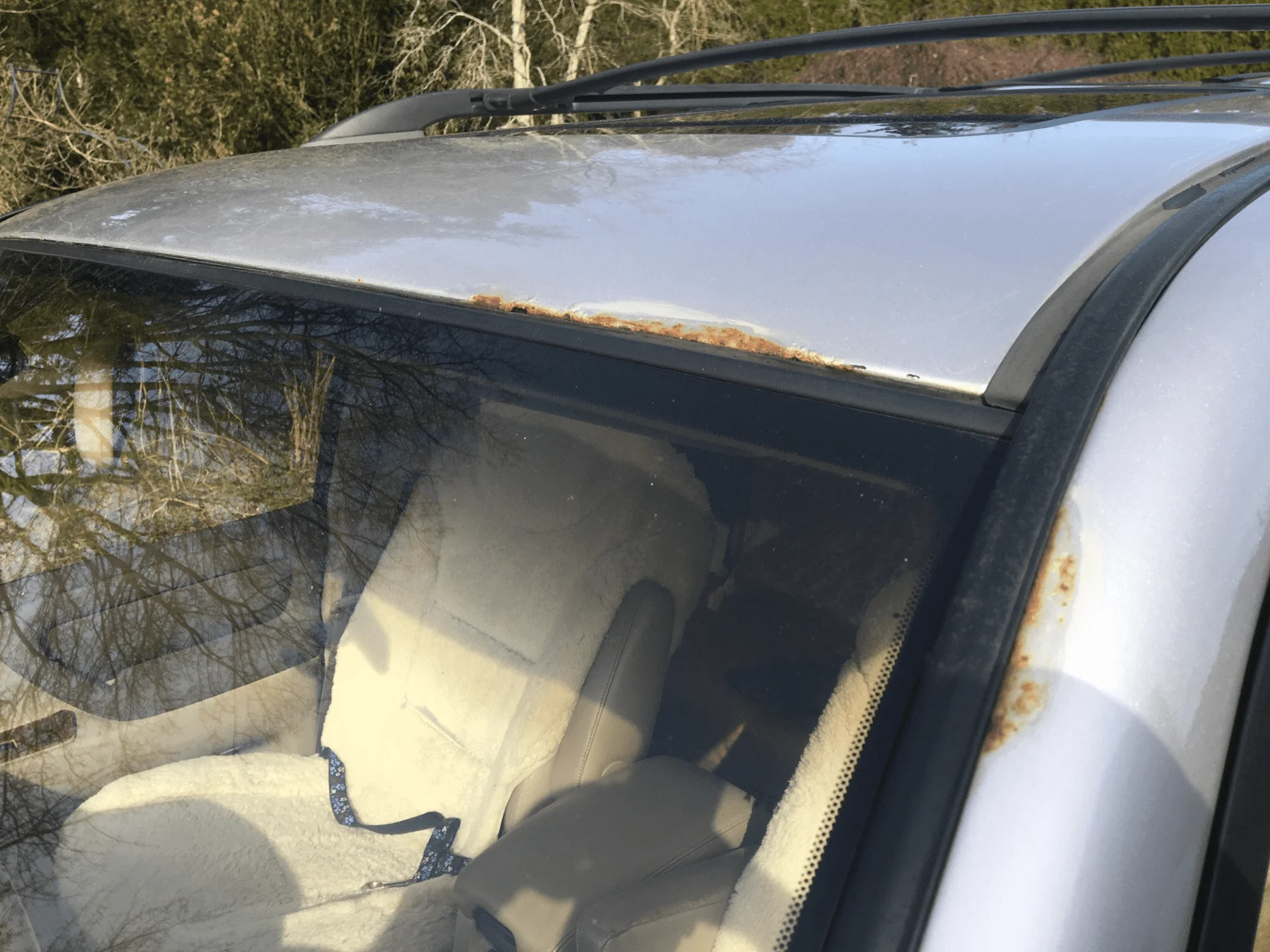

AW- I’d still look at getting that rust fixed. Mine has it in the same spot. If it doesn’t get repaired, it will eventually start allowing water to leak in behind the glass. I’m going to repair mine when the windshield comes out to be replaced shortly. You can probably do the repair yourself. Just get a rattle can of touch up paint and go for it. I’m just doing it when insurance is paying for new glass as you want to do it when the glass is out.
I've never "repaired" rust on a vehicle before. Will simply applying some rattle can paint over the affected areas keep the rust from spreading or getting worse?
The answer is no. Im dealing with some rust on my passenger rocker panel on my Z71. It sucks. In your case, more than likely, the window would need to come out to get to rust you cant see. Nothing you spray will stop rust. Its like cancer, you have to get rid of it completely, either by grinding it off or cutting it out and patching with new steel. Youre in a tight spot with that windshield.
swill is correct. You will need to probably have the windshield taken out to properly fix it. Rust never sleeps is more than a Neil Young album, it’s the reality. The fact is, regardless of how dry your area is, the rust has got a foothold, and you need to deal with it as soon as you can. Getting it down to bare metal is what you need to do in order to keep it from getting away from you.
Frustrating. Okay. Thanks for the tips. I'll start looking into my options.

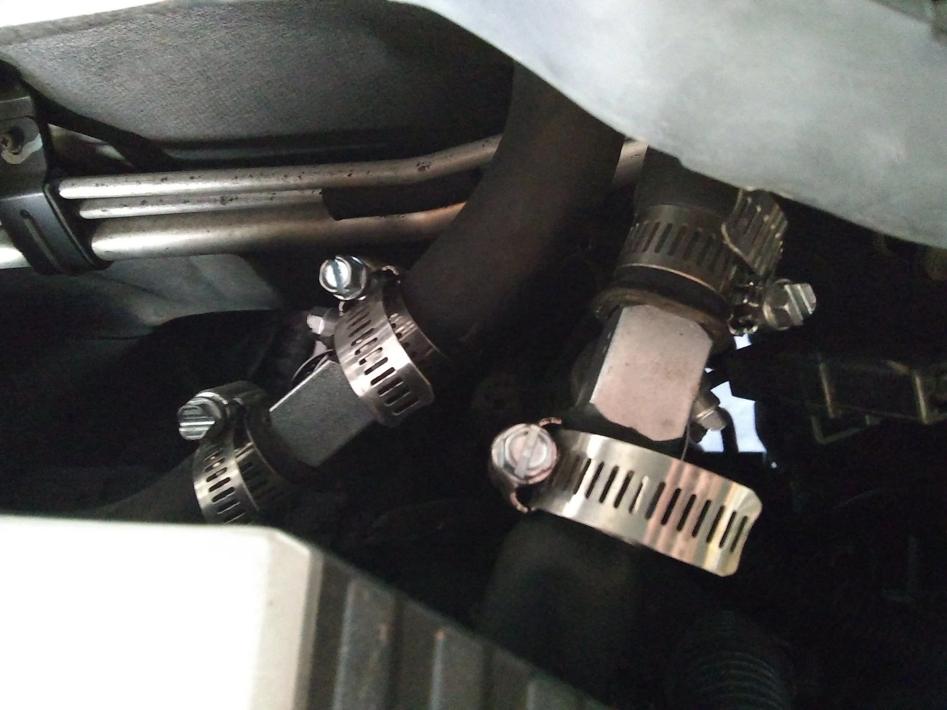

Finally took care of my heater tees. They crumbled when taken out. I was planning on OEM but my mechanic (and other mud members) talked me into steel ones.
Happy I finally got it taken care of! Now I don't have to feel bad every time I see heater tees come up here!
Any idea how quickly rust like this spreads in a dry climate?
Well, it won’t necessarily spread fast, but it WILL get worse where it is already. It’s not like you have to do anything this weekend, but the sooner you get on it, the better. I had my glass out a year ago and did a “repair” that was a wire wheel to clean-ish metal, then a rust neutralizer product, then etch primer and paint. Rust is back again in a little over a year, and it looks to have spread a bit, so make sure you do your reasearch and do it right the first time!
Bummer that it came back already after you spent that time and energy. What's your plan going forward?
I have to replace the glass again, so I’m going to get that removed, then take it back to my shop and get serious with making sure it’s all bare metal. Last time I did it at the glass shop, and really couldn’t take my time as I only had a few hours. I’m going to paint the entire thing as well this spring, so I don’t mind going a bit further into it.
Bodywork is not technically difficult, you just need to follow the steps. If you can mix 5 minute epoxy, and use a sander, then you have the basic skills to do body work. It’s just different products. With your truck being white, it will be easy to touch up your paint with a factory color rattle can. Mine is a metallic color, so touchup is harder. I’m going to solve that by painting the whole thing white, which is the color my wife wanted, but the best 100 I found was the champagne color.
Mine is much worse than yours, but if left alone, yours will get worse...

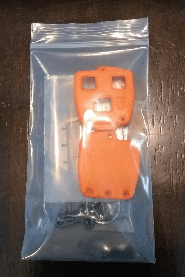

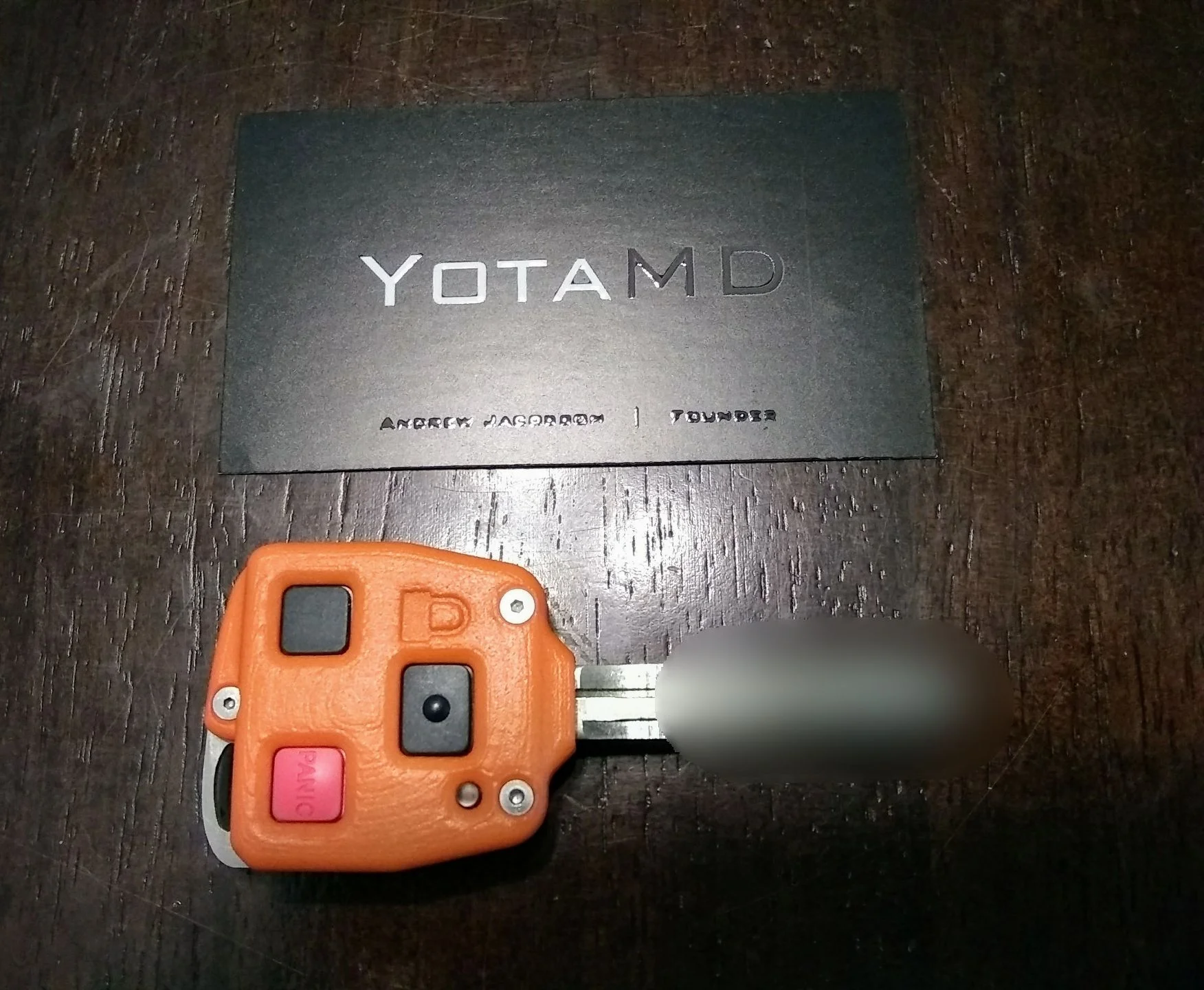

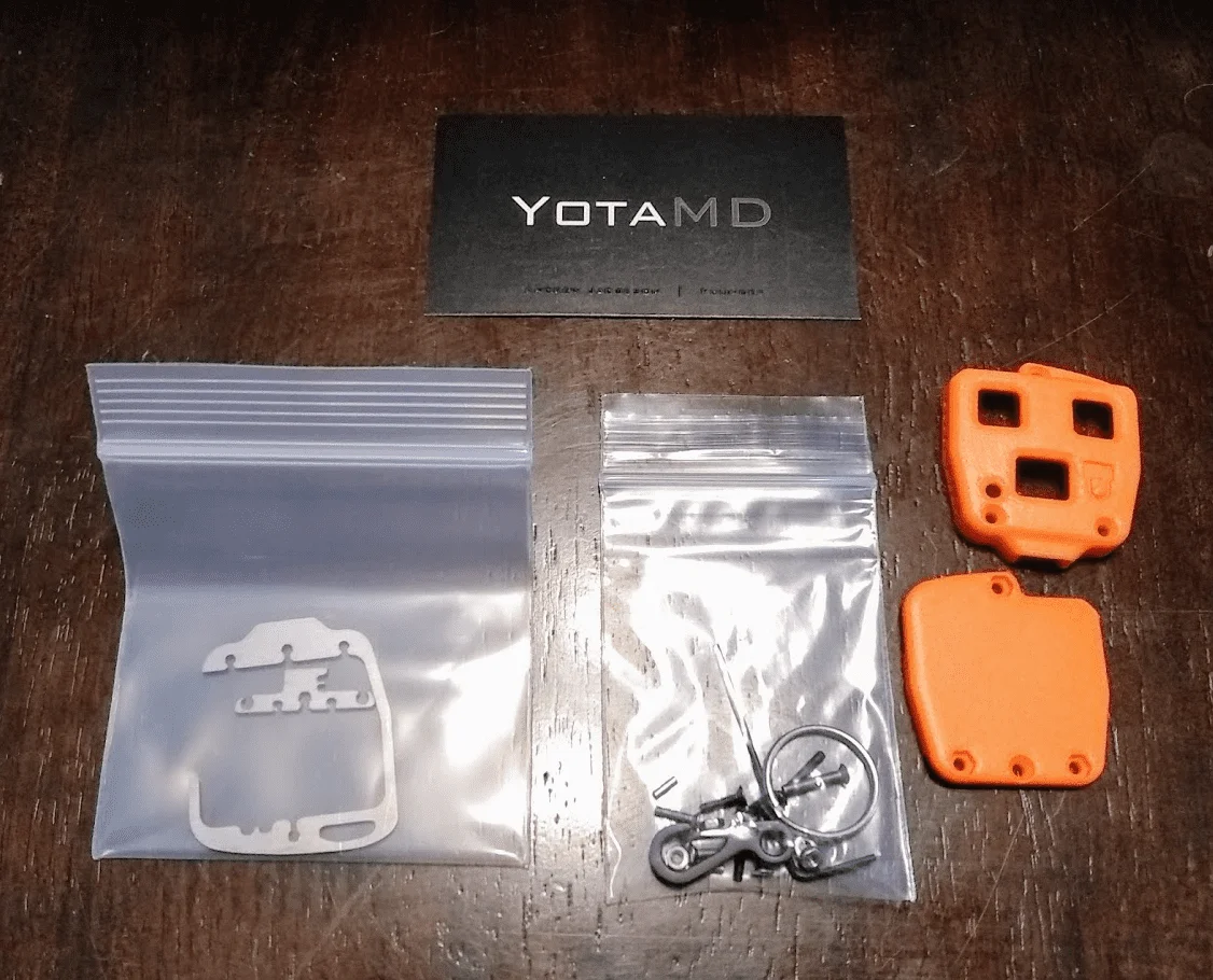

Finally grabbed my YotaMD Titanium Integrated Remote Key Fob Shell from @suprarx7nut.
point-blur_apr252018_203243-jpg.1686462
Everything is really high quality. Love cranking that engine (even more than before).
In case anyone runs into a similar situation, my existing key shell was a fairly new Denso unit. The plastic that housed the T end of the key was so strong, I had to use my Dremel tool to grind away the plastic to free the key. Once done, the install into the YotaMD fob shell was quick and easy.
