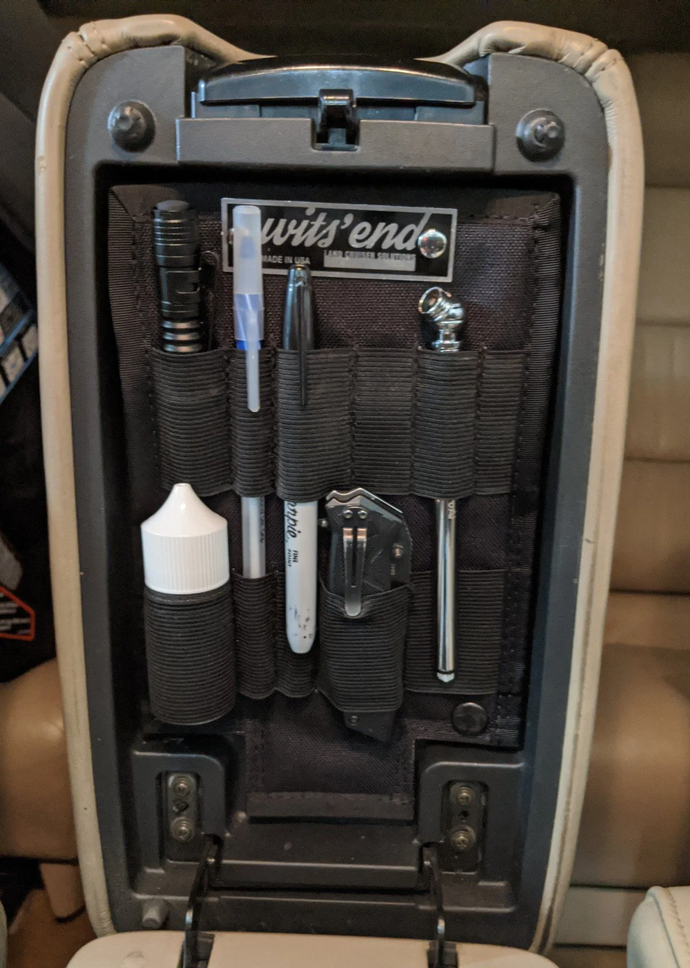

Installed my Wits' End APU-4 center console organizer. Install was quick and easy.
I'm happy to pay for anything that helps me stay organized.

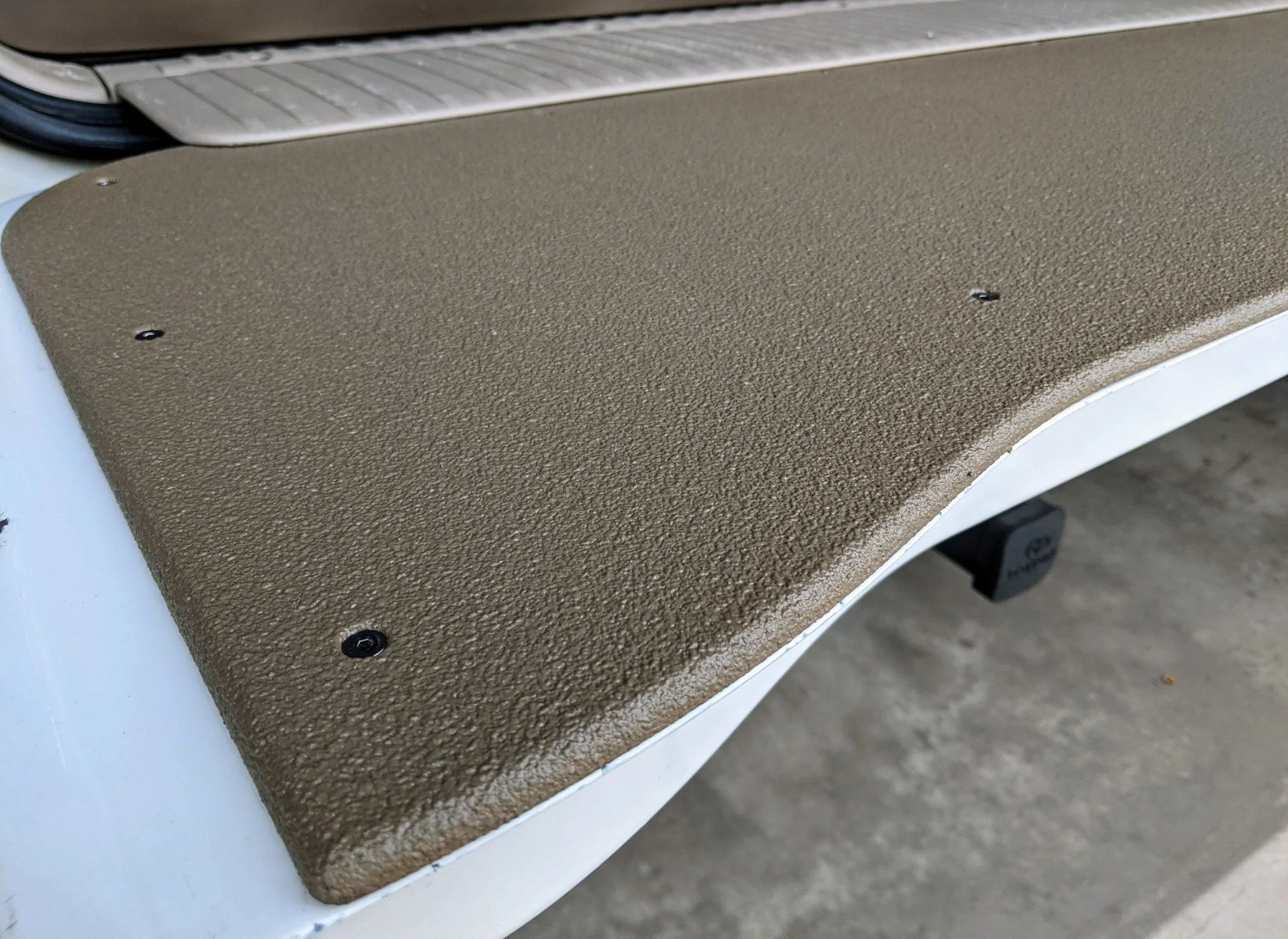

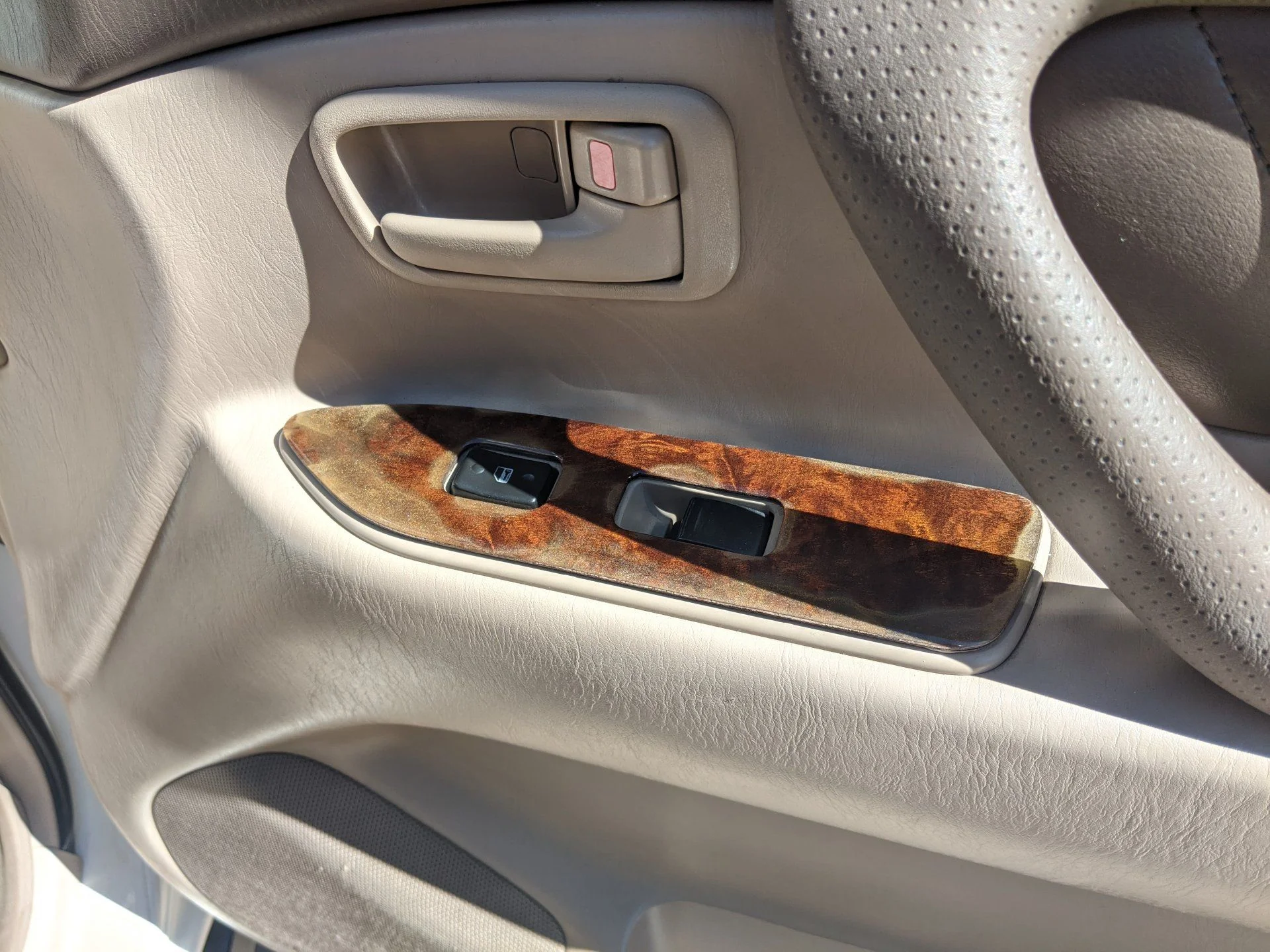

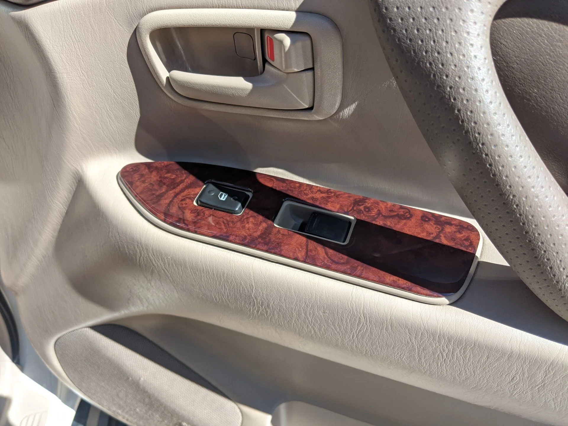

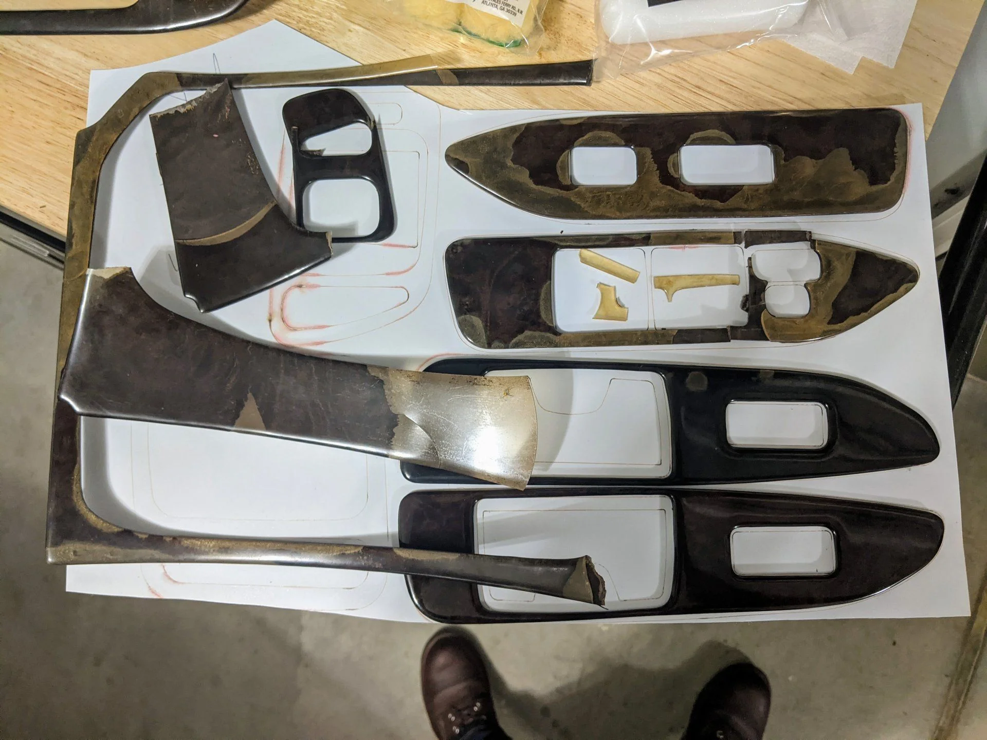

Removed my old fake wood trim and replaced it with this kit from Amazon.
Amazon product ASIN B005GPG3IW
Overall, I'd give it a 9/10. A few of the pieces had poor adhesive and wouldn't stick. I'm waiting to hear back from the seller for replacements. On a few others the fitment seemed just a touch large. Aside from trimming slightly in a few places, everything went on easily.
I took the advice of others on mud and let my truck sit in the sun for an hour before removing the old trim. That allowed me to pull off the old stuff relatively easily.
Finished Product
I was able to cut and sand the blank right piece on the center stack with my Dremel to match @BenCC's printed piece for Ram mounts.
New Door Control Cover
Old Door Control Cover
Some old pieces of trim
I know many simply remove this trim as it ages. I like wood in cars, even if it's plastic and stick on. So I'm happy.

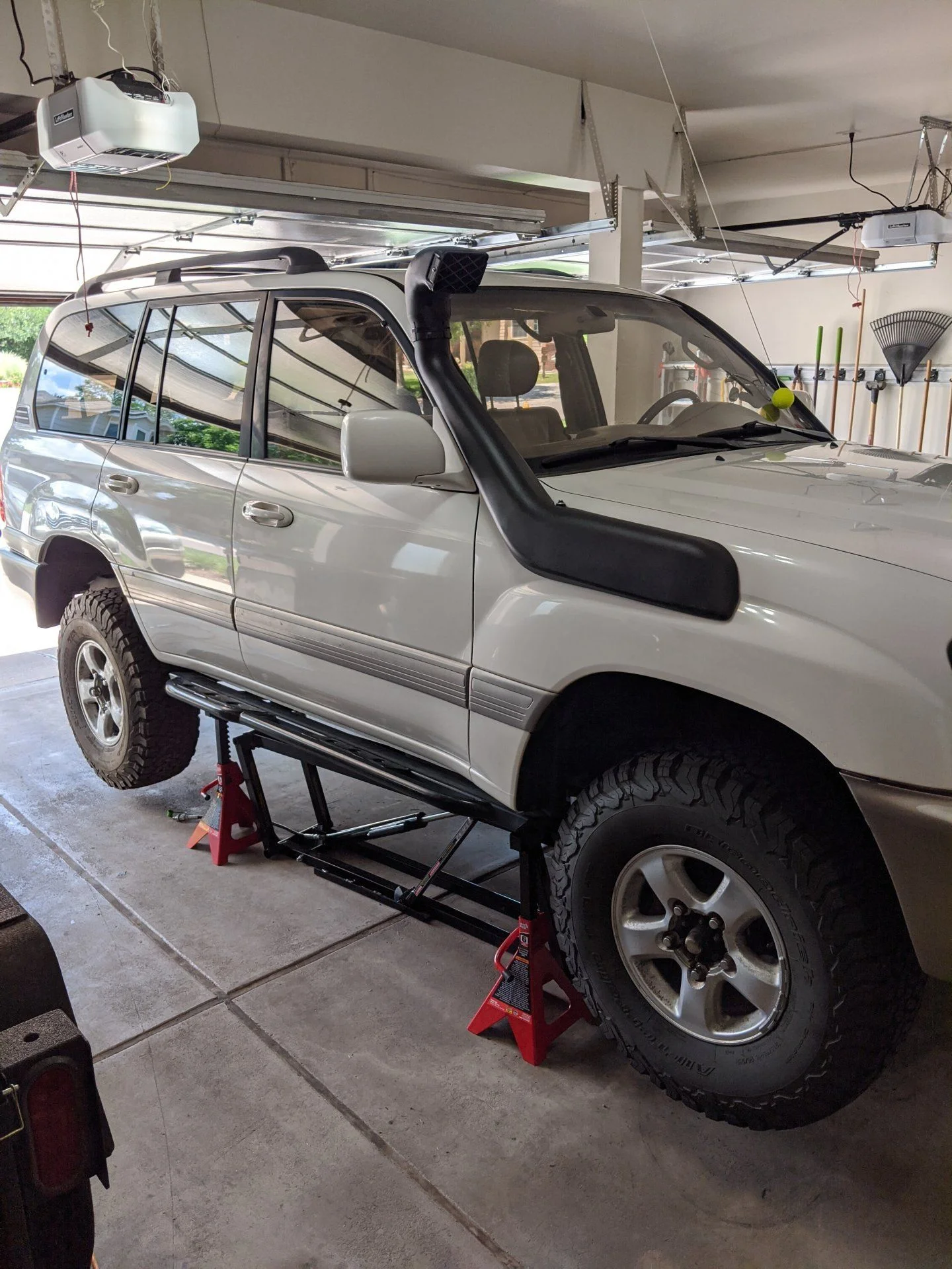

Installed my Dissent roof rack.
Install was straightforward. The most tedious part was removing the old OEM rack and cleaning the gutters and old tower areas of dirt and adhesive.

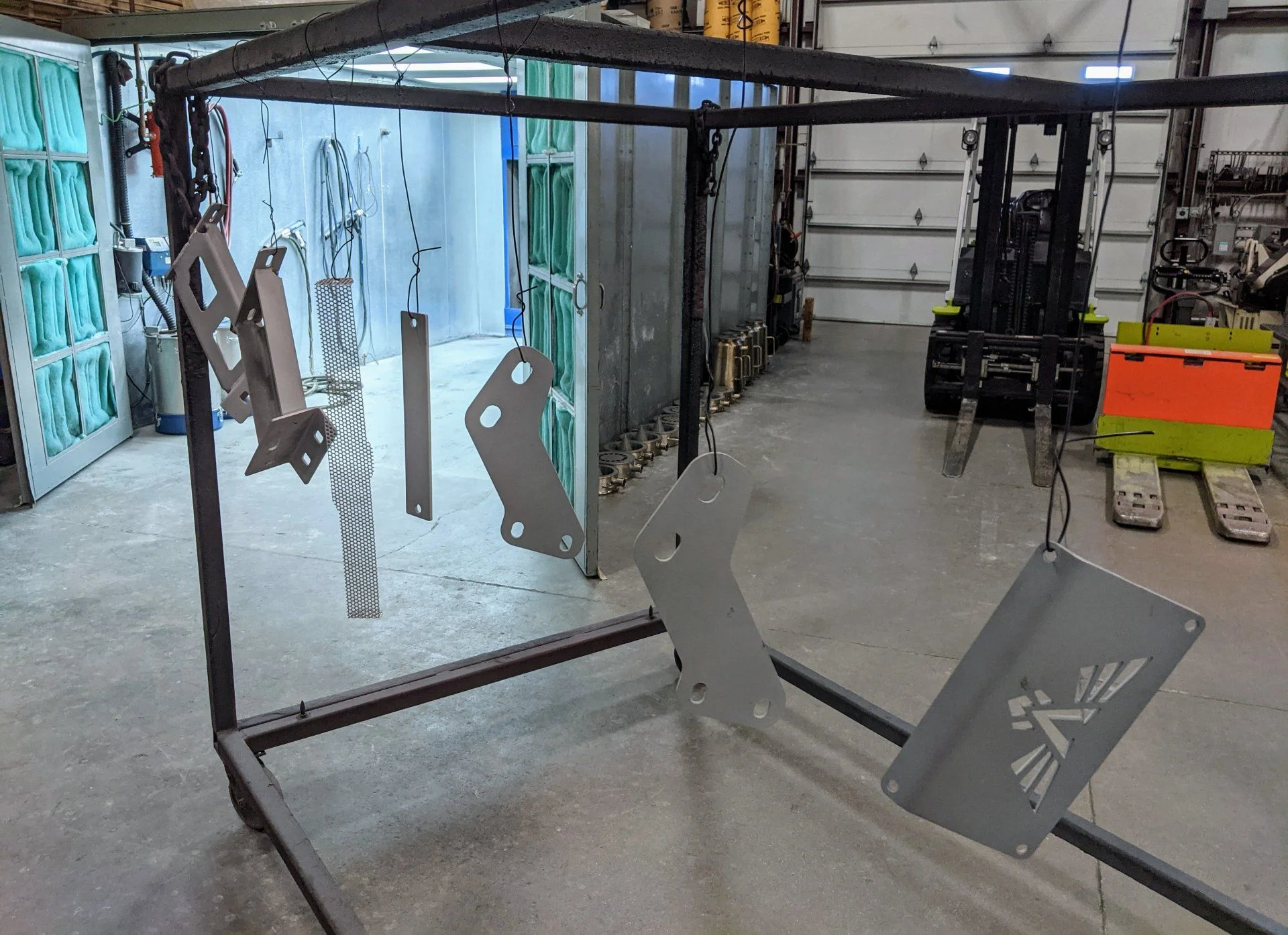

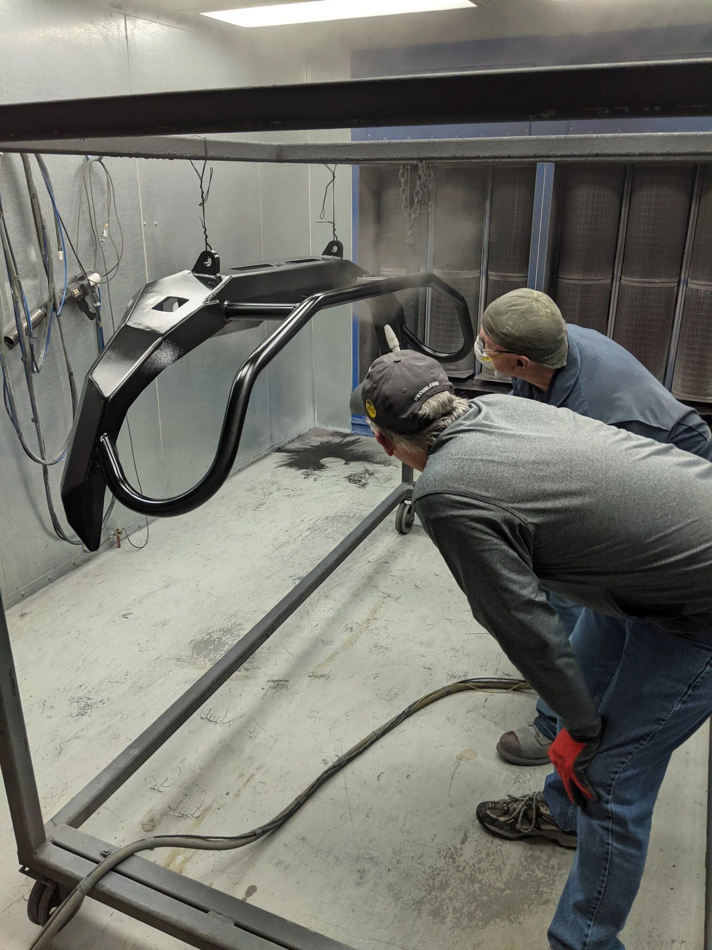

If you don’t mind, what shop did your Powdercoat, and how was pricing? I have the 4X4Labs labs rear bumper and am looking at finishing options (and live nearby).
This is a private shop I have access to so unfortunately I can't provide a recommendation or pricing. Sorry.

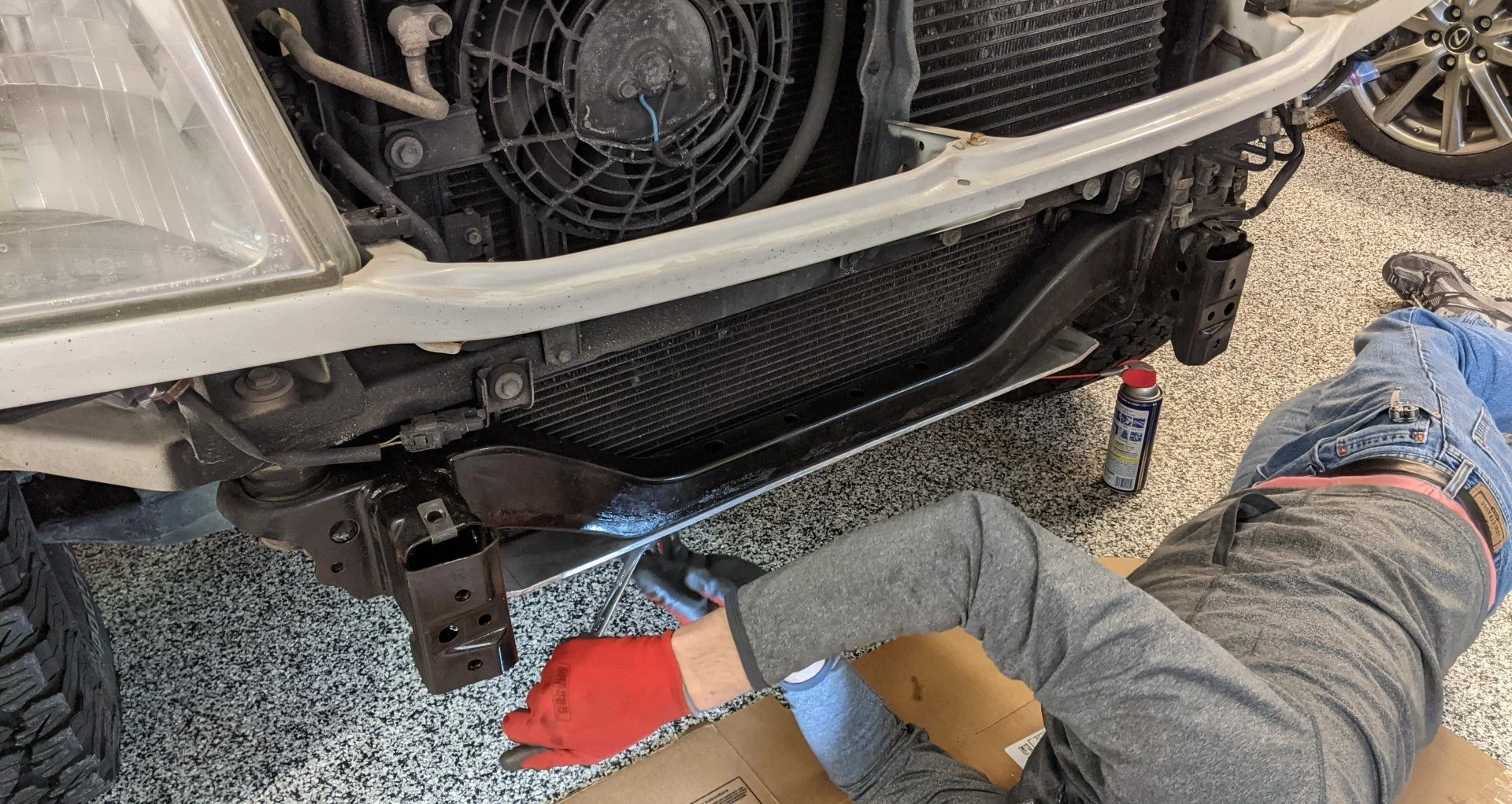

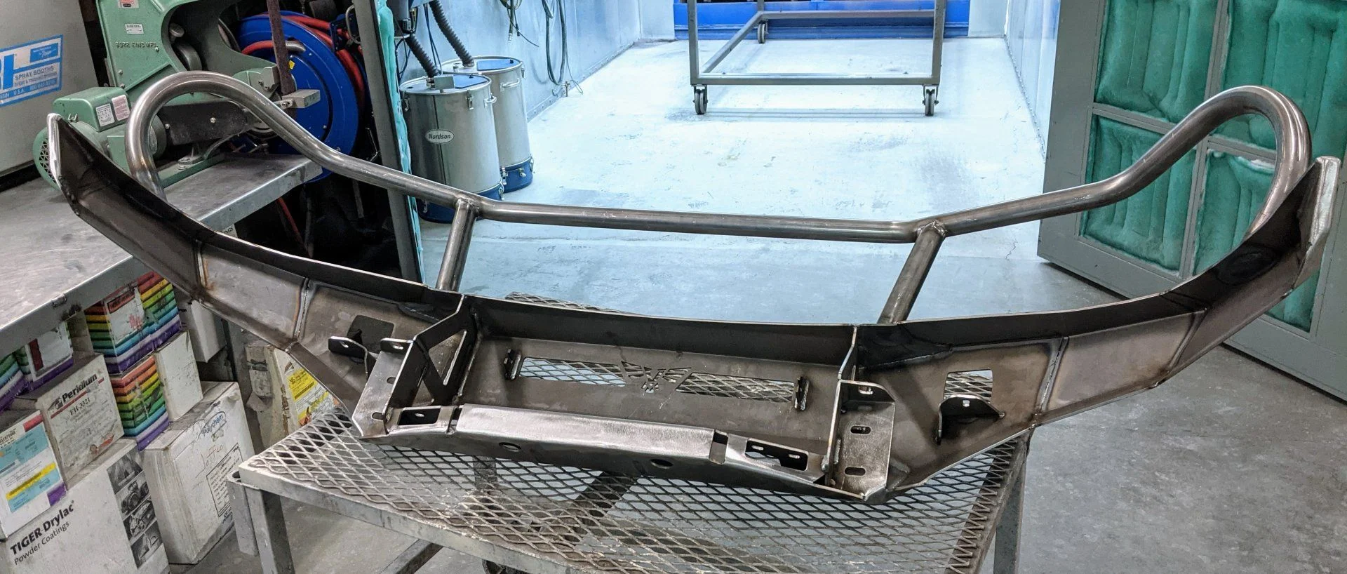

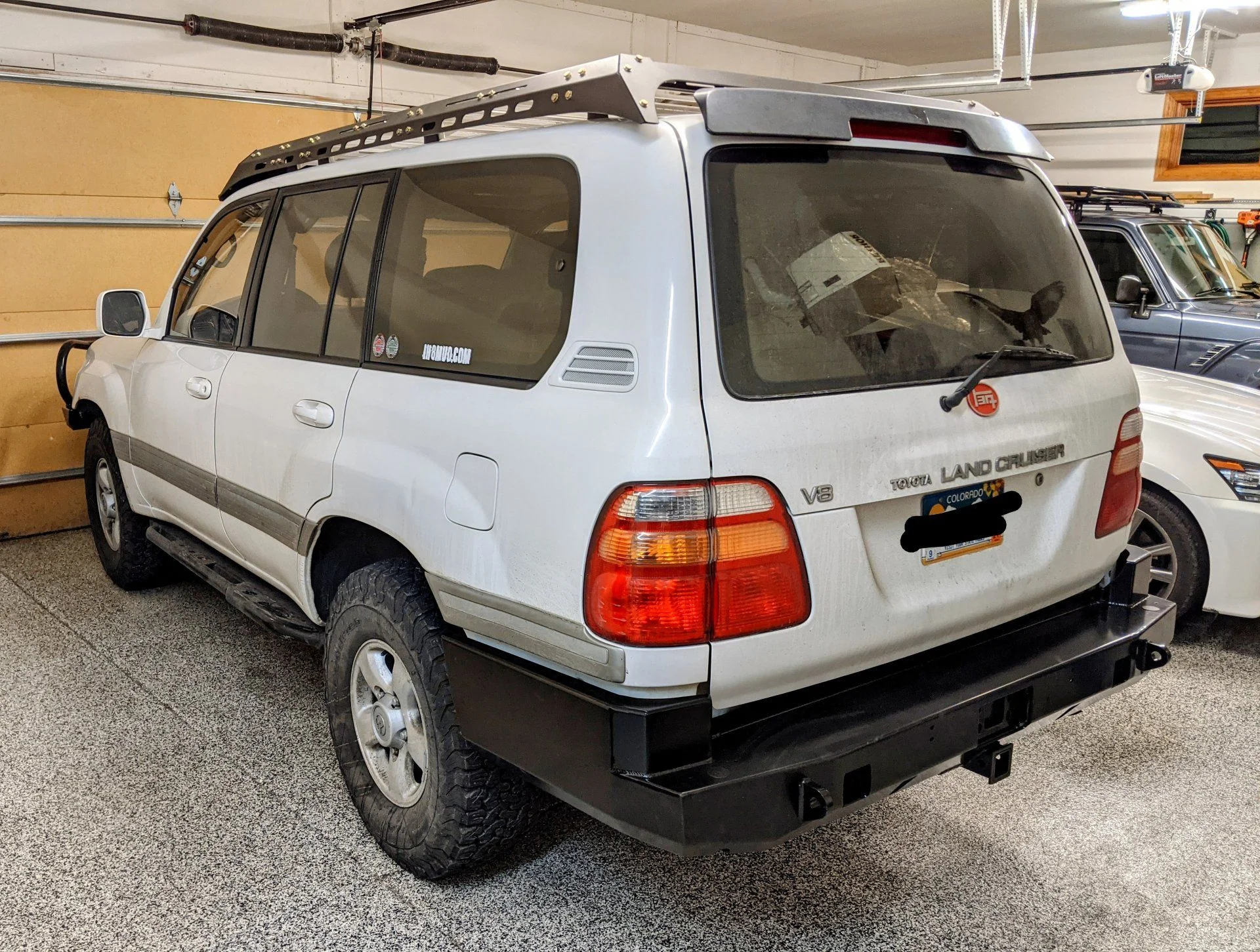

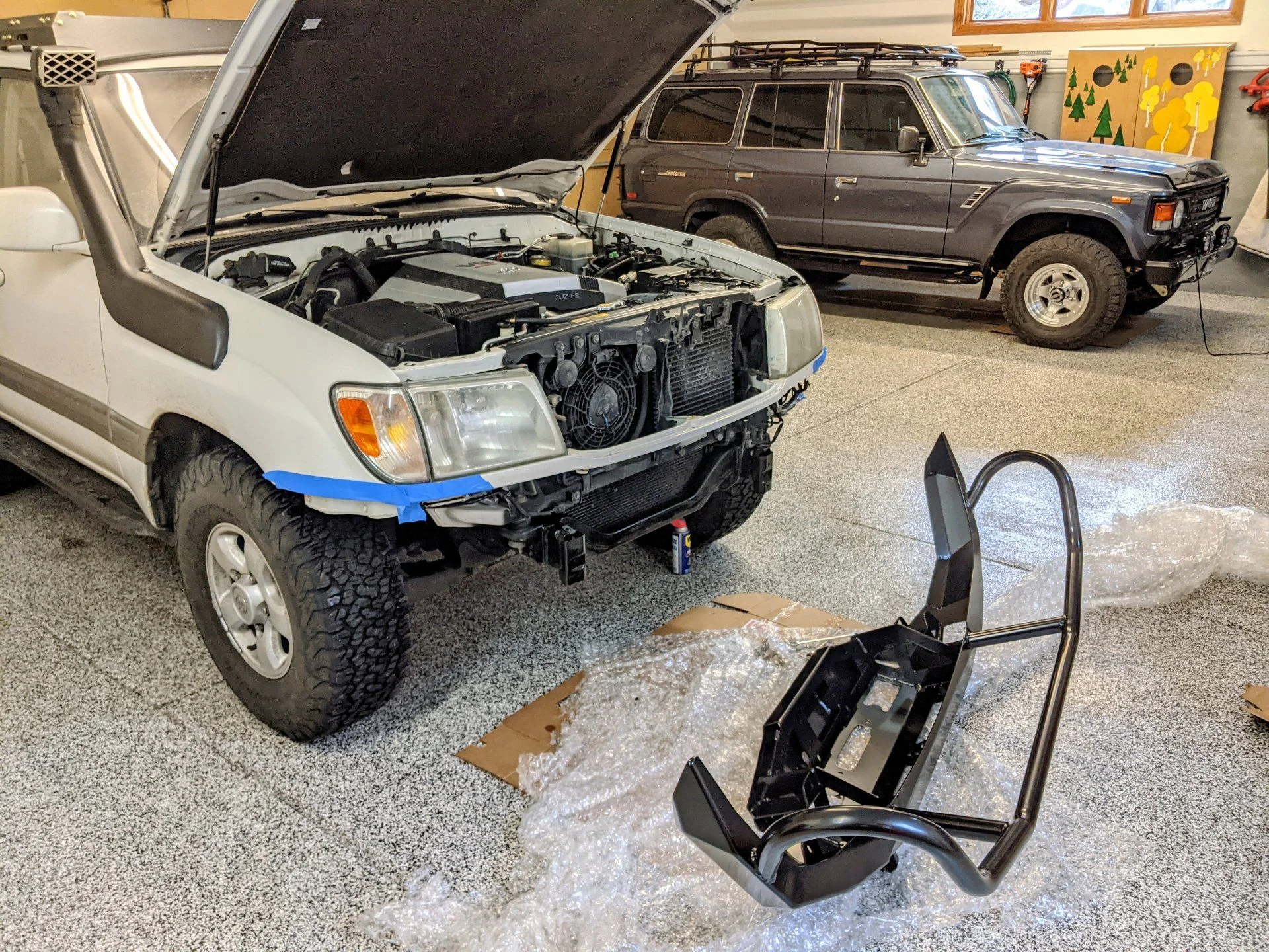

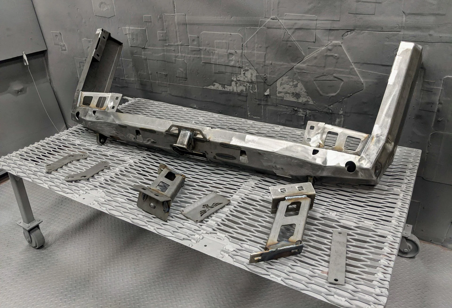

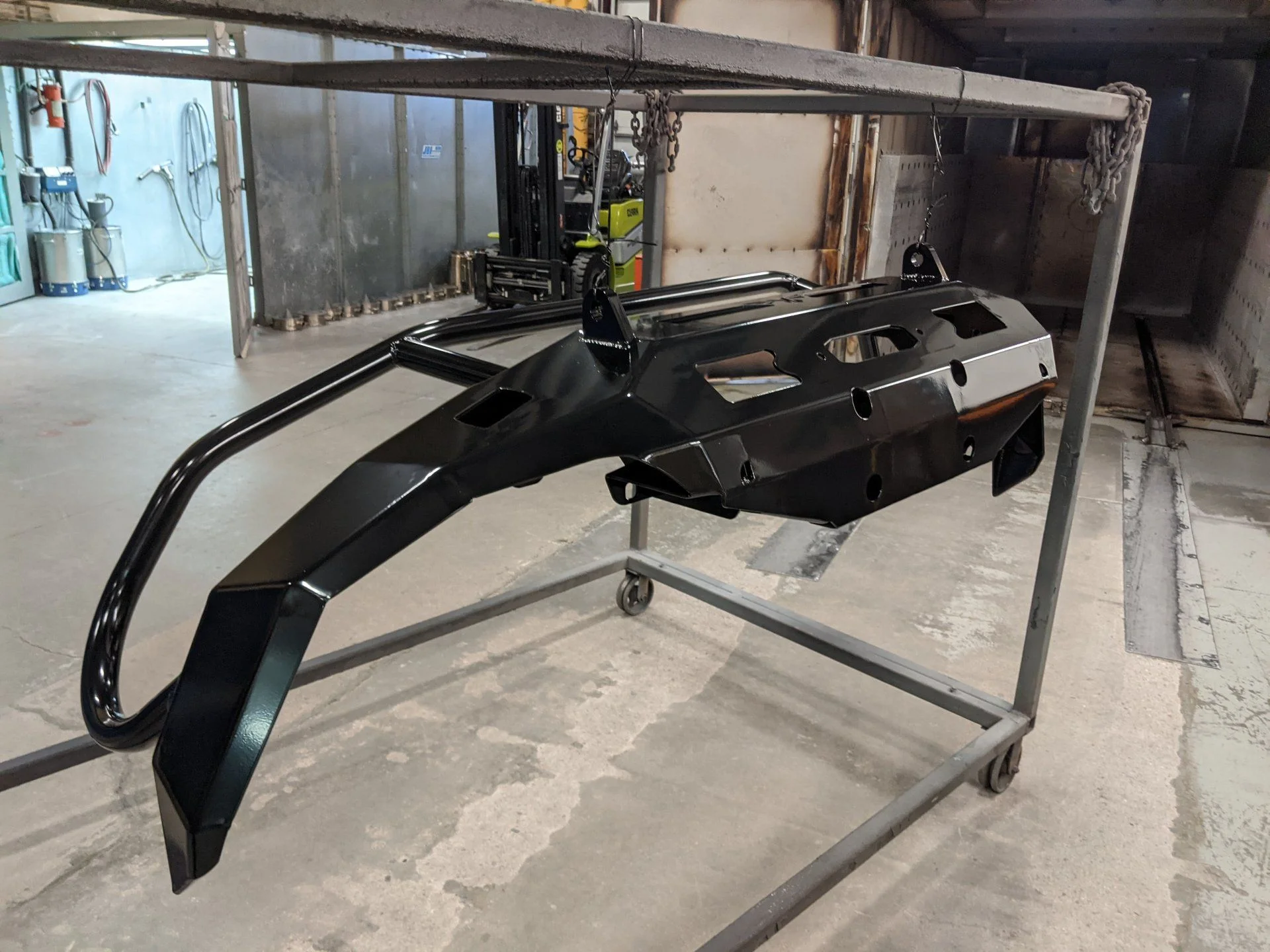

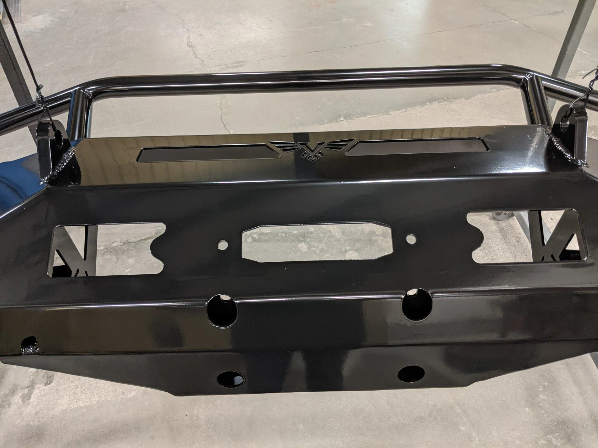

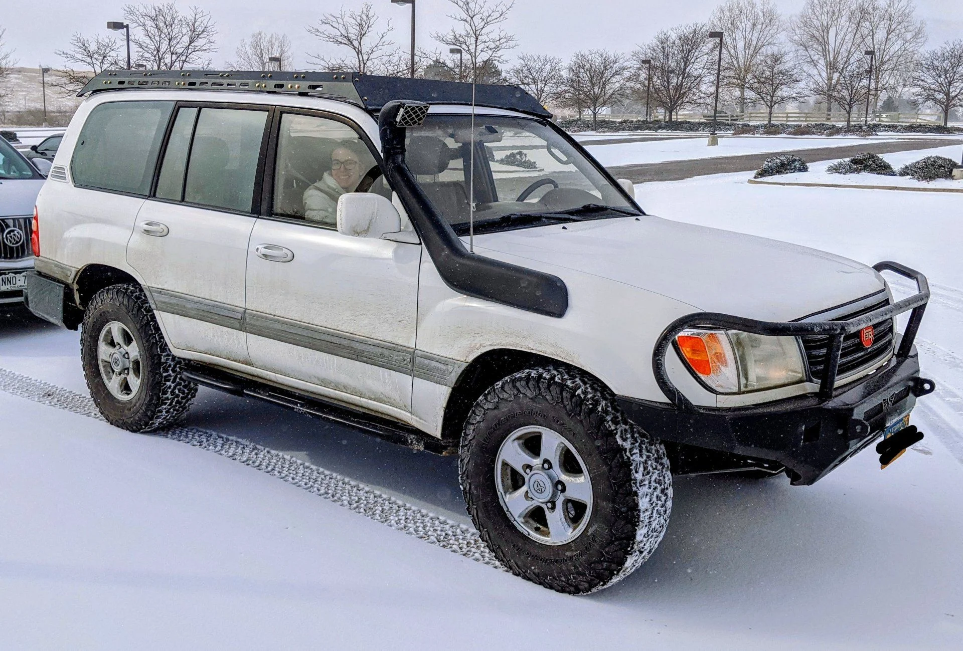

Installed my @Victory 4x4 front and rear bumpers this weekend. The front bumper was easy to install but we ran into numerous frustrating issues with the rear bumper. I am emailing Victory today to see how they will help resolve the issues (detailed in next post). I will update the posts as I work with Victory. Their response will definitely be a factor in my comfort of recommending their products.

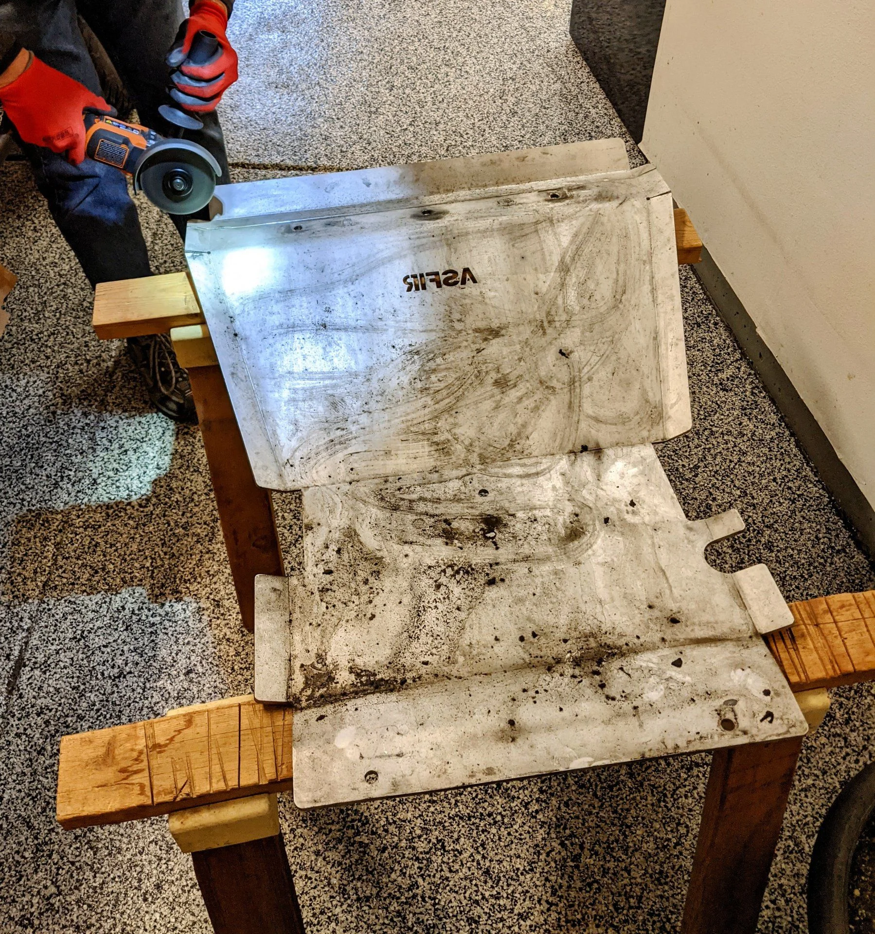

We had to cut a few inches from my Asfir skid plate to accommodate the new front bumper. A few minutes with the grinder and we were all set.

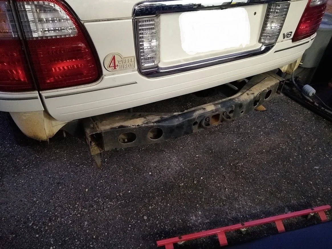

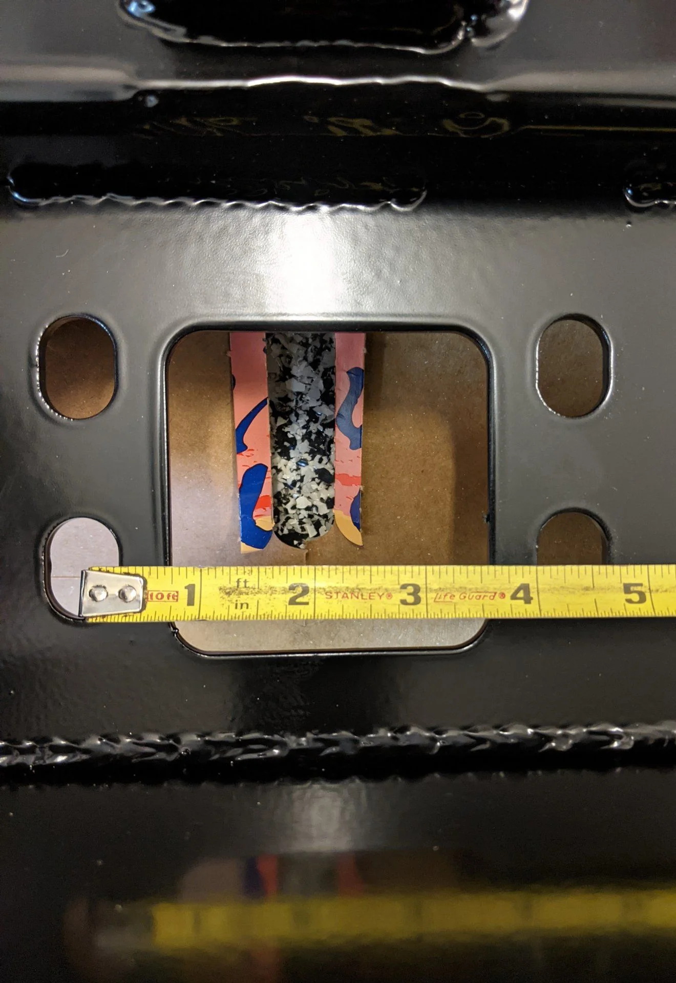

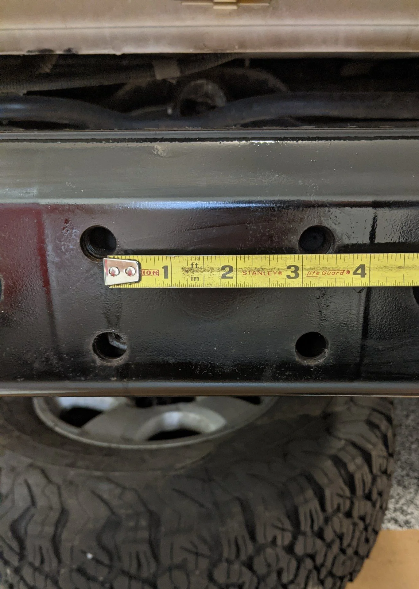

I had three issues (of varying severity) with the @Victory 4x4 rear bumper install:
1) Some key bolts that go into the back frame rail cannot be installed due to the bumper access holes being the wrong measurement. This is HUGE deal to me as I plan to tow a trailer with this and don't feel comfortable without this being resolved.

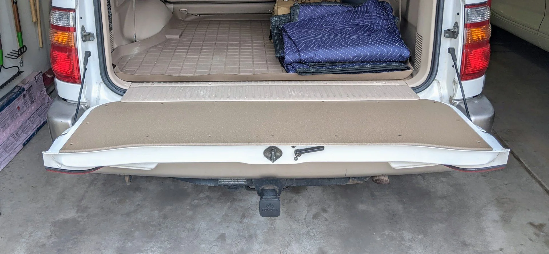

100 Frame
Victory Rear Bumper
Bumper Installed Showing Misaligned Holes
(Pic coming soon)

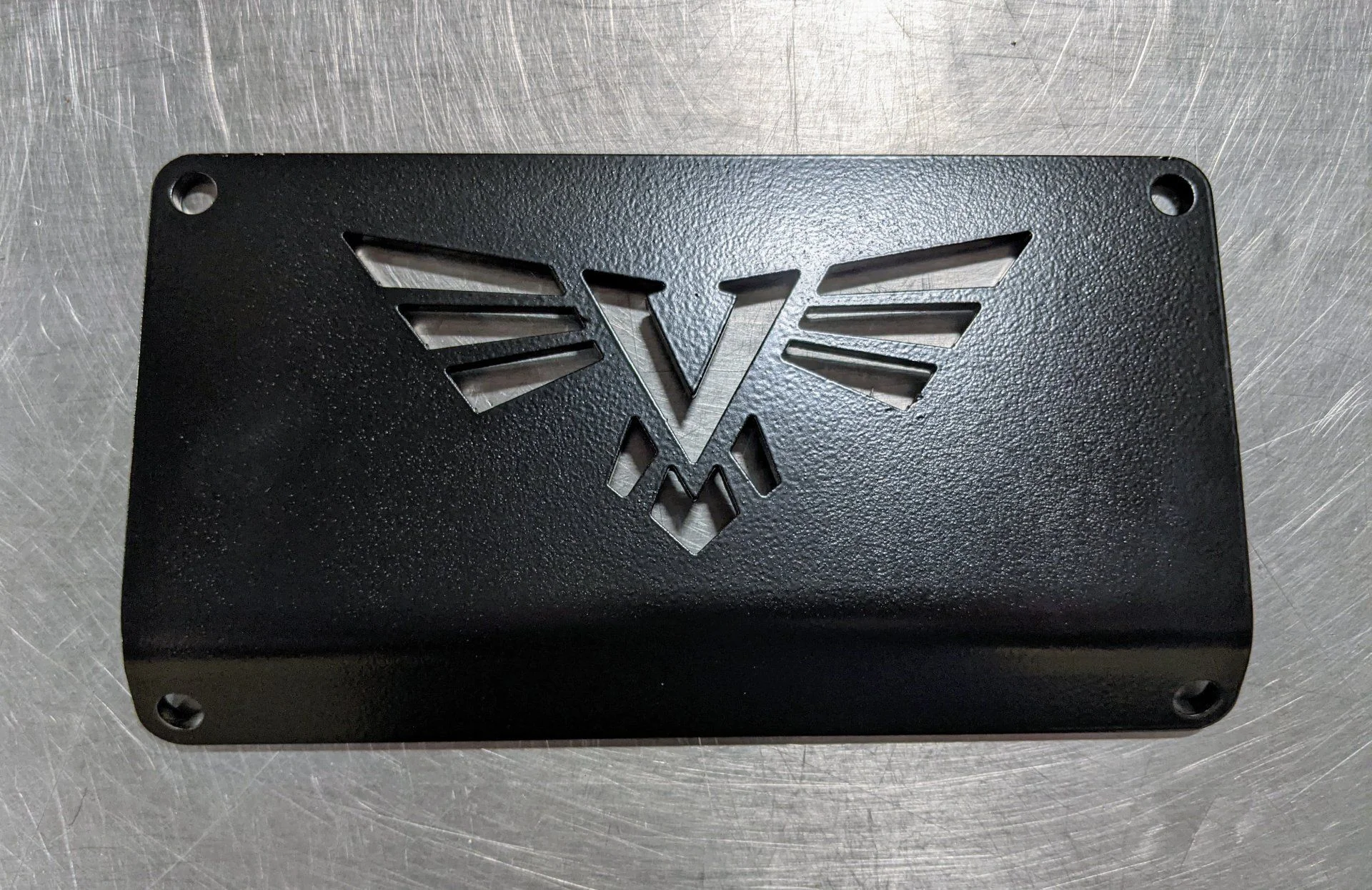

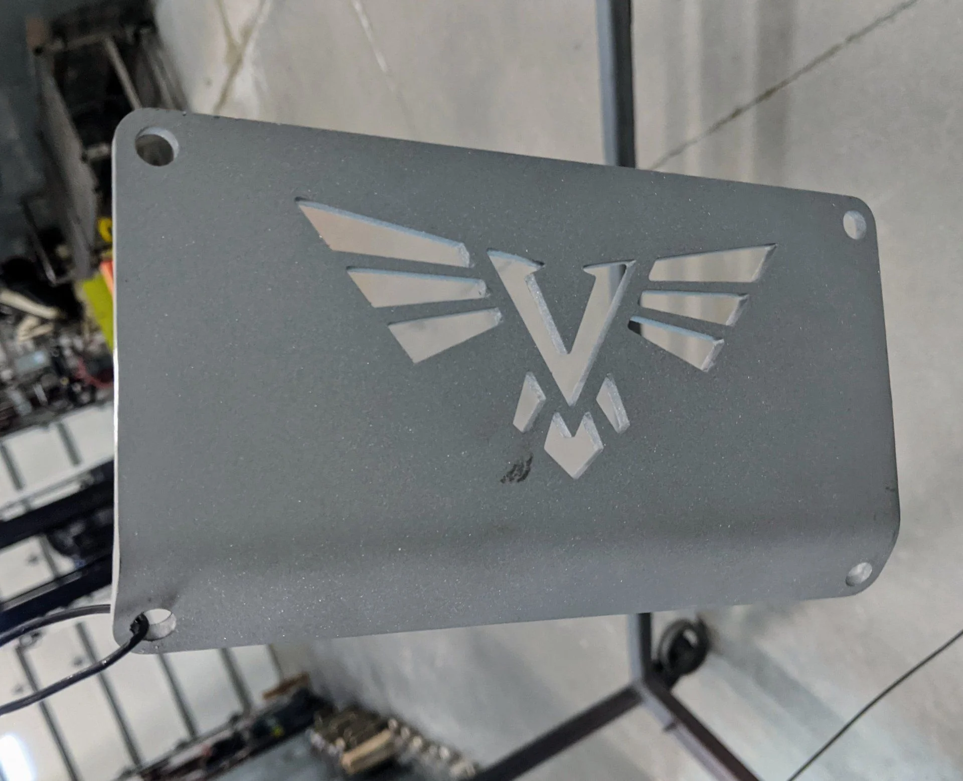

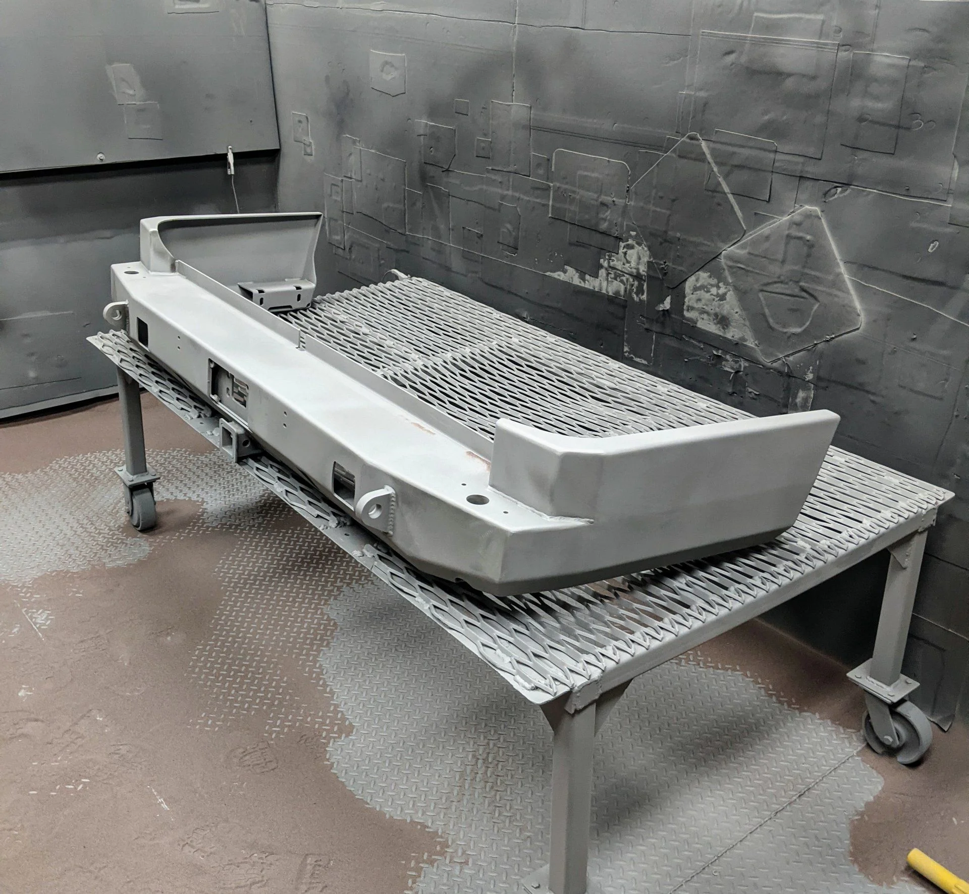

2) Back plate to cover rear bolts does not fit and can't be installed; some material will need to come off of the left side to make it work; I could grind it down myself but I'd prefer Victory send me one that actually fits; unfortunately, I powder coated it myself and I'm sure their coating won't match exactly.
I have had another Mud member PM me with the exact same issue on his bumper.
3) My package was missing a few bolts necessary for attaching the side support pieces to the bumper wings. This was just annoying and I expect Victory to send me some so I can complete that part of the install.
Overall, I LOVE the look of these bumpers. I am super excited about them. However, I am definitely frustrated by the above issues. I hope Victory makes it right so I can feel good about recommending their products going forward because I think their designs are incredible.
Update:
I have been working with Victory over the last month to address this issue with the rear bumper. Victory has been very responsive and offered to make me a completely new bumper. In the end, I asked them to provide a load plate that will sit on top of the misaligned holes of the first bumper they sent so I can drill through the original plate to make the factory holes accessible, then sandwich the load plate and original plate section into the factory holes. I have not yet done this but will soon. Victory is also providing me some additional products to make up for the inconvenience. In the end, I am still frustrated by the situation but do sincerely appreciate Victory's response.
the misaligned holes are probably due to the difference in the spacing of those four holes in the rear frame between the models with the rear frame mounted hitch (and the square hole cut into the frame) and those without it. The dissent rear bumper I just installed had slots for the fitment of the two different patterns instead of round holes. Would you be able to slot the holes?
(pic is my 04LX with the factory plastic bumper removed with the hitch adapter still bolted on)
Yeah, this definitely seems to be the issue. I am working with Victory to determine if modifications can be made or if a new bumper is needed. They are offering a replacement to a new revised version so that shows their commitment to making it right. I'll keep updating here as I make progress with them.

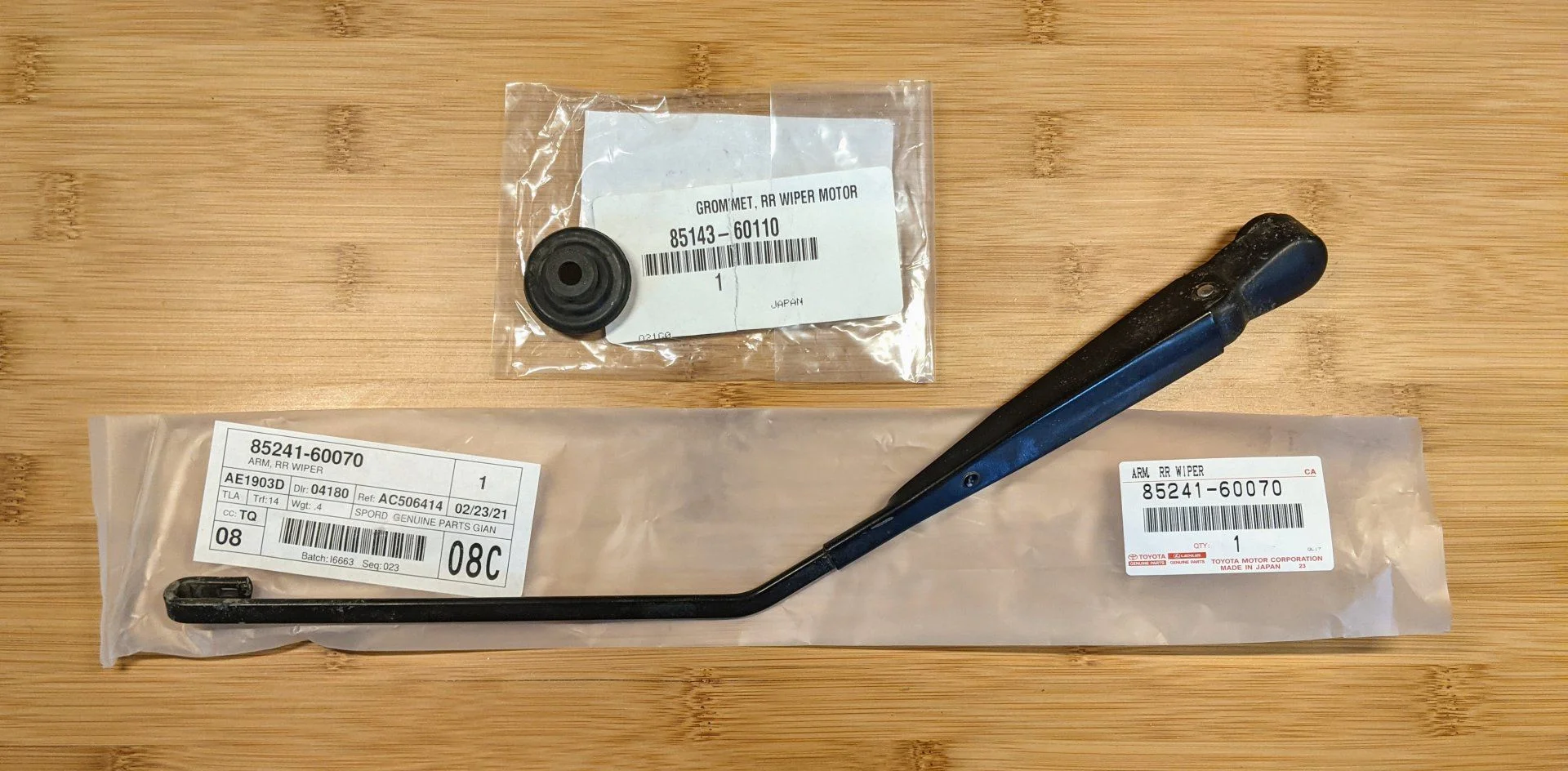

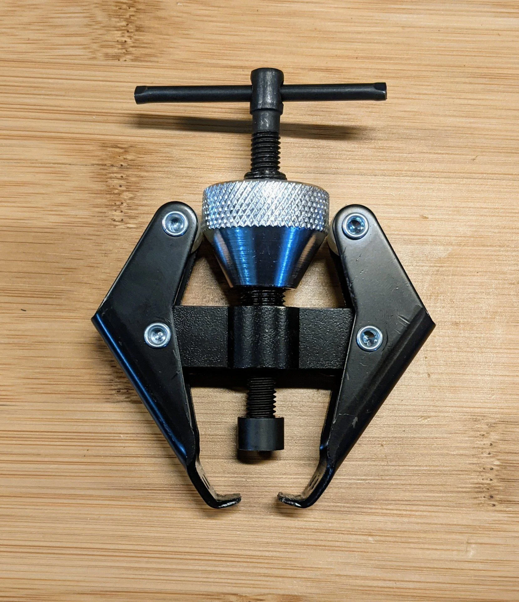

After 278,000 miles, my rear windshield wiper arm wasn't cleaning the glass properly. The spring wasn't providing enough tension so I decided to simply replace the whole arm. I also replaced the rubber grommet while I was at it.
Parts (old ones shown)
Wiper Arm: 85241-60070
Grommet: 85143-60110
This wiper arm puller I picked up on Amazon was well worth the $13.
Amazon product ASIN B076PY8785
Did that fix the issue? I just put a new wiper blade on mine and it’s still not getting the top of the arc squeegeed. Thanks for the pro tip with the wiper arm puller, might come in handy.
Funny you should ask that. It is way better than before (the wiper used to get pushed out by the widest part of the glass and be unable to return to it's resting place against the glass - now fixed) but it does seem to still miss cleaning the top inch or two.
I haven't used it beyond a quick garage test so I'll get a better feel for it over the next week.
After nearly 4 years and hundreds of hours of work, I am putting the 100 up for sale. Listing located here.
I just picked up a 200 and I've only got space for one cruiser at a time. I learned that lesson with the 80 and 100 competing for garage space and, more importantly, my time.
