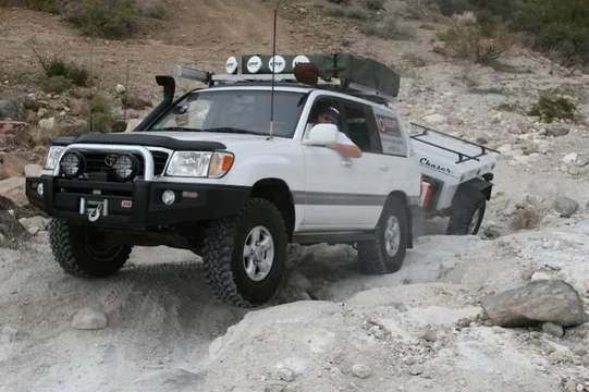

You're going to need an RTT
But seriously, for dirt roads, I would say this as a minimum.
