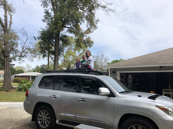

Do you have any pictures of your LX with the ARB rack on prior to mounting up the awning and lights? I'm trying to decide between the ARB flat rack mentioned here and the Rhino Rack or Prinsu.
Only one I got - it's family approved. I'll snag some pics of the mounts this evening

Does your rack whistle at all?
I notice you did not install the front wind defector, and I think that defector is making mine whistle a little?
Yeah, that thing was horrible. Forced air down onto the sunroof and made noise. Without it, rack was relatively quiet. I built a fairing (on my hood in the above pic) that I use for long trips.
Thanks .. I'm going to take it off.

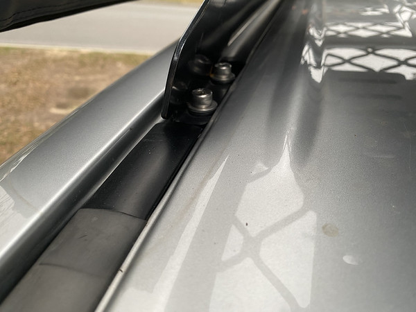

Thanks for the feedback. Would you mind posting a pic of your rack, especially the supports? The pics on ARB's website don't show the supports very well. I'm curious if it's supported by individual legs as opposed to a rail like many of the other racks.
Here’s the support - for mine there are 4 mounting areas on each side.
