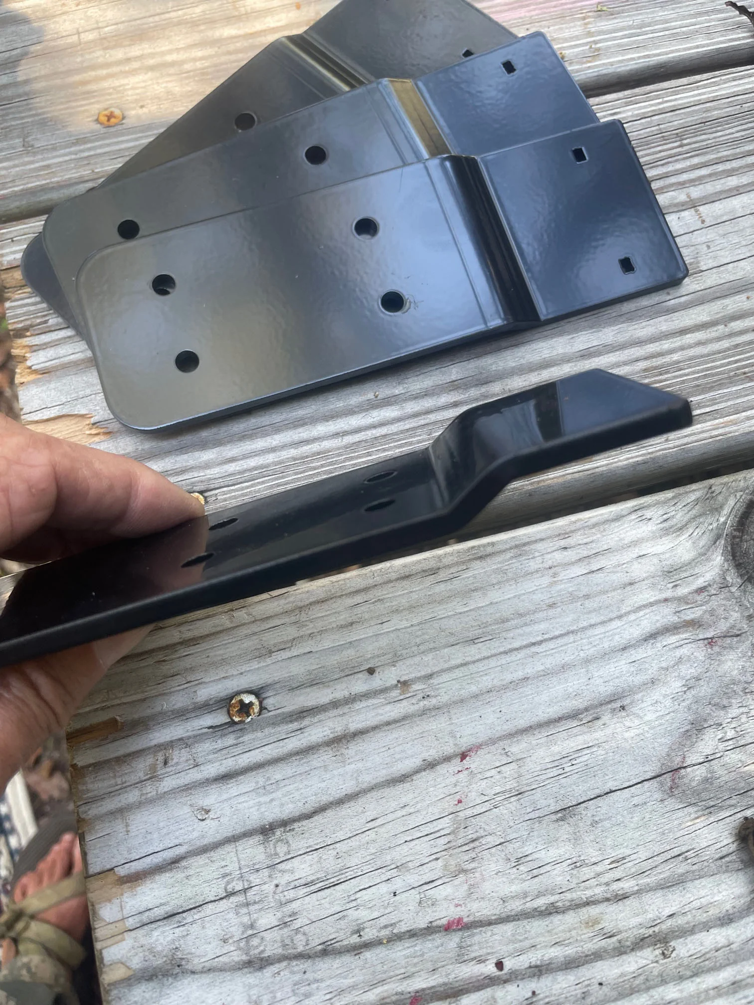

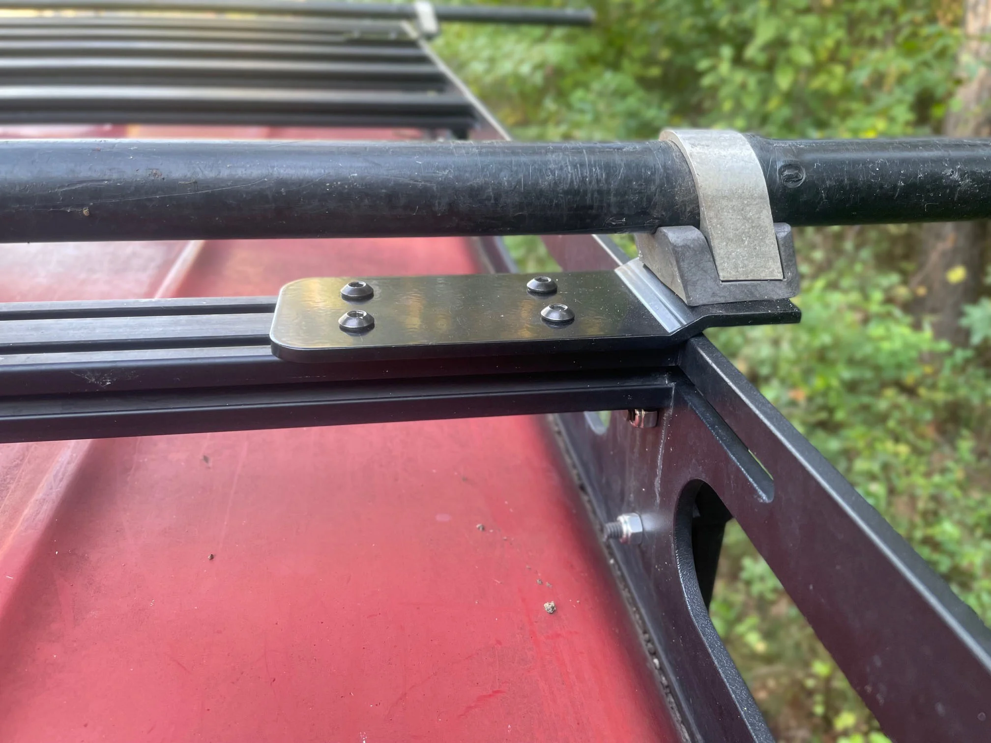

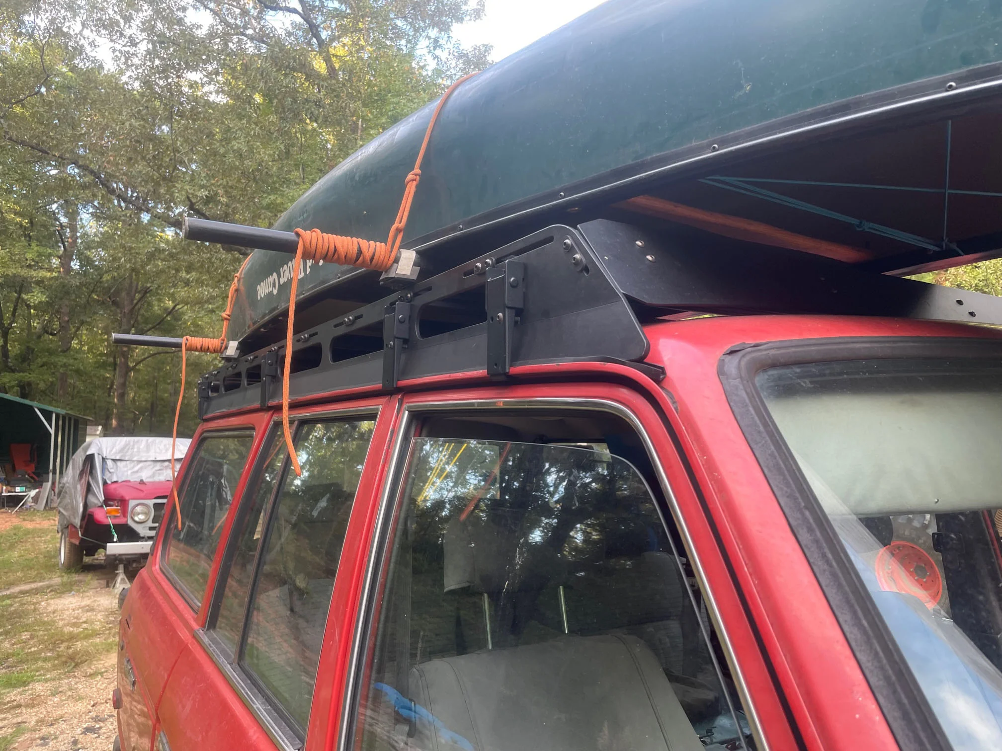

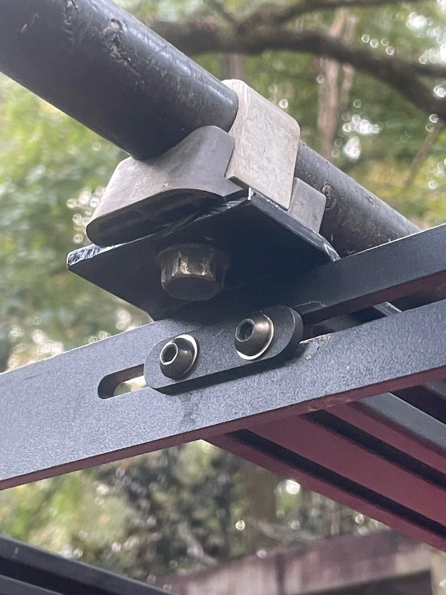

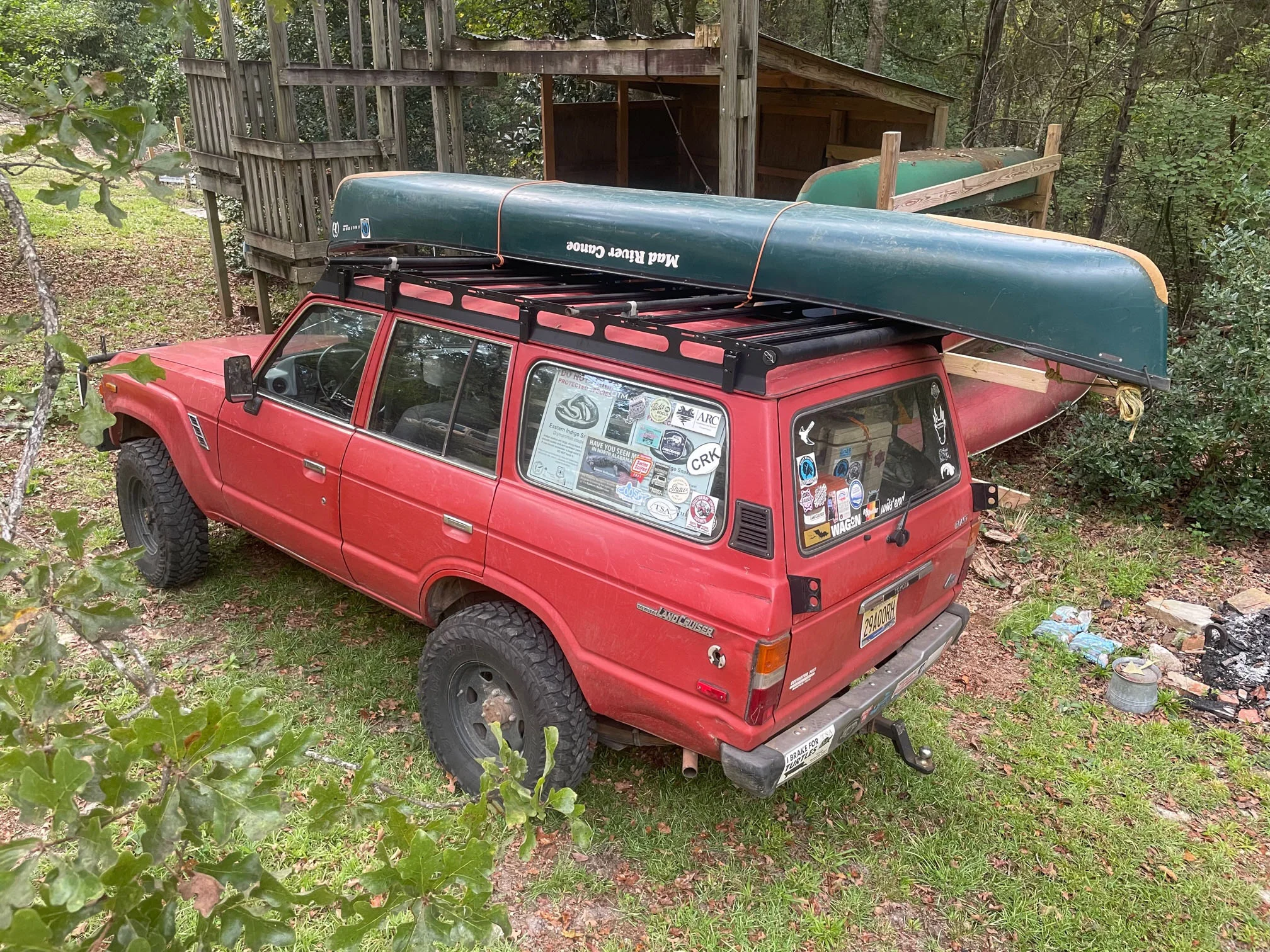

I've set up something on the Bowfin, similar to the Prinsu, for mounting Yakima bars. I used the horizontal plates that form the base for awnings and drilled to mount the Yakima mounts. A few photos showing the setup on my 60 to give you some ideas.
Beautiful truck and great solution.
Question: What kind of mounts are those tho? I can't find anything like it on the Yakima site...
Is the plate specific to bowfin? Looks like maybe you drilled out a hole for the mount bolt?
The mounts are the top portion of a 1A raingutter mount 1A Raingutter System - https://yakima.com/products/1a-raingutter-system
I don't know if the plate if specific to Bowfin. Awning Bracket Mount Set - https://www.bowfincruisers.com/products/awning-bracket When I had the idea for this mount I contacted Patrick with Bowfin and asked if only the horizontal plates were available and I received a set. I did have to drill the hole for mounting the Yakima components.
This is the answer! Thanks much Jim.
