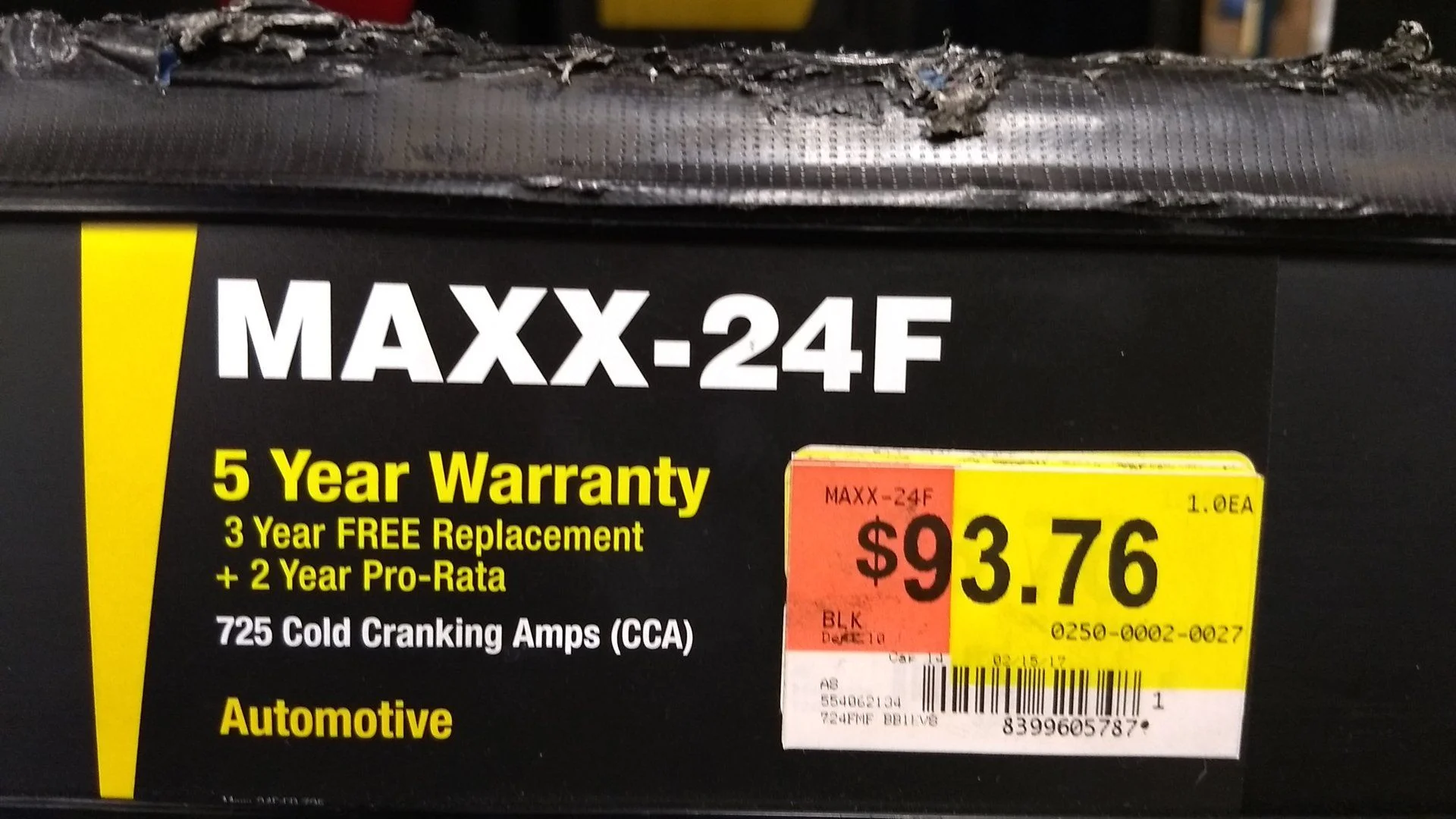

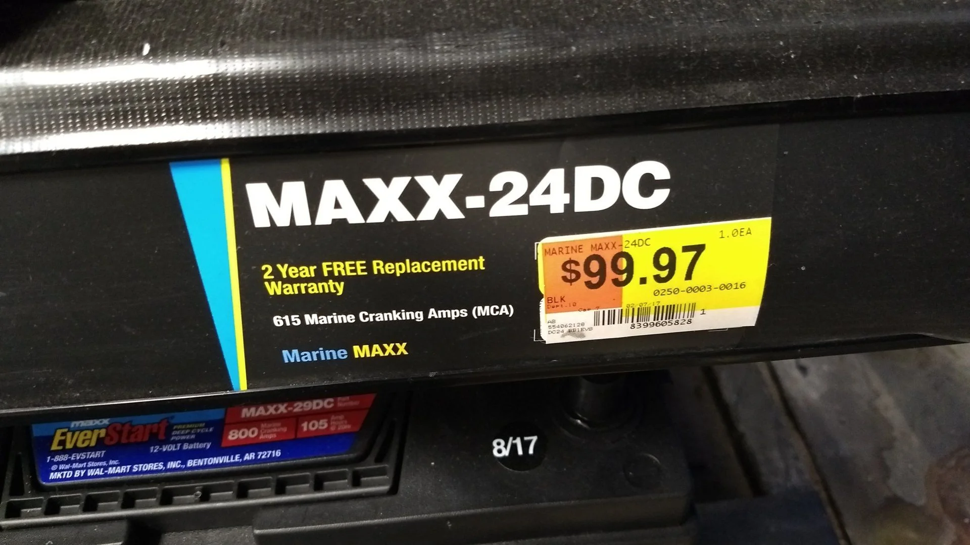

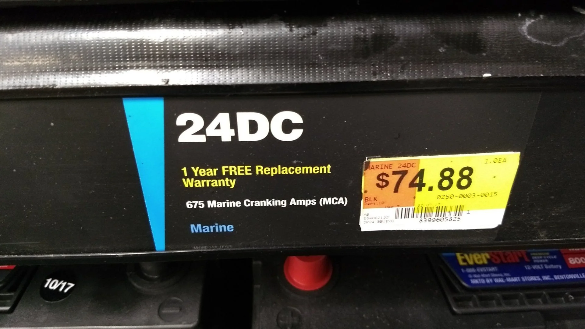

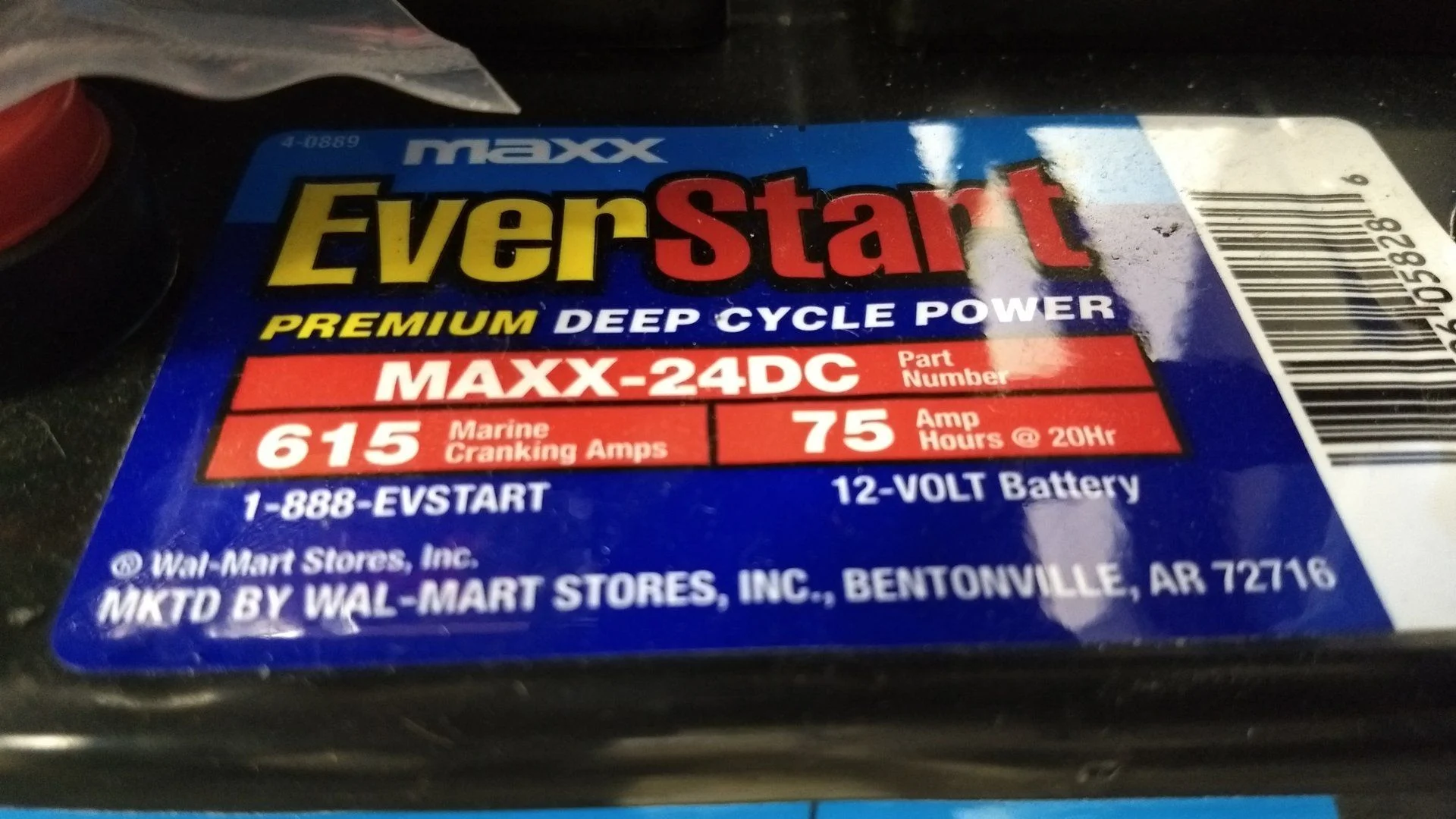

Three choices at WalMart that are "cheap". Maxx has better specs and 2 yr warranty) than the "regular" 24DC with a 1 year warranty. The 24F has a 5 year (3+2) warranty.
Given the portable battery box use of this and very occasional use... I'm soliciting opinions.
MAXX 24DC:
24DC:
24F:
I have come to see little magic in batteries. I'm running a MAXX deep cycle in my 80 in the #2 position and it's been fine. Buy with confidence.
Recently though, I've been using East Penn flooded lead acid batteries you can buy at batteries plus. They are very high quality flooded batteries, not expensive and perfect for our uses.
But the critical feature in keeping batteries in good shape, is to keep them charged 100%. I have several Costco Kirkland 3 year batteries that are 5-6 years old and still good, because all of mine are plugged into a batteryMinder every night. It makes a huge difference and batteries age at a much slower rate when they are always 100% charged. You do need to check and add distilled water every 3 months or so, but it makes your batteries nearly immortal.
Just keep in mind that batteries are a consumable. They all go bad in time. So spending 3x as much for a battery that does the same job 10% longer doesn't make any sense to me. Get a battery in the $100 range with the best warranty, take care of it, and that's about the best you'll do.
