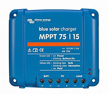

I've decided to step up to an MPPT charge controller. My old PWM one is only about a year or two old and is doing an excellent job AFAIK, but for the price, and the fact that it's designed in the Netherlands and built in India as opposed to being another rebranded Chinese unit, I went for it to complement my new fancy power tilt! LOL
Lets see how many amps we can get out of the sky now!
I tell ya the sun won't know what hit it.
Rather than ramble on let me just post up the links and you can check out it's awesomeness yourselves.
Victron BlueSolar 75/15
Amazon.com: Victron BlueSolar 75/15 MPPT Charge Controller - 15 Amps / 75 Volts: Electronics
And all the many things you can do with it through your phone:
BlueSolar MPPT 75/10, 75/15 & 100/15 (12 / 24 Volt + load output) - Victron Energy
I know there are other units you can control charge voltage, charge amps, temp compensation, etc, and keep a statistical log for 30 days with, but not I think for $99.

I read through the manual and it says the absorption voltage is adjustable, but it doesn't say how. Is this possible, and does the software explains how?
Yes, you can adjust from the app side in Settings. Or leave on Auto to default to any one of 7 pin settings via a rotary dial on the controller. #7 is what I'm using (LiFePO4 algorythm).
One thing to note is that all the remote options are not available on the smaller units (I assumed as much) but the important stuff IS included, like a 30 day history record and best of all the adjustable charge voltages. I saw one once that was adjustable but then only turned out to be adjustable downward in voltage, not up. This I'm glad to say goes both up and down.

So if you adjust up the absorption voltage a bit and then unplug the dongle, does it stay at the new higher voltage you specified or does it default to 14.4?
Must be cool in Reno today @spressomon as your panels are close to spec!
Stays.
