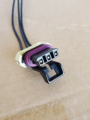

The connector you need is Automotive Connectors CON MP 150 3W FEM ASY (Fully Assembled); got mine on e-bay. View attachment 3767430
I wired the provided ARB switch under the hood and installed on the Slee tray. No problems, good location and access. I did wired a parallel trigger wire through the firewall to turn the compressor on, but didn't use it. I also have the AirLift wireless controller wired in and mounted under the hood for the rear air bags.
Thanks I owe you a beer. Ordered, I’m going to do this to keep the wiring clean
Bonus points if anyone knows where to get that 3-pin waterproof fitting used in harness #2 (second photo) so that I can just create a new one rather than cutting this one (even though I'll likely never use the ARB harness).
Those connectors are Delphi Metric-Pack connectors. The 3-pin is a 150 and the 5-pin is a 280 size.
Try CustomConnectorKits.com. They are not hard to crimp and wire up oneself, then you don't have splices from using store bought units with pigtails.
