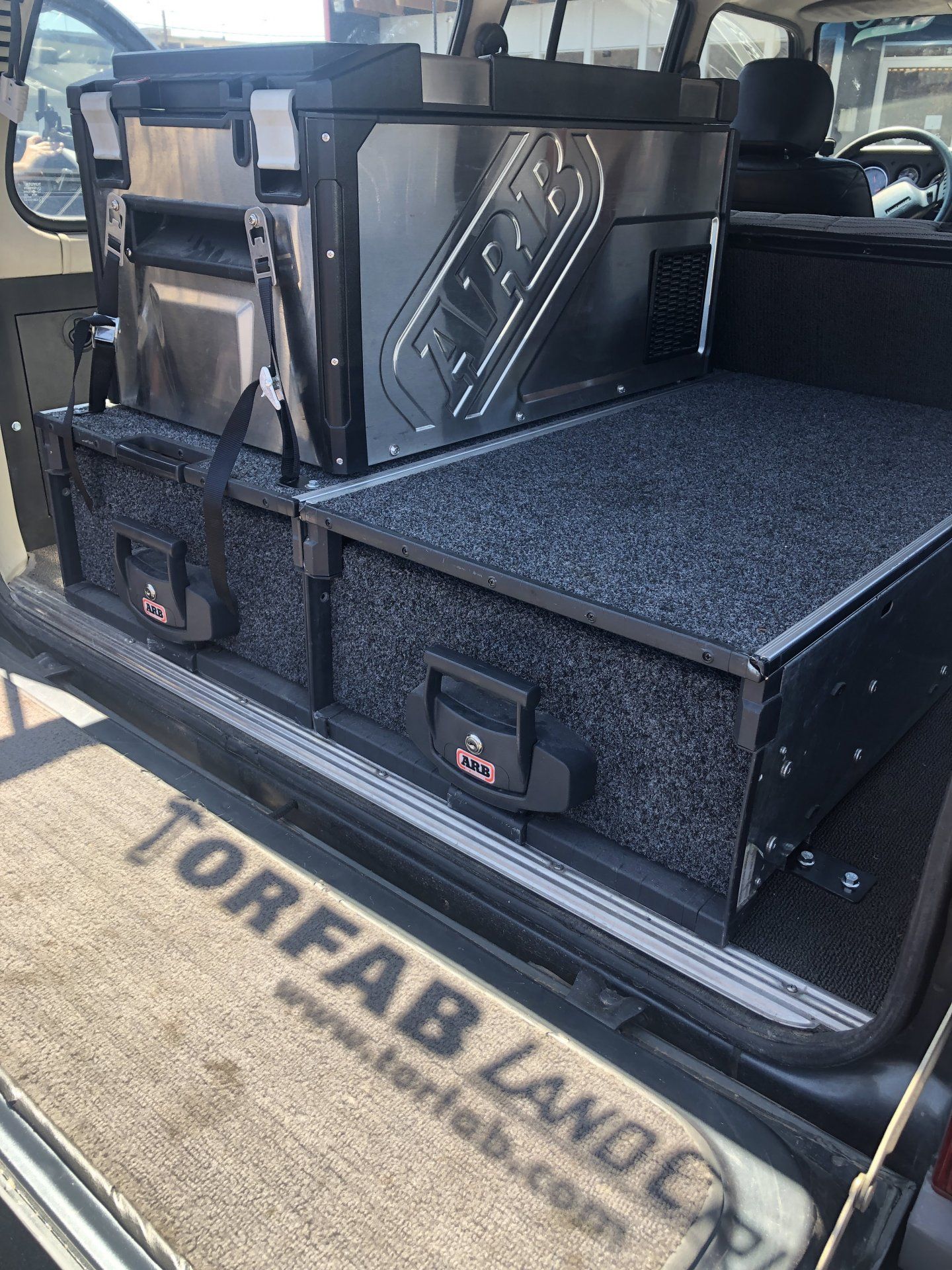

Yea, they're a pain in the A$$ to install. We don't drill holes in sheetmetal as a rule in any of our projects, but the drawers are the exception to that rule. We attach them at the middle, and then install a tie down on the outside aft corners and the front corners to hold them down. Those attachments points will keep you away from the fuel tank placement for the most part. Keep in mind that you want them fairly secured, because they'll give you a BIG headache in case of a car accident.

The dobinsons have the wings, which make them ideal in a 60. I didn't install any with my ARB drawers, just squeezed them in between the wheel arches. I had to do the same with a mallet with these also, they're just a literal hair too wide but with some creative hammer swings I made them fit.

Those are RDRF1045 and RD1045 from ARB
