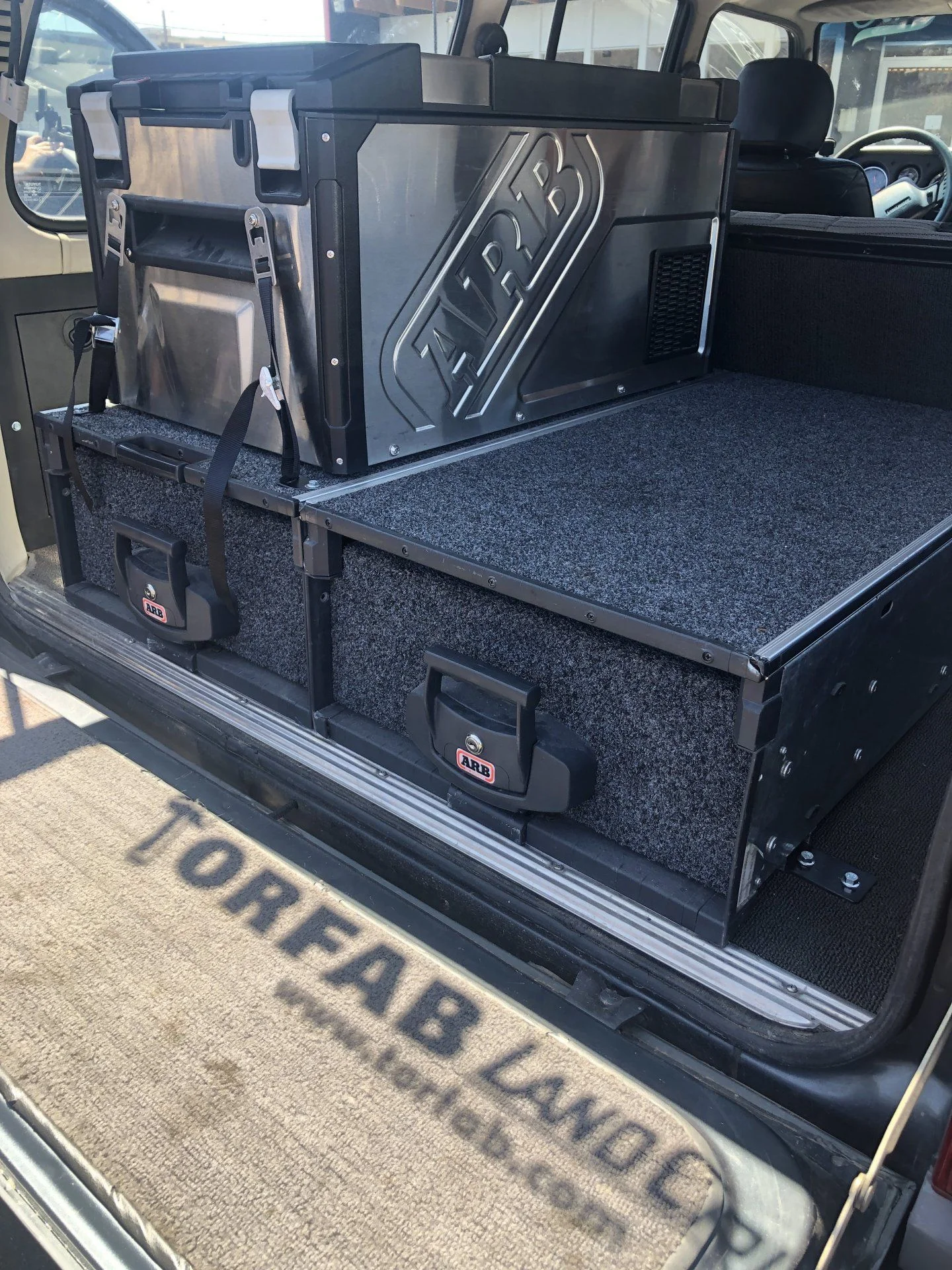

I think @torfab may have squeezed a set into a 60?

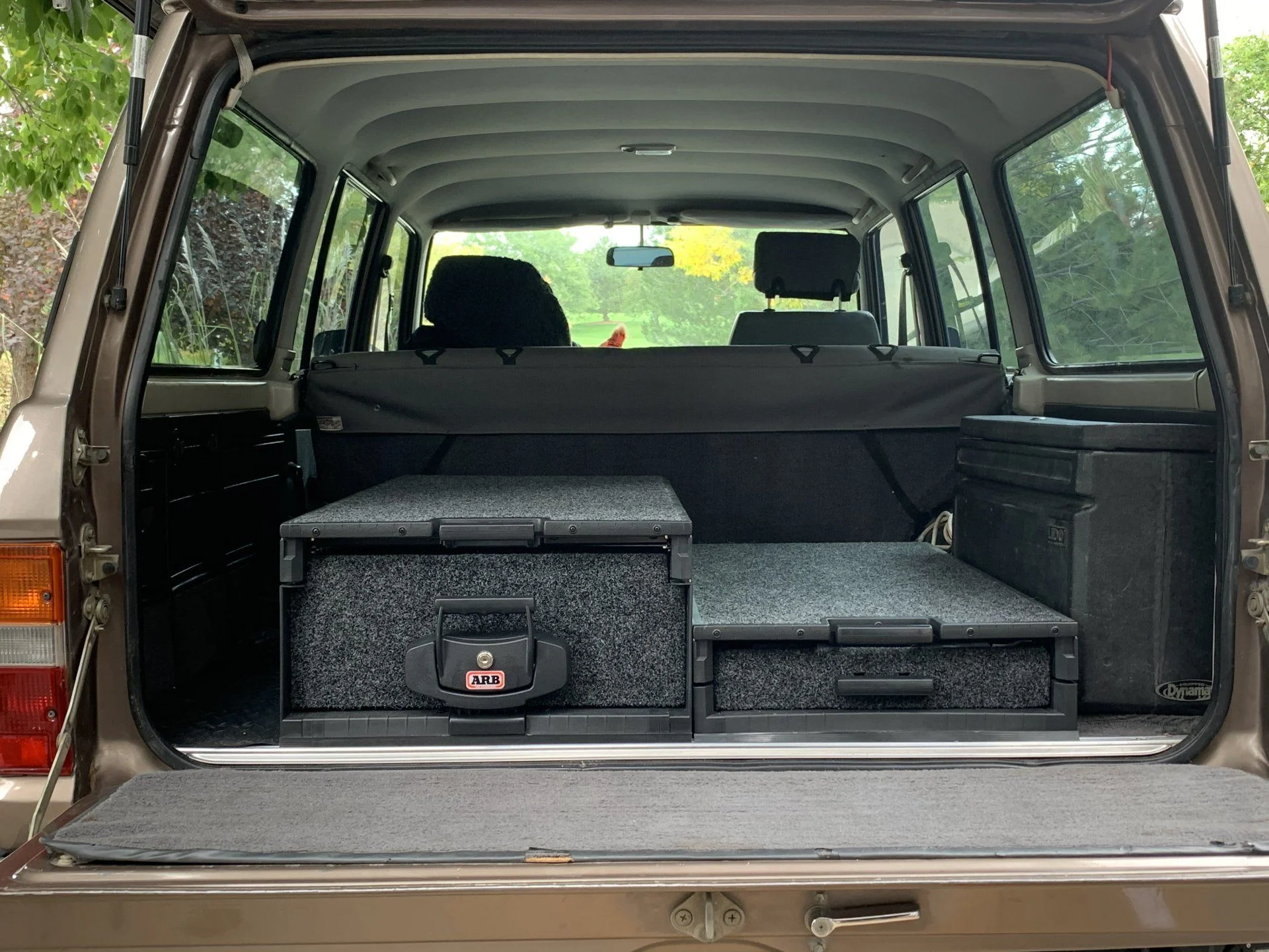

I went with another dobbins.
Wow. That is nice !
What size are those ?
so i found that brand on Amazon..they did not appear to make on for the 60. I contacted the company and asked them about buying one that fit another vehicle and then cutting it down to fit. He sent me the pics of a set a guy did for his 60 and ordered them with the universal wings and cut them down to fit. The drawers are just a hair too wide to fit between the wheel wells...and when I say a hair, I mean if you didn't have them covered you could probably squeeze them in....I actually took a large mallet and hit both sides down low to push them in going back about 8 inches and it fit tight. I actually like the fact that it fits tight. I cut the wings down to fit so you you actually have an additional place to store things as that round circle on top is a latch you turn to lift the top of the wing to access the sides. The center drawers are very nice, heavy and lock. I have ordered some tie downs that you would mount on the bottom of a truck bed and will used those to tie the system down so it doesnt bounce around....It would only do that with a very hard bump, but to be safe you need to tie them down.
The cost- the guys sold them to me for $1200 delivered. Would of been a few hundred more if I would of just ordered them without talking to him. It was a couple years ago...let me dig up his contact info.

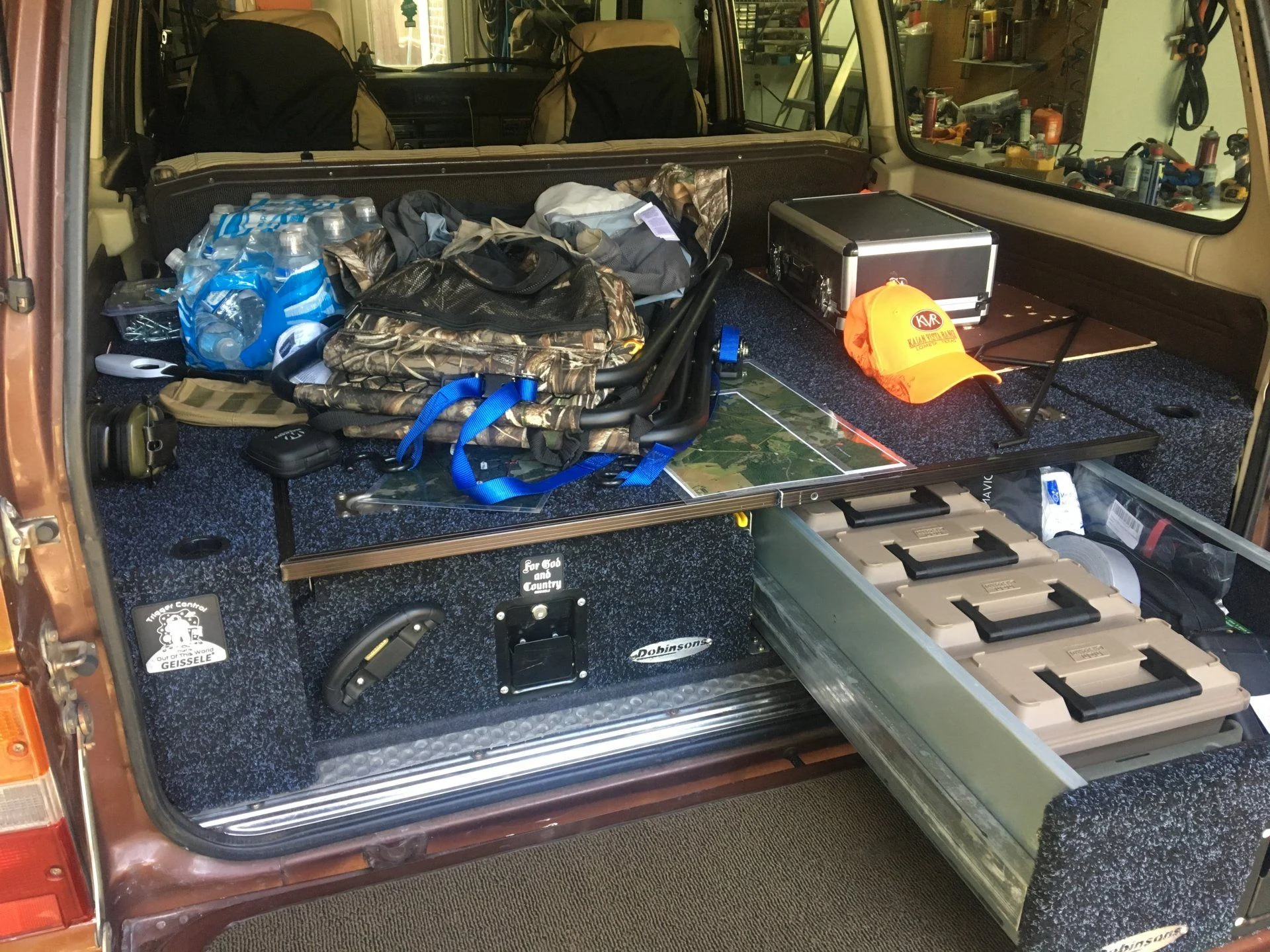

The dobinsons have the wings, which make them ideal in a 60. I didn't install any with my ARB drawers, just squeezed them in between the wheel arches. I had to do the same with a mallet with these also, they're just a literal hair too wide but with some creative hammer swings I made them fit.
thanks for posting that and great to know. (don't you just love that Elements Fridge?) I have another storage box for behind the rear wheel well (old school got it from scepter like 20 years ago). it's just another hair wider than the wheel well. I went with the 1045 drawer and 945 roller floor. that gives me about an inch to mess with.
