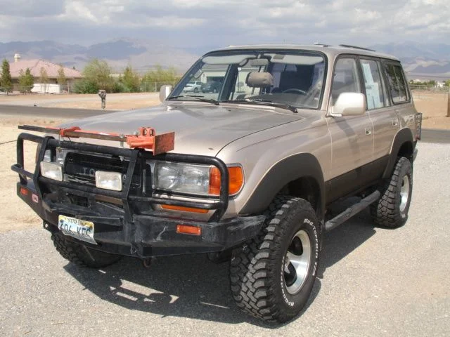

The reason why I said what I said was because as you can see I had an ABR bumper on my fj80, One day I was making a right turn out onto a Major Street, not paying attention there was a car came whipping in the lane that I was turning into and I hit him hard !!! between his rear tire and the rear bumper ,through the bumper into the other lane and car parts all over the place . He just kept on going so I stayed, call the police to get a report written because I didn’t wanna to be charged with leaving the scene , The cop and I were a picking up car parts out of two lanes on the street that I hit them on ,he said even though is was my fault don’t worry about it because he left the scene and it was probably a stolen vehicle or he was drunk or he didn’t have a drivers license . Then he spent the next half an hour just googling over my LC, he was amazed that there was no body damage. So I have nothing but praise for the ABR Bull Bar. And I really wanted to buy another one for this 100 that I just picked up but if I have to worry about crumple zones and airbags , I may have to rethink ARB this time. I will admit back in 92 when I bought the 92 there wasn’t really a lot of off-road accessories for the Land Cruiser back then ,it’s not what it’s like now . I wish we had all these accessory manufacturers back then that we have now .”we’re so spoiled and lucky now “. ..

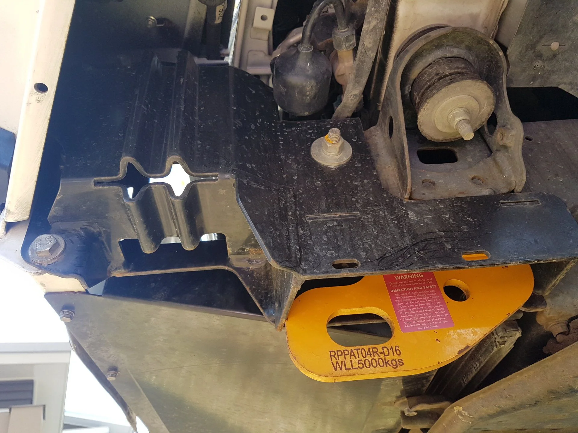

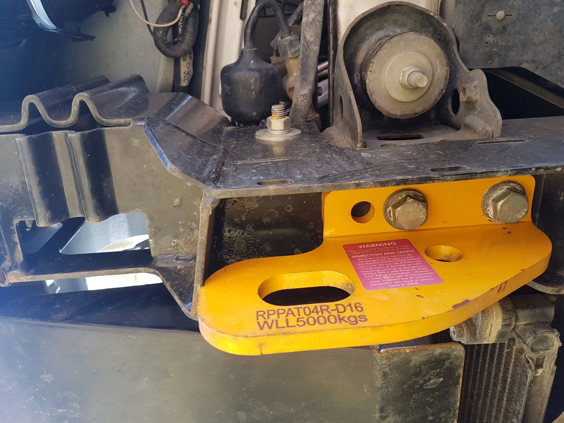

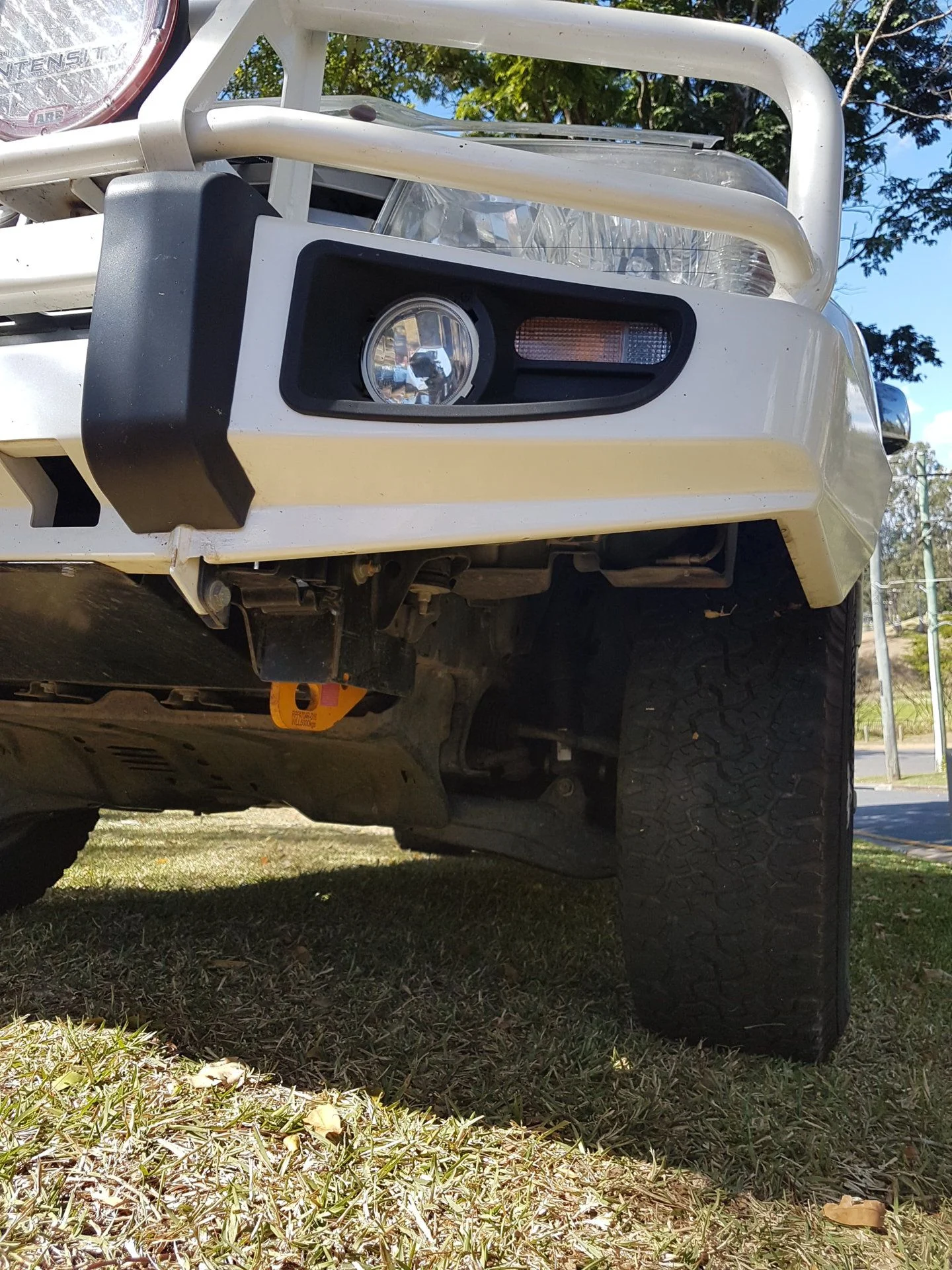

If it helps, the pics below show how a steel ARB Deluxe Bar (Stock Code 3413190) is attached to a June 2006 HDJ100R with IFS and airbags for driver (in steering wheel) and passenger (in dashboard). The Bar was fitted by ARC in March 2015. This Bar has a built-in ARB winch plate ready to accept a winch installation when and if required.
The slot for the tongue of a Hi-Lift jack does exist and can be used next to each black bumper strip on both sides of the ARB Deluxe Bar.
As far as I know, ARB has never designed or supplied ARB-brand recovery points for HDJ100R with IFS and airbags, nor endorsed any other supplier. Obviously, attaching snatch straps or tow rope etc directly to the Deluxe Bar would not be a good idea because of the possibility of twisting and distortion of the mountings. Although not endorsed, some non-ARB recovery or tow points do fit, as shown in the pictures further below. Details of one Australian supplier are shown at the link:
Roadsafe Automotive Products, Aftermarket Automotive Products, roadsafe suspension
The recovery points are fitted as shown in the pictures below with high tensile bolts passing through ARB bracket and anchoring in existing holes directly into RH Front and LH Front chassis rails. This means that the forces involved in recovery operations are passed directly to the vehicle chassis rails, not the ARB Deluxe Bar. Each tow point has shows a Working Load Limit (WLL) of 5,000kg (5 metric tonnes). In recovery or towing operations both recovery points must be used together with a connecting bridle between RH recovery point and LH recovery point to maximise load distribution, minimise chassis twisting.
