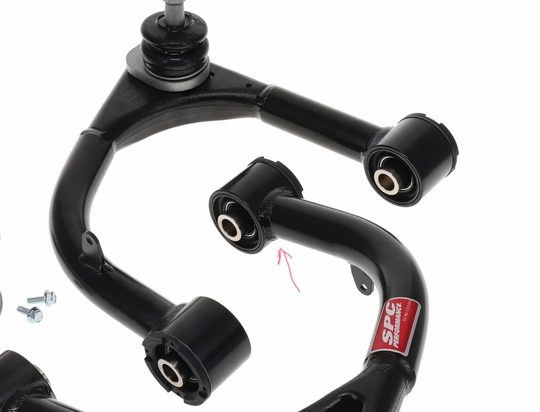

That said I saw firsthand an SPC arm break at the weld to the frame recently, so I’m pretty inclined to dump them after seeing that.
FWIW the SPC UCAs for the GX460 are single castings, I don't think there are any welds.
I didn’t think there were any welds either but the one i saw break clearly had 4 tack welds and SPC had failed to properly weld the seam. I’m shocked it had lasted ~5 years. But having watched a front wheel collapse from that break, and then with the fairly recent ball joint recall their QC just seems awful.

I wish I had taken pictures of that blown up UCA. I agree the “pealed” bushing casing looked like it had only been tack welded to the UCA. I’ve inspected mine to make sure the welds go all the way around and don’t see any cracks.
@Oakleyguy, was there a 360 deg weld beacon the arm tube? Like this:

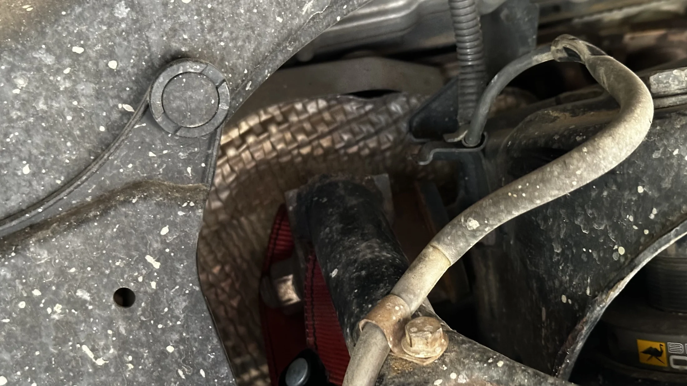

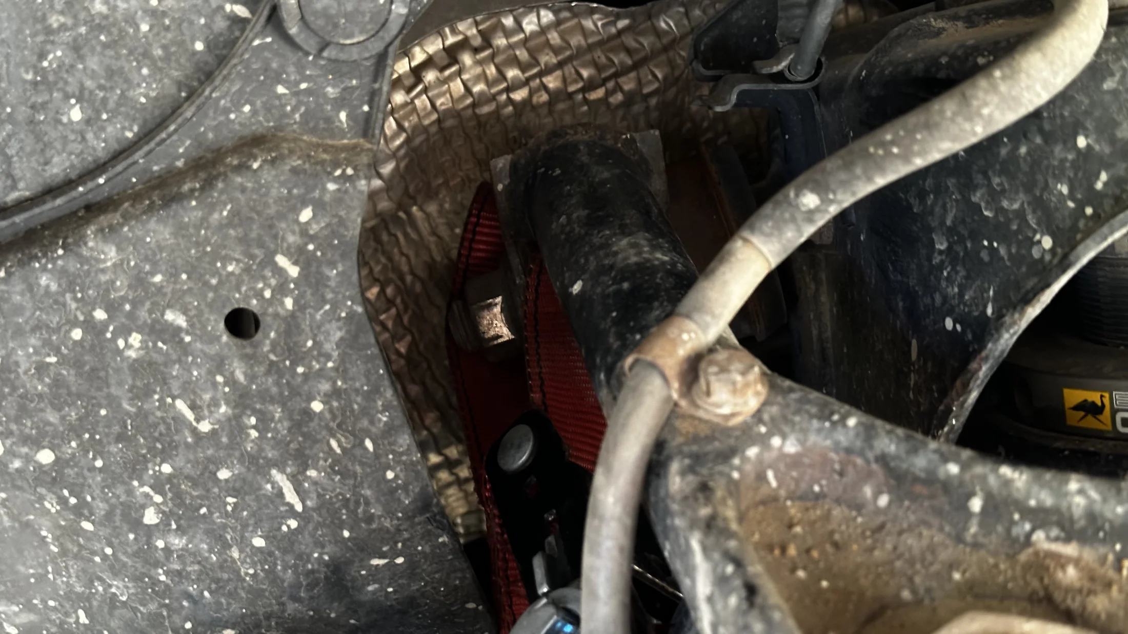

Not the best photo but the one I had handy on my iPhone. Gabe got a better shot with the Nikon but I haven’t published it yet.
The red line is my ratchet strap, being used to help pull the arm back towards the mount, as it had flipped forward
