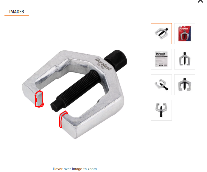

I vaguely remember that it was a pain to remove and wished I ordered new bridges. I think I modified an Autozone pitman arm puller to separate the bridge form the ball joint. I cut the teeth back a little to get over the bridge.
I vaguely remember that it was a pain to remove and wished I ordered new bridges. I think I modified an Autozone pitman arm puller to separate the bridge form the ball joint. I cut the teeth back a little to get over the bridge. View attachment 3893721
I considered new bridges but they would be over $100 each.. hard to justify that.
Good tip on the pitman arm puller.. it works so well for the UBJ I could get another and have it ready to chop up to fit.
