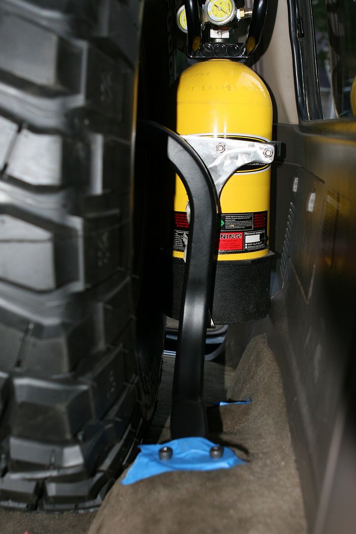

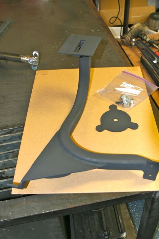

You all have probably seen our spare tire carrier. Best of both worlds, hub mounted and strapped. 2X the security and safety. And it butts right up to the fender well.

One attachment point, hub mount.
Tire's entire weight is left to bounce on floor, as the bracket is cantilevered.
Mounting points only on fender scare me. Nothing to prevent side to side movement.
Tire's weight on the floor is decided by the user, mount can easily support the weight of the tire. I suppose if someone wanted to, they could push any "flex" out of the mount, then tighten the tire to the mount. I've not had any complaints from someone running a "37" nor have I had anyone report any rattling or bouncing but I've not sold one to any desert racers, yet...
Lateral movement isn't a big load in most 80's unless some are pulling heavy G's through the canyons but I'm sure some would find its limits...
The 5 mounting points include 4 of the seat rail mount points and along with the seat belt bolt mount. I included this mount point due to its higher level of structural support...
