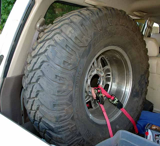

Ok I'm putting a 3rd strap through the rim, and calling it good. It already barely moves.
Nice! Anymore pictures? Is that just a safety strap?
I'll take a pic with the wheel off tomorrow. The Slee design
