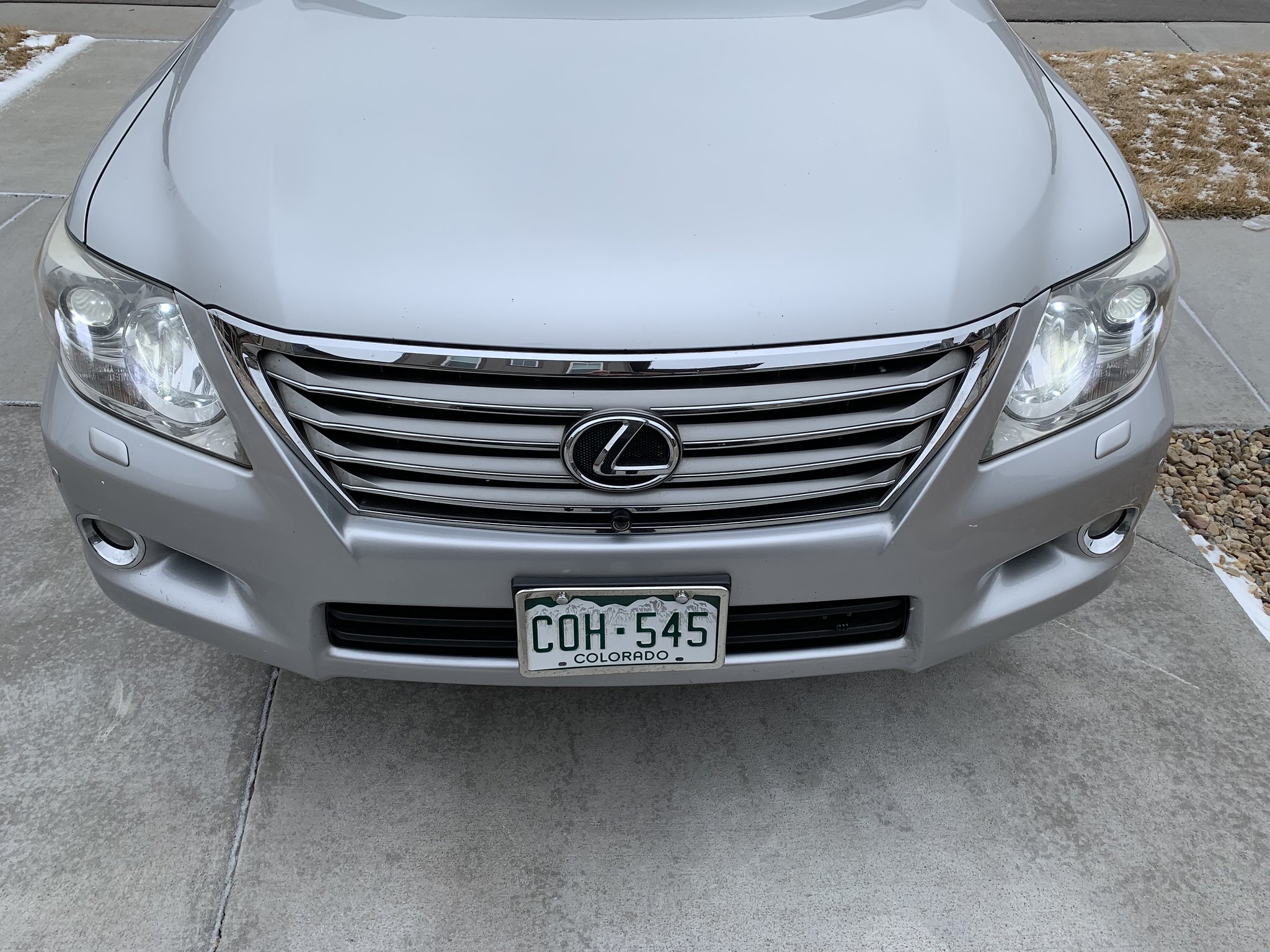

I received my IPF 351HLB2 - 9005 High Beam Bulbs and IPF 301WAM - T10 Marker Bulb today and got them installed. Thought I would share some photos and feedback!
DRL's Only - The IPF do function in DRL mode. They are significantly dimmed but there is zero flicker. They are rock solid.
Low Beams On - Parking lights illuminate as expected. If you look at the beam projected on the plastic lens you can see a gap in the light and two seperate beams from each LED on either side of the "bulb". As far as the illumination thrown on the road or what you see projected on a wall in front of the truck this is not evident. The light appears continuous and uniform across the beam pattern.
High Beams - Both the Low Beams and Parking Lights remain illuminated, this is stock behavior for the LX
Parking Lights Only - These things are bright, they actually throw enough light that they lit up my garage during the daytime. They seem to throw as much or maybe even more light that the Highbeams in DRL mode.
So there you have it, hope that was helpful and answered some questions. I'll follow up if anything changes or I notice any flickering of the DRL's but so far, very very pleased.
Excited to go for a drive tonight and see the combined output of the Low and High Beam LED's!
