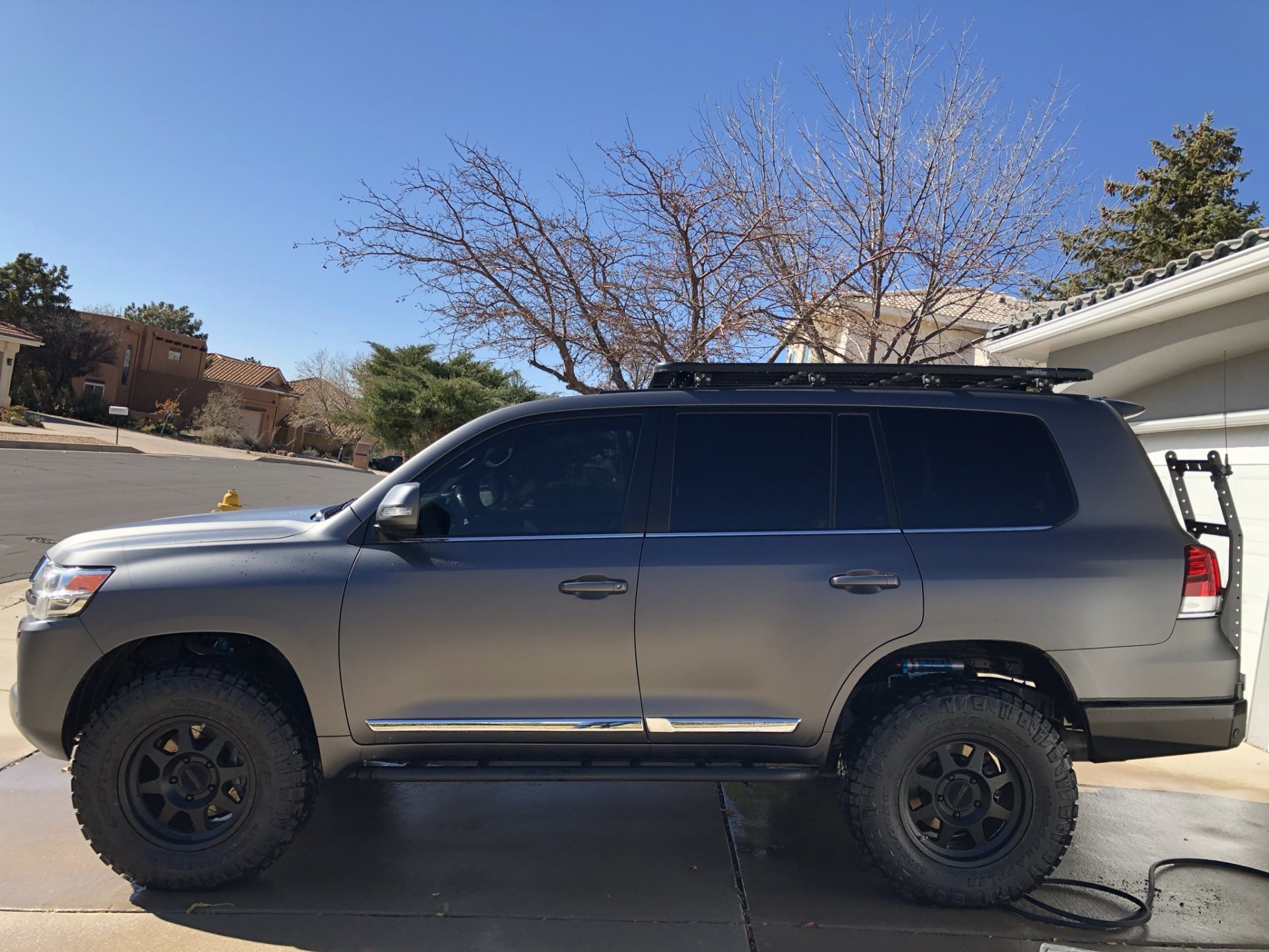

FWIW, I tried the 295/70r18 Nitto RG with MR701 +25mm and had solid contact on the KDSS arm. It definitely restricted steering. I added a 1/4” hub spacer, and the tires rubbed the arm at full lock. Reverse was a slightly different story. You clicks feel the lugs of the tires rubbing there even after the spacers.
My set-up at the time was King 2.5 600lb springs, Total Chaos UCAs. View attachment 3054763
It just looks right!
Looks great! So are you still running them?
No. I ran them less than a month because of the rubbing. I was also trying to sort out some suspension issues at the time as well, so I had a very low acceptance for abnormalities at the time. I also switched wheels, so I’m running rock warriors with 285/70r17 at the moment.

I was running a +25mm offset aftermarket wheel which maths out to about a 1.37” spacer on a 60mm factory offset wheel. I added a 0.25” spacer to see if that significantly changed the rub on the KDSS arm. It did, but not enough for me to stick with it.
