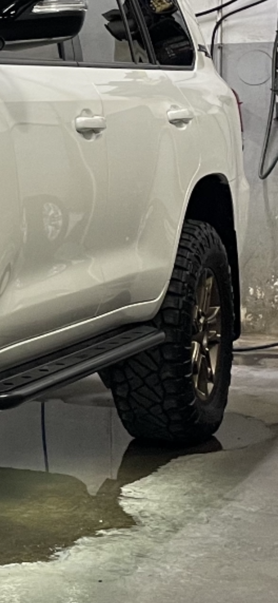

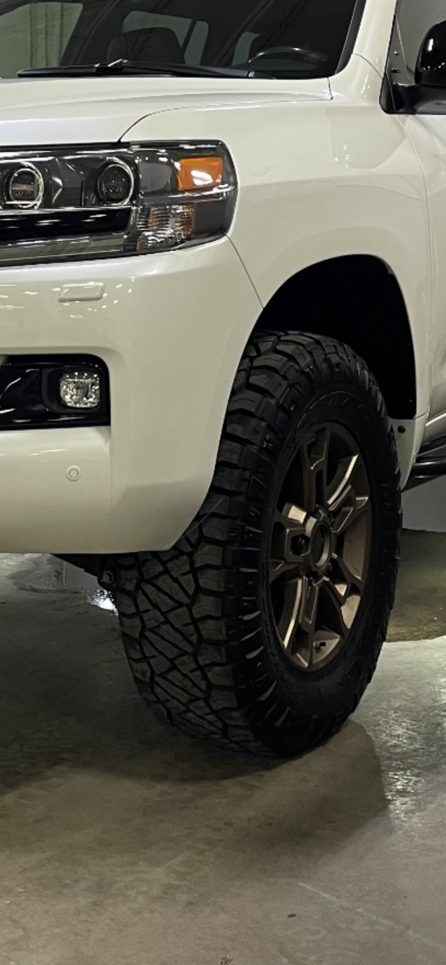

Do you have any pics of these totes on your rig you can share?
Are any of you running a 295/70/18 on your lifted 200? If so, which lift are you running and what are your wheel specs? I am very torn between 285/70/18's and the 295's, but there are a lot more options in the larger 295's and the prices are better as well.

The amount of lift won’t help much. They will rub stock UCAs and KDSS arms, besides the obvious plastics. The wheel needs to be pushed out ~1” to move it away from those to clear with minimal rubbing.
I’ve been running 285/70r18s for six months. I’ve been able to get it to work with my SPC UCAs and a good alignment.
