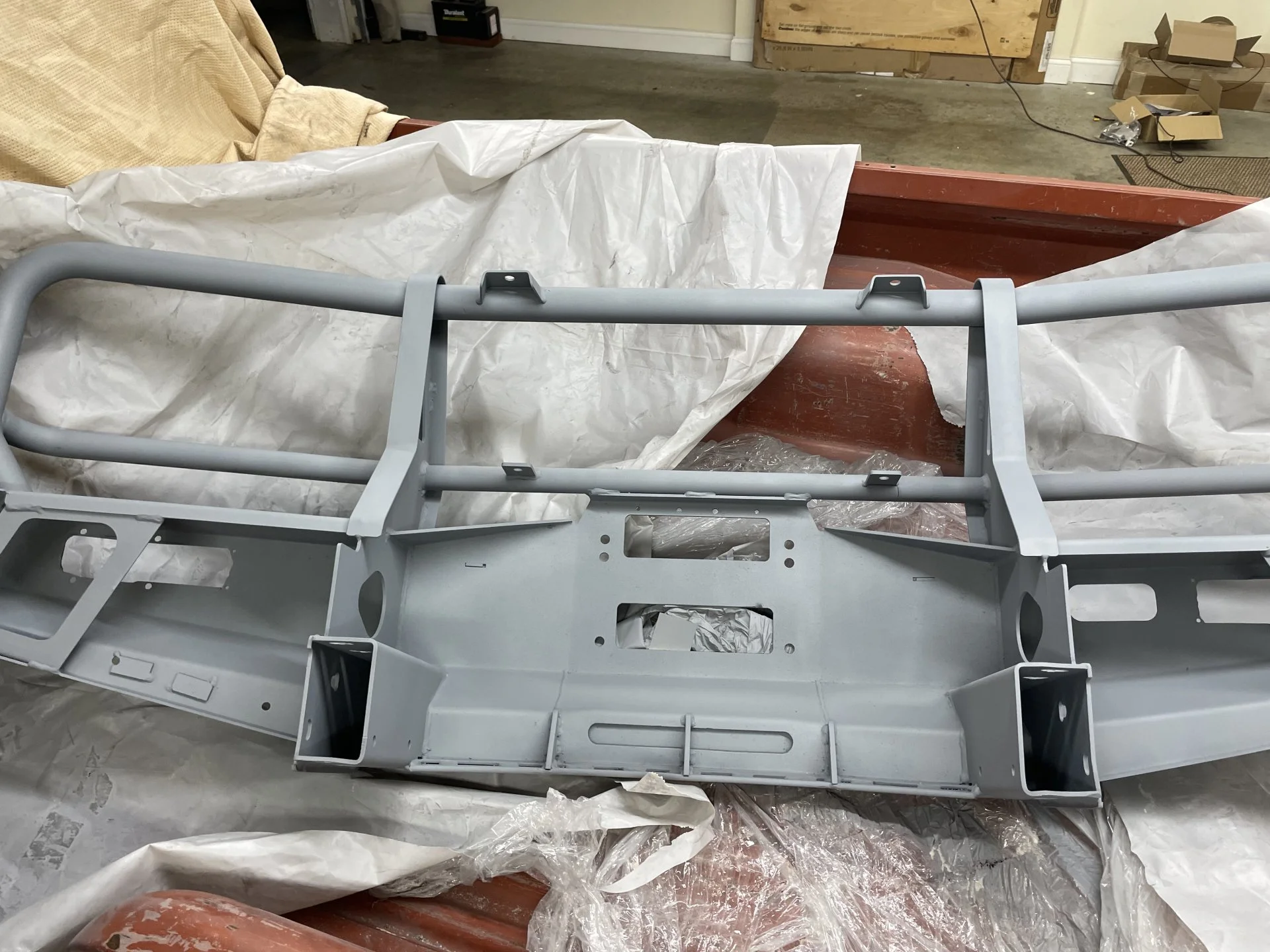

I had my sand blasted (it was pretty scratched up and had to be straightened/reinforced on the bottom edge) and used a coat or 2 of primer prior to painting with 4/5 cans of Rust Oleum Satin black.
Very happy with the results a year+ later!

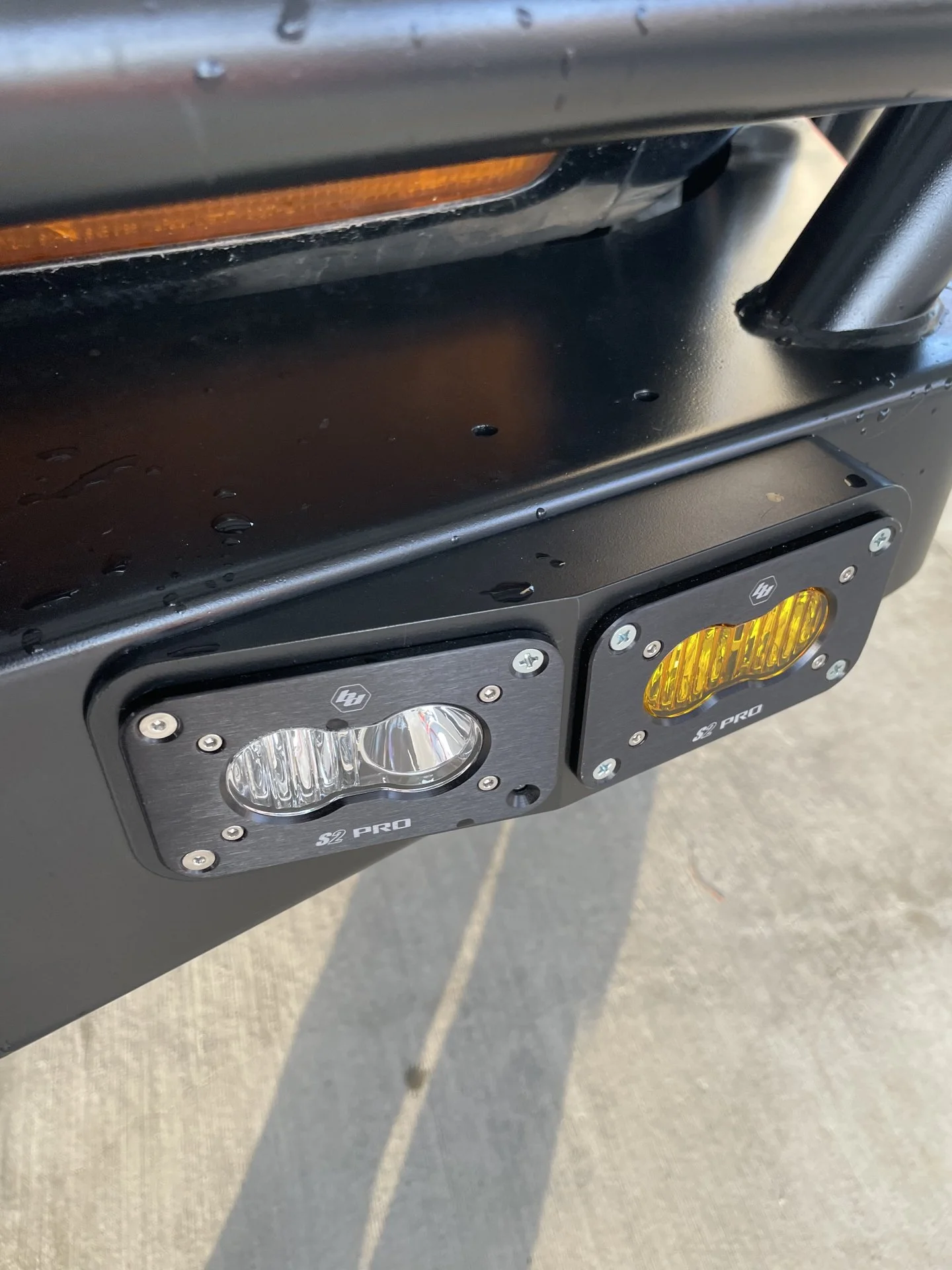

Where did you get that light bracket for the S2 Pros? I really like that setup.
Thank you!
A good friend designed and CNC’d them for me at his manufacturing company.
Several folks have expressed interest and we have discussed running a few more sets when his machines aren’t running overnight.
I will update the current list as we get an idea of cost and timeline.
