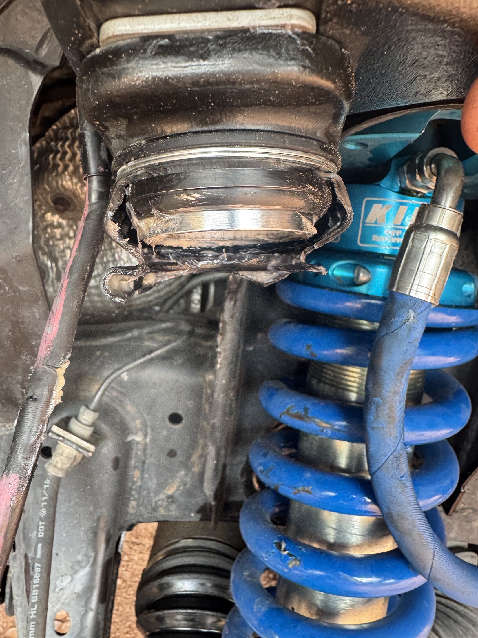

Took the 200 yesterday to a trail and going on a dirt road my upper ball joint from the SPC UCA decided she what to ruin the day
The ball came out the sucker clean leaving me stranded and paying $900 for a móvil mechanic to press that ball join back in. I was able to make back to the hotel waiting for tomorrow for the part to arrive. Now the truck has abs, traction control and pre collision and stability control light blinking. And one around here that can help me with a light stream scan? To erase this light before I depart to Virginia? The upper control arm is only 60 day old
If your upper ball joint separated it likely disconnected or damaged the wheel speed sensor. You can buy them both separately depending what is damaged

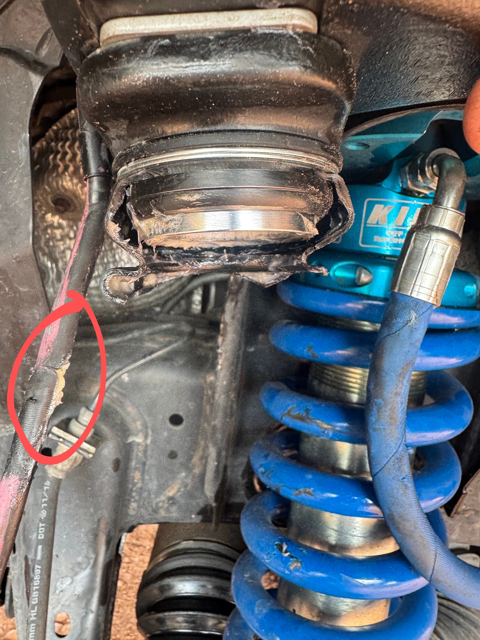

Took the wire out check for damage. One of the wire got pinched with the UCA probably causing a ground. I when back and insulated. I think the problem is my steering sensor detected my tire going in the wrong direction for just few feet.

Yes I when and open that some of the insulation came off but the wire is intact. I think the computer read a error now I need to erase

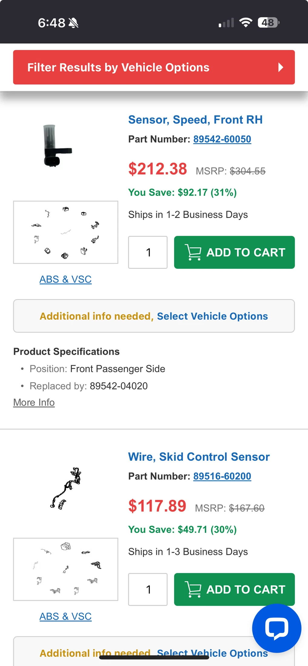

Let me save you some trouble: Replace the sensor wire. The sensor wire is shielded and if it is damaged in any way it can’t be repaired to work reliably.
Once you replace it with a new one the code will clear after you drive it.

So apparently you will be buying an aftermarket ball joint from the auto parts store. What will you be buying at the Toyota dealer-sensor wire?

Bummed and hate to see this happen. Trying to understand how a ball join even fails like that. From what I can tell, this looks to be an SPC manufacturing defect rather than any install or use error. Wouldn't be the first time hearing of an SPC ball joint fail.
