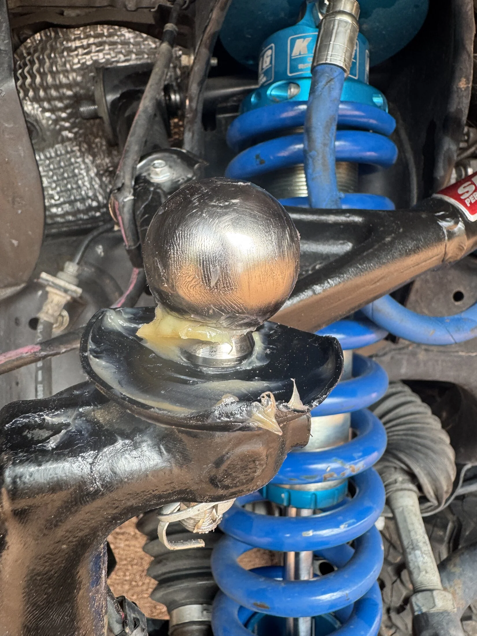

Took the 200 yesterday to a trail and going on a dirt road my upper ball joint from the SPC UCA decided she what to ruin the day
The ball came out the sucker clean leaving me stranded and paying $900 for a móvil mechanic to press that ball join back in. I was able to make back to the hotel waiting for tomorrow for the part to arrive. Now the truck has abs, traction control and pre collision and stability control light blinking. And one around here that can help me with a light stream scan? To erase this light before I depart to Virginia? The upper control arm is only 60 day old

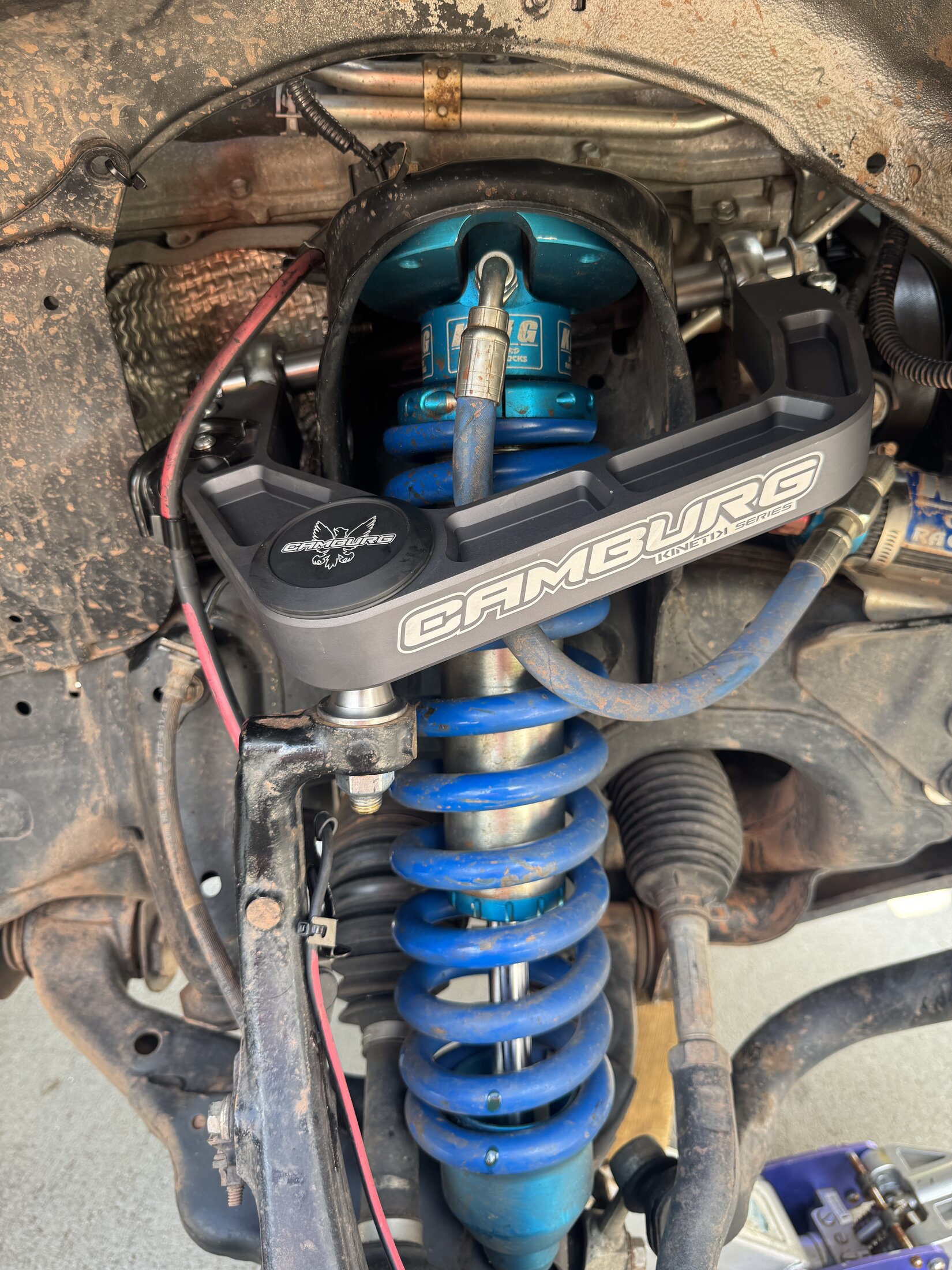

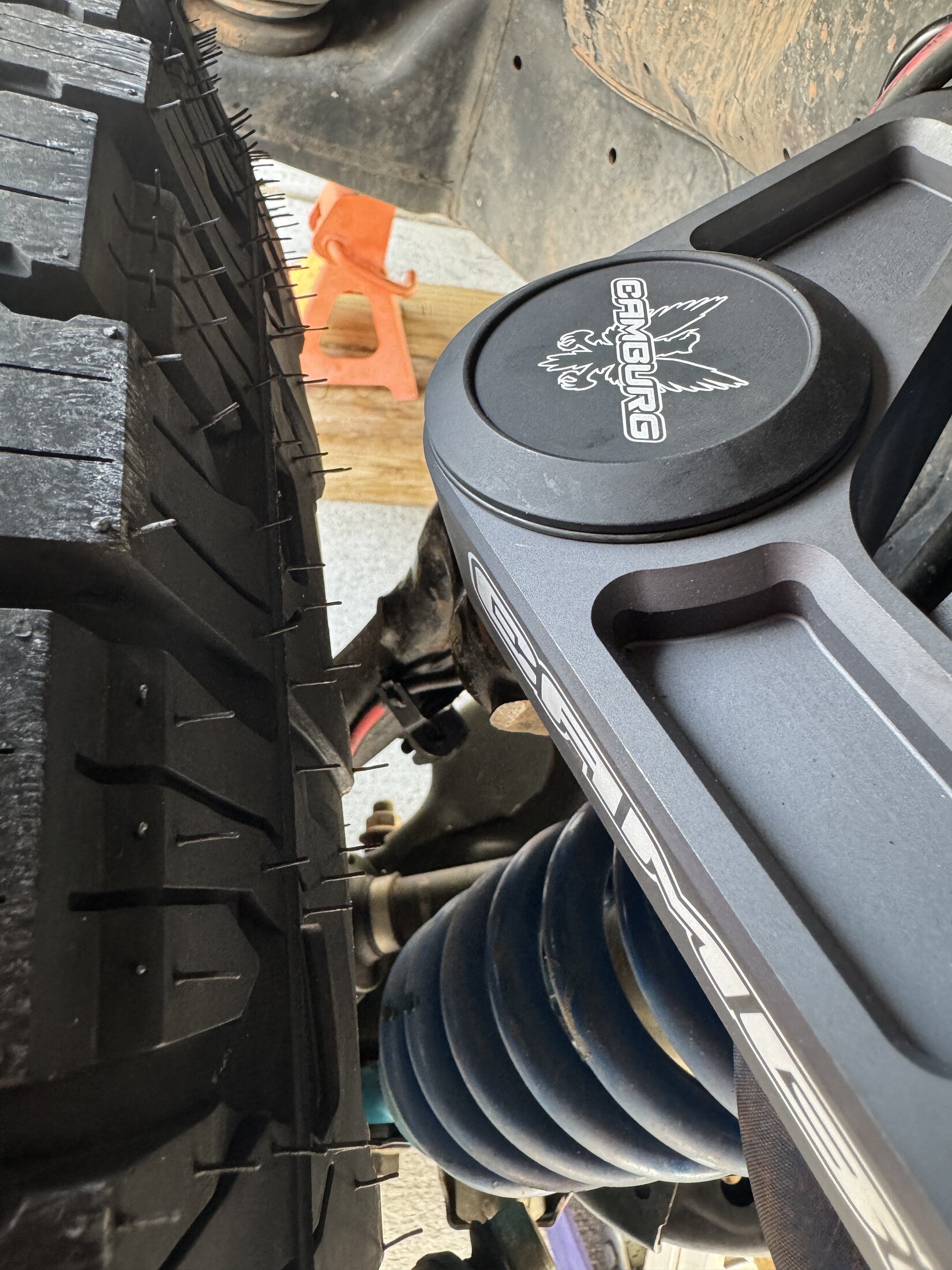

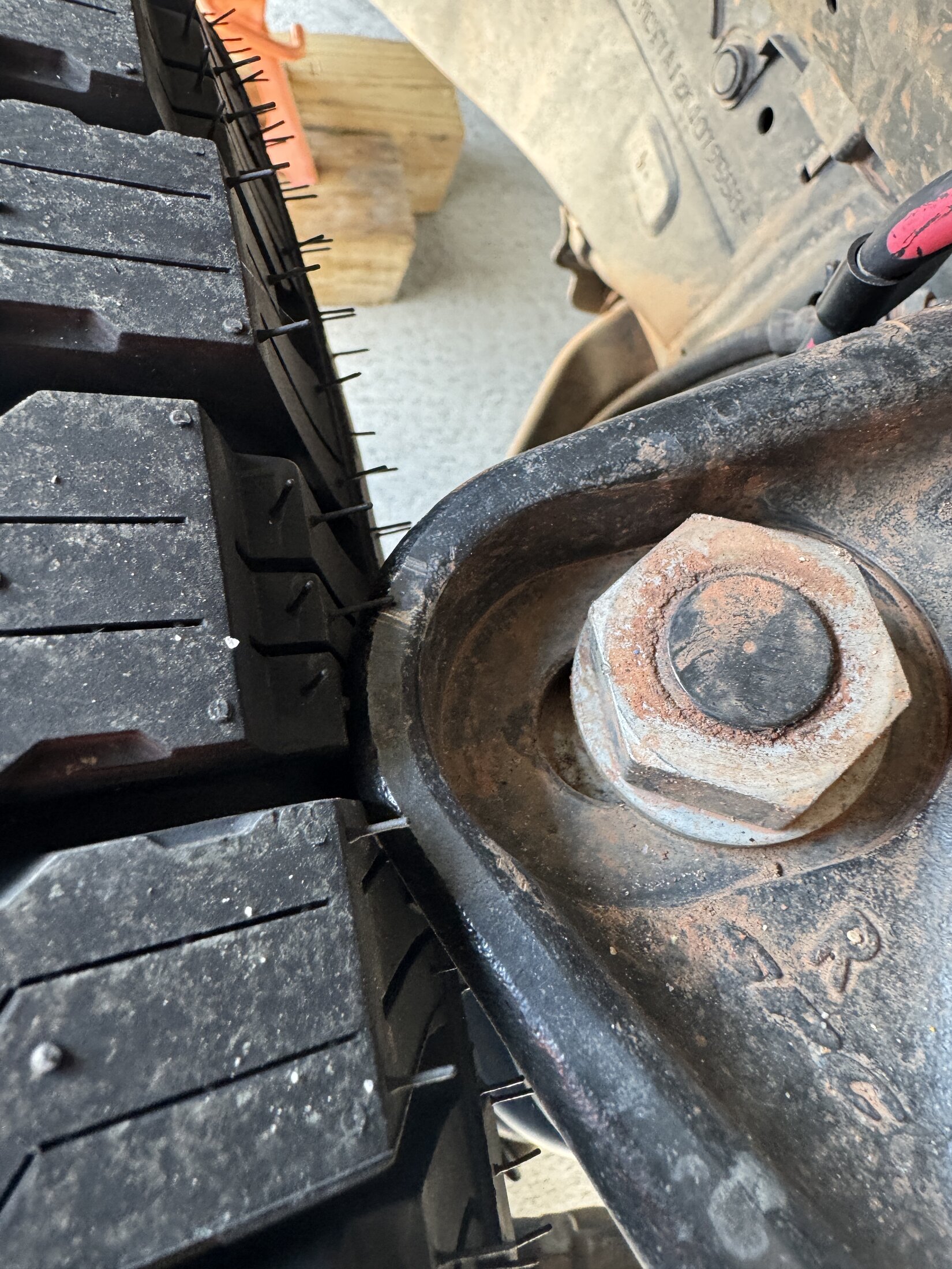

Update: I finally installed the camburg UCA I also got the truck alignment. So far this is my impression at full drop my SPC were touching my 35” tires, the 3 months old SPC ball joing was so loose I can wiggle with my pinky. Compare with the 3 weeks old ball joint. The camburg are in fact more robust and at the full suspension drop they don’t touch the tires, yes I was feeling a little more rashes ride but it only took going to the kings and set up my rebound to soft and put the ride back to normal. I believe is because they don’t have rubber bushings.
Update: I finally installed the camburg UCA I also got the truck alignment. So far this is my impression at full drop my SPC were touching my 35” tires, the 3 months old SPC ball joing was so loose I can wiggle with my pinky. Compare with the 3 weeks old ball joint. The camburg are in fact more robust and at the full suspension drop they don’t touch the tires, yes I was feeling a little more rashes ride but it only took going to the kings and set up my rebound to soft and put the ride back to normal. I believe is because they don’t have rubber bushings.View attachment 3941058
