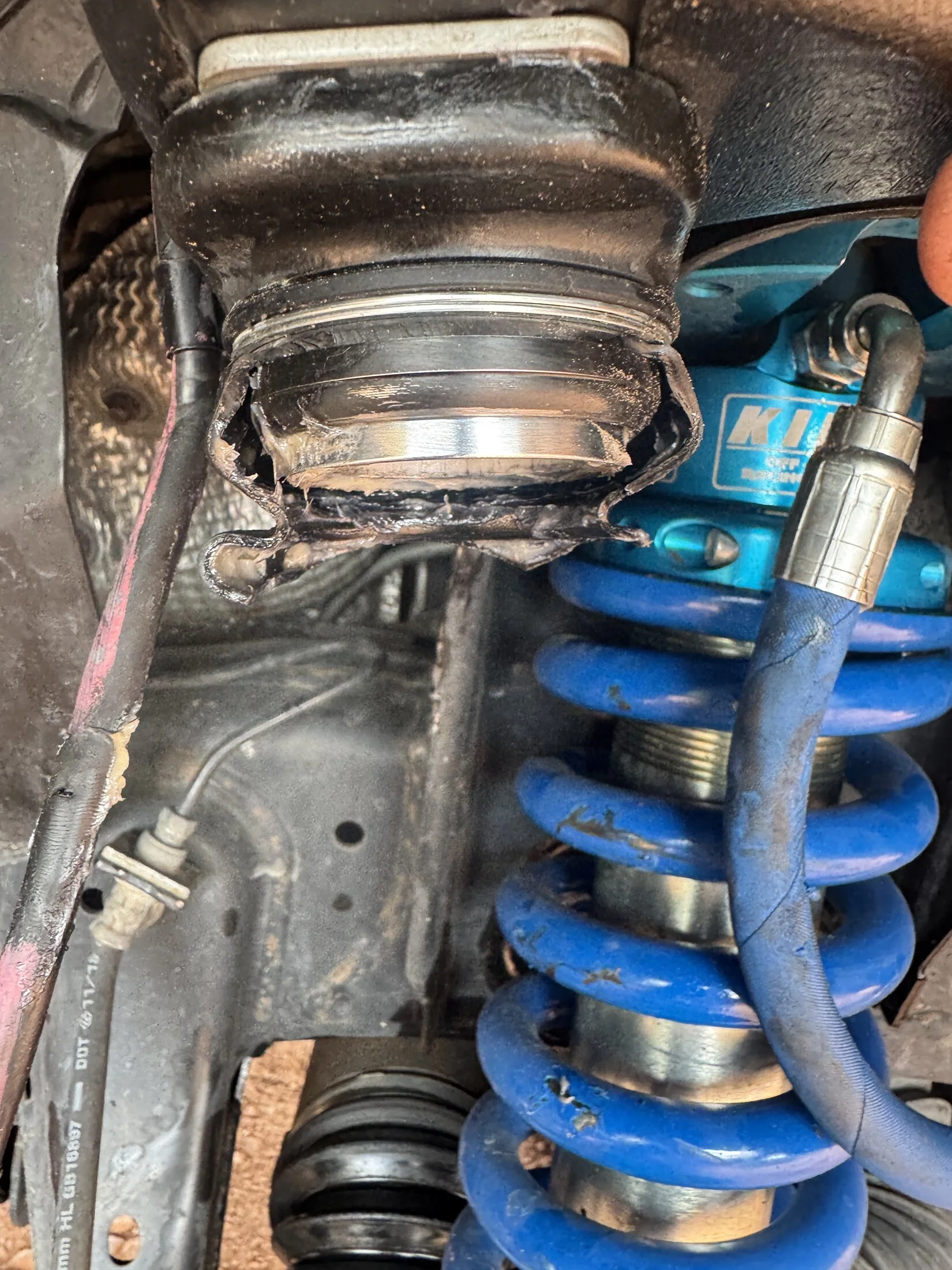

Took the 200 yesterday to a trail and going on a dirt road my upper ball joint from the SPC UCA decided she what to ruin the day
The ball came out the sucker clean leaving me stranded and paying $900 for a móvil mechanic to press that ball join back in. I was able to make back to the hotel waiting for tomorrow for the part to arrive. Now the truck has abs, traction control and pre collision and stability control light blinking. And one around here that can help me with a light stream scan? To erase this light before I depart to Virginia? The upper control arm is only 60 day old

That's an odd failure for sure. The UCA doesn't have much force on it typically. Especially in tension in a way that it will pull the ball out of the socket like that. The only way that should happen without a manufacturing defect in the ball joint would be if something obstructed the downward motion of the UCA (like the UCA interfering with the spring) or over-extending the range of motion of the joint.
Looking at this photo below - I see there looks like the blue paint coating on the coil spring is scratched off on multiple coils. It could be damage from the failure, but it may also indicate the cause. Can you test it to see if the UCA hits the coil spring on full droop? It could identify the failure cause.
Yeah, if the upper arm is the suspension limiter, either binding on the shock or running out of range of motion, the balljoint is going to rip out. Are the kings the extended travel version?

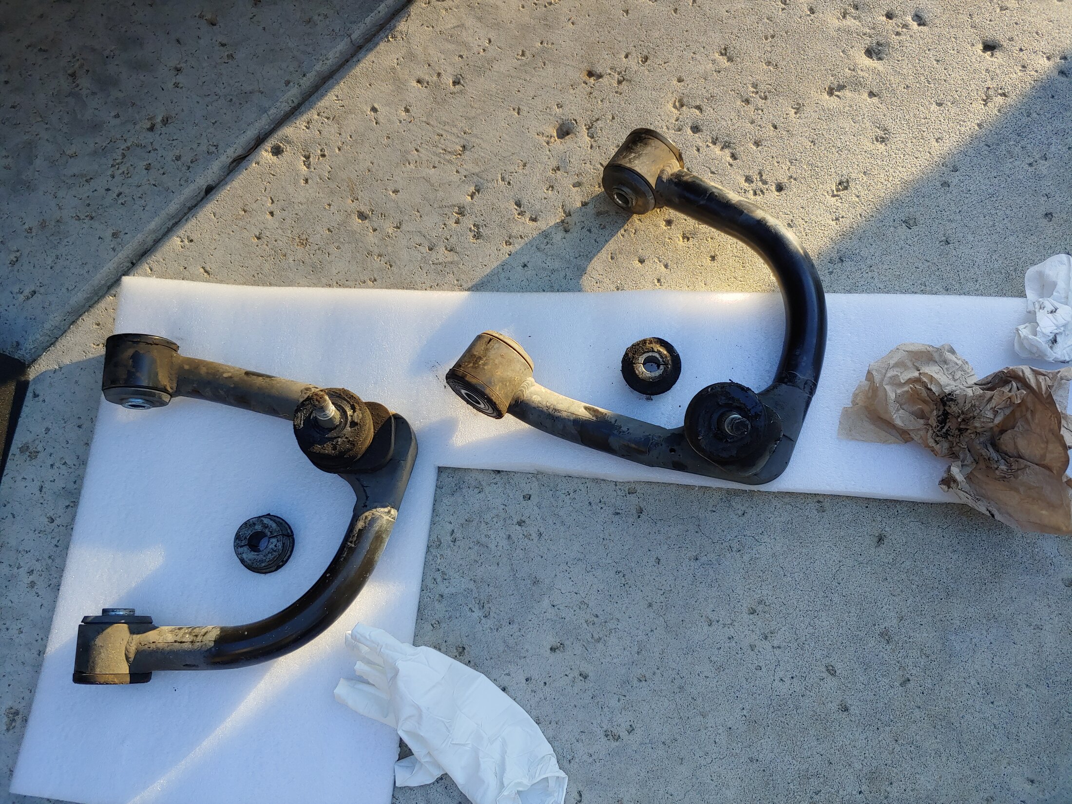

My experience:
I ran upper SPC on my Gen1 and twice my UCA crapped out. SPC didn't warrant the warranty on the 1st UCA and foolish me I bought a 2nd set and 8 months later needing replacing. Never buying SPC and uf I had the $ i will go with Total Chaos.
Well mu
My experience:
View attachment 3928347View attachment 3928342
well mudify was the one that got me my money back . I just order Camburg kinetic.since it was a store credit i paid $500 for it
