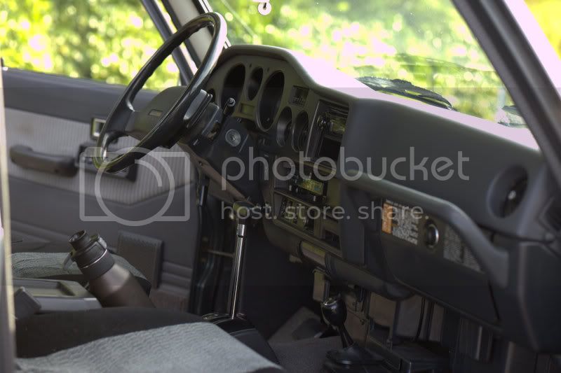

Does anyone know the correct paint color to match the blue/grey interior? ('88 FJ62)
If so, please let me know :) I'll post some before and after dash pics

We use SEM Color Coat's "Graphite Grey" for our interior trim. You can find them at a local trim and upholstery shop. Or we have cans on our site, too.

SEM Colorcoat 15163 Presedio matches the metal lower dash. Colorcoat is mostly for plastics and vinyl but can be applied to the metal dash portion with the proper prep. Youll need to scuff it up really well with a scotchbrite if not removing the original paint completely, then hit it with 38373 SEM Solve, and then use a good etching primer like sem 39683. You can then spray the color coat to that. The plastic bezel was painted with sem 15163 and the metal portion and everything else is original
