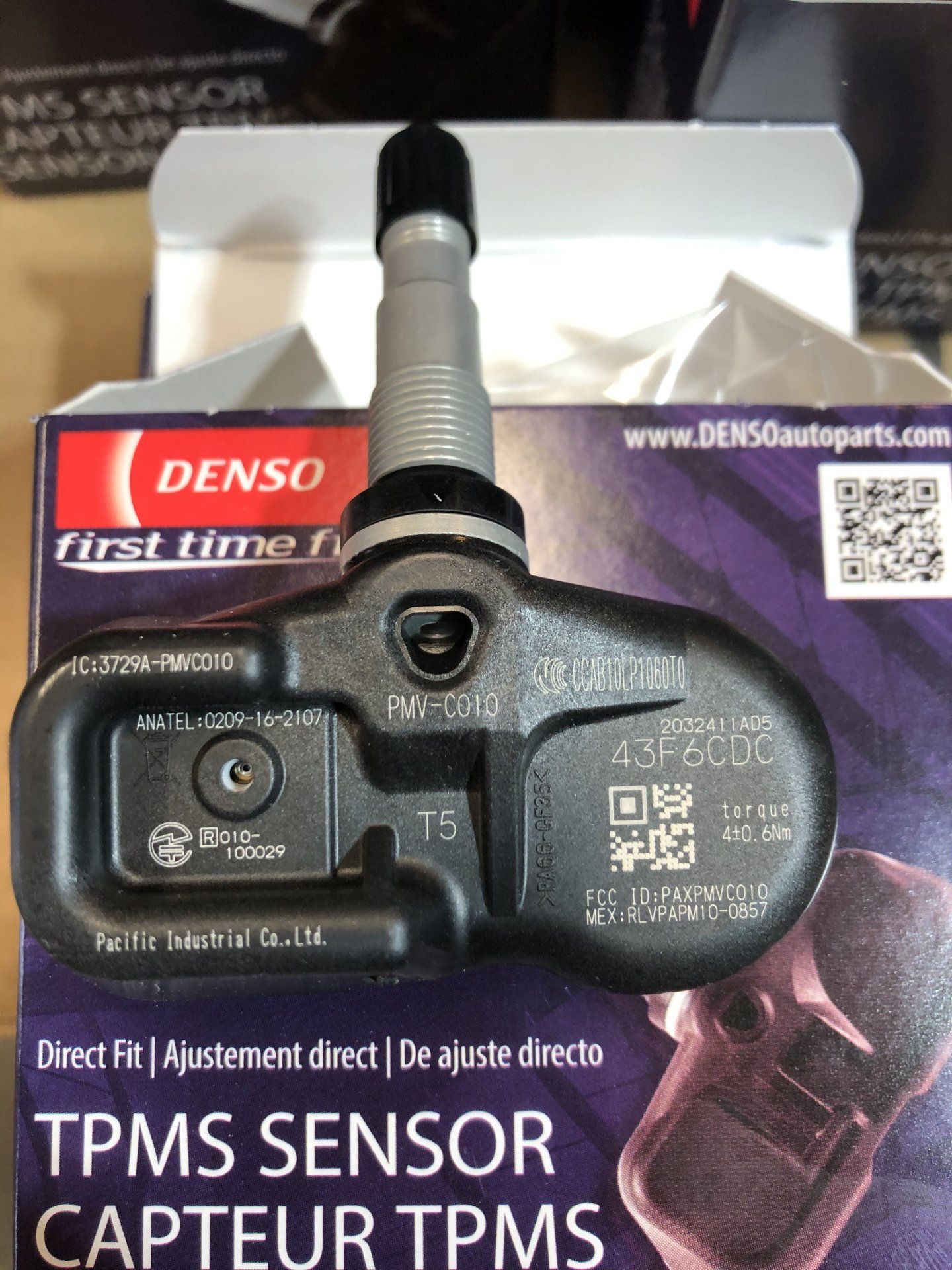

I tried dropping to 15 psi and airing up again, but my sensors still aren't communicating with the ecu. As noted above, I probably need different model of sensor, but it was worth a try (cost=$0). Five new TPMS is at least another $200 plus another tire shop trip. Annoying that Denso isn't fixing this in their catalog, if it is a known issue.
Where did you buy them? Can they still be returned? Some places may take them back if they were the wrong model. Especially if that company has the wrong cross-reference. It is at least worth checking into...
I'll look into it. I bought them from Rock Auto. Unfortunately, the tire shop threw away the boxes. But definitely worth a try.

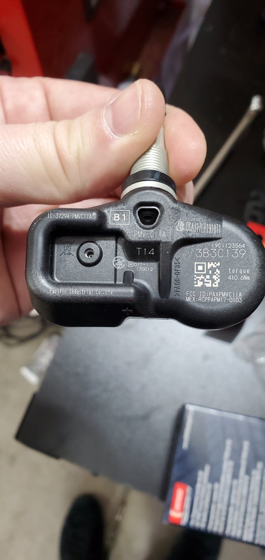

I've ordered 10 of these, I swear one was counterfeit, as I couldn't get it to activate/register.
The ones I could register
The one that wouldn't

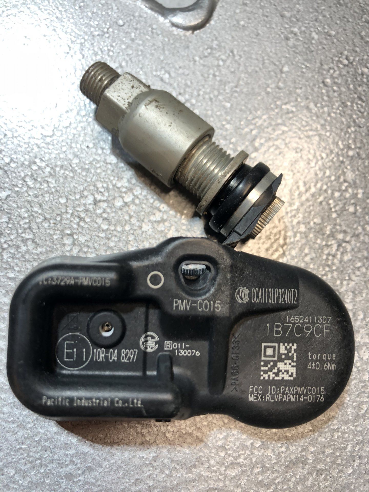

Soooo... for some further confirmation:
I took the old tire irons to the job. I pulled out the original TPMS from the spare, and low and behold, it is a PMV-C015...
Which is (as you alll keep saying) different than the replacement units (PMV-C010):

The sensors were all the PMV-015 version.

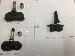

Question: Do all 200 series use the TPMS sensors with nut/washer or do any of them use the snap-in type (shown below on the right)?
I've only seen '13 and '16, but know from recent parts searches that the '16-20 share the same sensor part number, and they are all the type with the threaded post, washer and nut.
By the way, I'm in a back and forth with DENSO and they haven't backed down from their incorrect fitment. So far, they refuse to admit that the ones for the '16+ are wrong in their system.
Thank you @40Man I was just curious which Toyota vehicles use the snap-in TPMS vs. the nut/washer TPMS. Pacific makes both.
Generally (At least on the Tacomas I have dealt with) the snap in type sensor is used for Steel Wheels and the nut/washer type is used for Aluminum Wheels.
