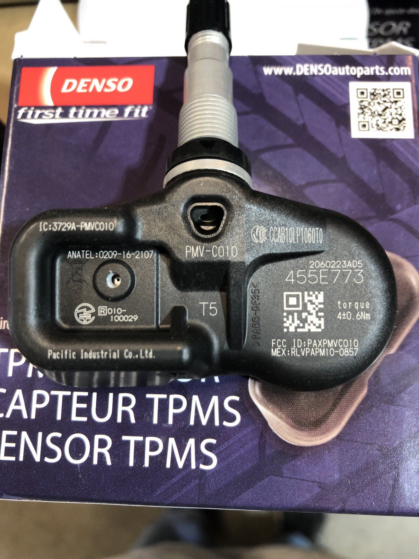

I put five new Denso TPMS monitors (5500105/550-0105 Tire Pressure Monitoring System Sensor) in my other rims/tires before putting them on the rig ('16 land cruiser).
I noted the Ids for all 5 monitors. I used Techstream to register the new sensors, and that worked (I can reopen Techstream and the correct/new IDs are preserved). I've got 4 tires installed and the 5th in the cargo area (temporarily, while I get the sensors recognized). I've tried the procedure where you turn to the ignition on mode and hold the TPMS button under the drivers dash (the light is supposed to flash three times slowly and reset), and it doesn't work: the pressures don't show on the dash display, and I have the TPMS error/warning light on constantly. I did the reprogramming procedure far away from my garage, to avoid the computer trying to pick up the sensors on my factory rims.
Have you seen anything similar? Any trick or tips?

Denso 550-0105 shows for MY 2015, and IIRC there is a VIN split in 2015 for TPMS sensors. Could it be that you have the wrong sensors?
That model is what the Denso lookup tool shows (and it shows the same for '16,'17 and '18).

But to your point, the thread you referenced said that RockAuto, Denso and others have the wrong p/n for 2016.
If so, this really sucks. What a pile of wasted labor and parts expense.

If so, I have the wrong one, these are PMV-C010.
Yes, Denso has the wrong cross reference and you have the wrong sensors. Another thread on here help me avoid the issue you are dealing with.
I emailed Denso about the error over a year ago.
A bit OT, but if you go to Discount Tire (they program for free), their software won't program the 2016+ if they enter it as a Land Cruiser in their handheld programmer(possibly because their machine is looking for the wrong sensor too). If you have them enter LX570 in their programmer it works perfect.
Edit: I cross referenced toyota part number 42607-48010 to PMV-C015.
This is what I ordered and they programmed fine on my 2016.
