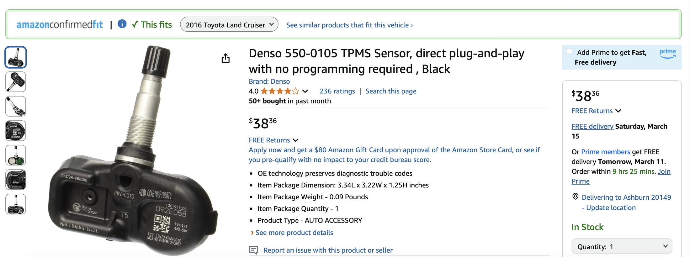

Amazon sells these: Denso 550-0105 TPMS Sensor, direct plug-and-play with no programming required. $38.36 each​

Per their notes, these are direct replacement for my 2016 Land Cruiser.

Be careful with these statements. DIfferent years of LC and LX have different sensors and different programming requirements. None of the early systems can change out the sensor without reprogramming. I don't know about the new systems. But the point remains, blanket statements like this with no qualifiers about what they were used on will get people buying the wrong stuff.

BLANKET STATEMENT: there were year model changes in the sensors so a given Denso number won't work for all 200s. I think things are pretty consistent from 08-14, 2015 might be when they started switching numbers around.
For the record that's not the correct number for 08-14.. though I don't know what year you have. Not to mention the chances of getting fakes on amazon.

Mine is a 2016.
I'm quoting this to stress your point..
550-0103 for the earlier rigs.
More good info:
I would not trust amazon sensors, nor their part number cross referencing.
Rockauto seems to think it should be 550-0106 for a 2016 but I'd confirm that on this board (search) before purchasing.

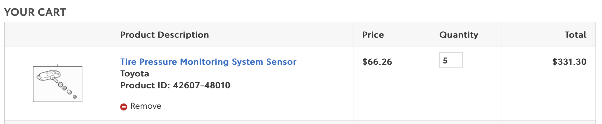

Wholesale Toyota Dealer parts vendors prices are similar. Here's one that sells the units for $66.26 each or $331.30 for 5. Retail is $100 each and there is still "meat on the bone" for the parts department selling at a $34.00 discount. I'd venture "Cost" is around $40.
Justify $500-$600 to install them at retail. (The mechanic "might" get an hour.)

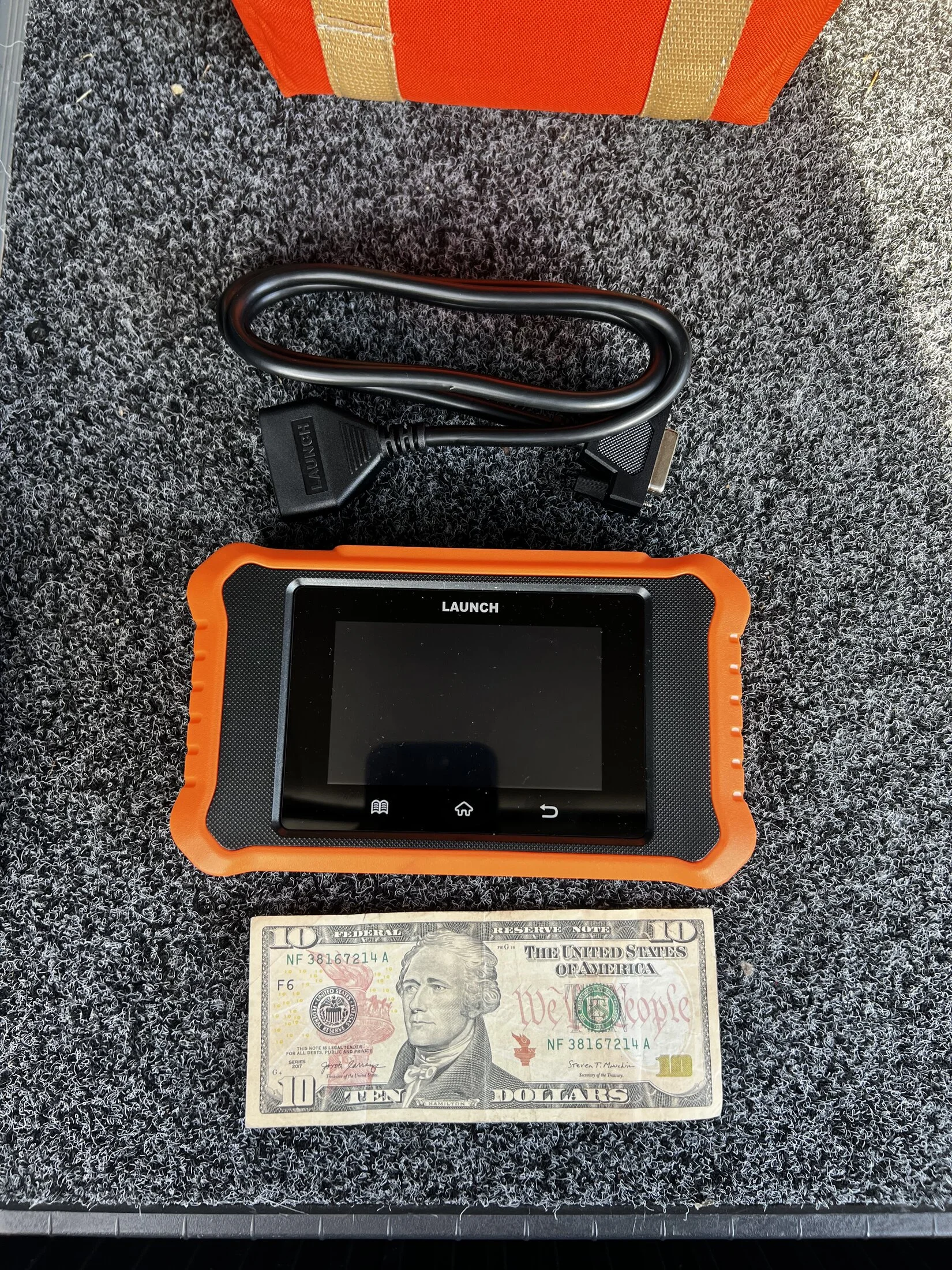

Get an Autel TPMS programming tool.. can program clone sensors and has the great feature of being able to detect IDs if they weren’t noted. This will only do TPMS however, so for many home mechanics I consider this money better spent on other diagnostic tools. But it’s specificity does make it easy to use.
