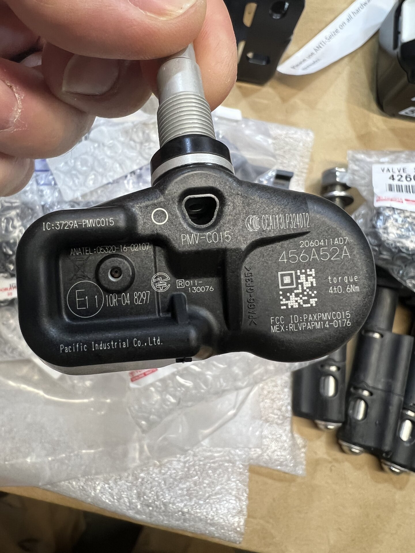

I might be reading this wrong. My 2013 and 2016 Land Crusiers both used the kind with a nut that screwed in. The Denso packaged ones came with the nut, washer and rubber seal. The Toyota ones I bought didn't, they were a separate part number. Luckily my installer happened to stock them.
Edit, pic:
That is correct. The older Pacific TPMS have a part number for just the sensor and separate part numbers for the nut and washer itself.
The washer was 42636-06010 and the Nut was 42637-06010 but they don't look like active service part numbers.

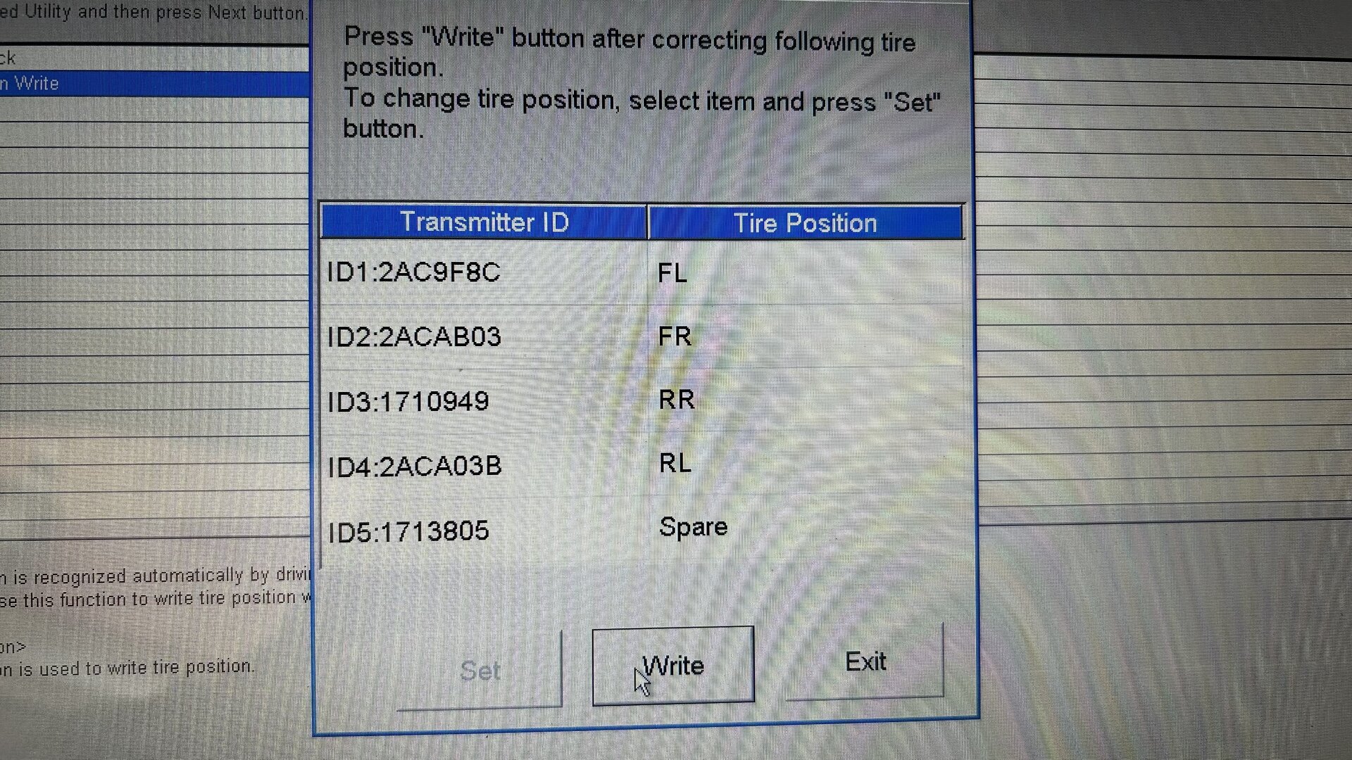

Interesting. I had new tires on my 2018 put on a few weeks back and they’re all reading except
for the spare. It’s fine on short trips, but if I get on the highway for 20 minutes or so it comes up with an error code that blanks them all out and I can’t reset unless I use techstream. All the transmitter IDs are showing in techstream. I’ll have to dig more on the pressure cycle thing.
Interesting. I had new tires on my 2018 put on a few weeks back and they’re all reading exceptView attachment 3337829 for the spare. It’s fine on short trips, but if I get on the highway for 20 minutes or so it comes up with an error code that blanks them all out and I can’t reset unless I use techstream. All the transmitter IDs are showing in techstream. I’ll have to dig more on the pressure cycle thing.
I’ll be damned, I dropped the spare air pressure and it came right on. Thanks!
