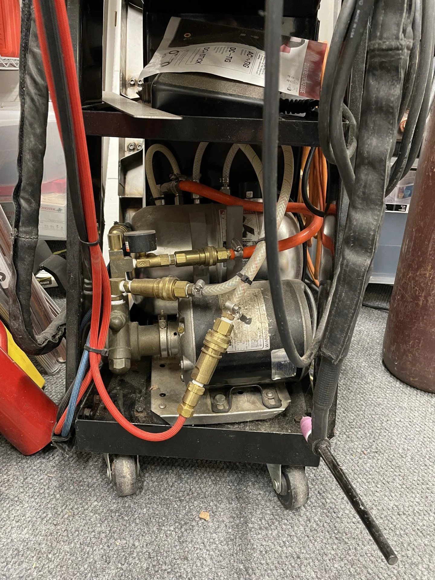

I have a Lincoln Tig200, I made a liquid cooled setup using a soda fountain carbonator pump. I did not bother with a radiator and fan as I am the occasional home hobbyist.

Did you just kinda make this up as you went or did you find a how to somewhere on the water cooler? That’s kinda genius
I read somewhere that the carbonator positive displacement pumps work well and are usually paired with a reservoir so I bought one at a restaurant surplus store, added bypass valve and gauges, and bought a water cooled torch and leads and used carpet cleaner quick disconnects to hook it all up. It's not perfect but lets me play around with AC on aluminum as long as I want too.
That actually looks a lot like the coolant pump in one of the water cooled machines that I've used extensively in the past. IME the connections at the torch body are not all that secure, be careful with how much pressure the pump can output. The torch mfg probably has a spec for this.
If you have a closed system look into the recommended coolant. It isn't likely to be pure water. Mine came to me with automotive coolant in it that is past due to be replaced. Next time around I plan to use this: Organic Acid Technology (ES Compleat™ OAT) | Cummins Filtration - https://www.cumminsfiltration.com/organicacidtechnology
