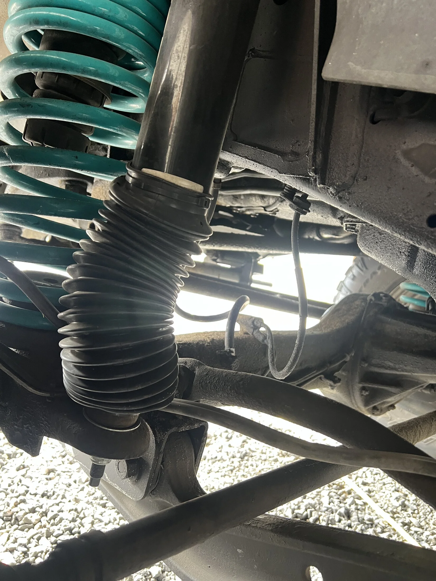

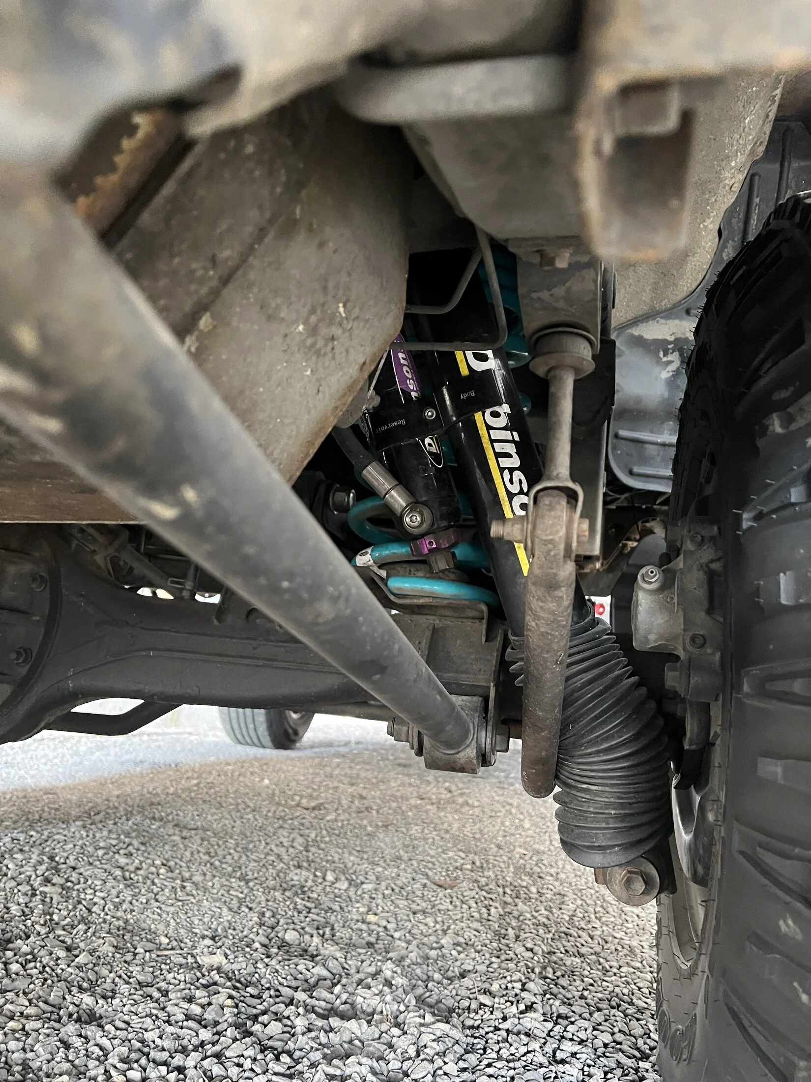

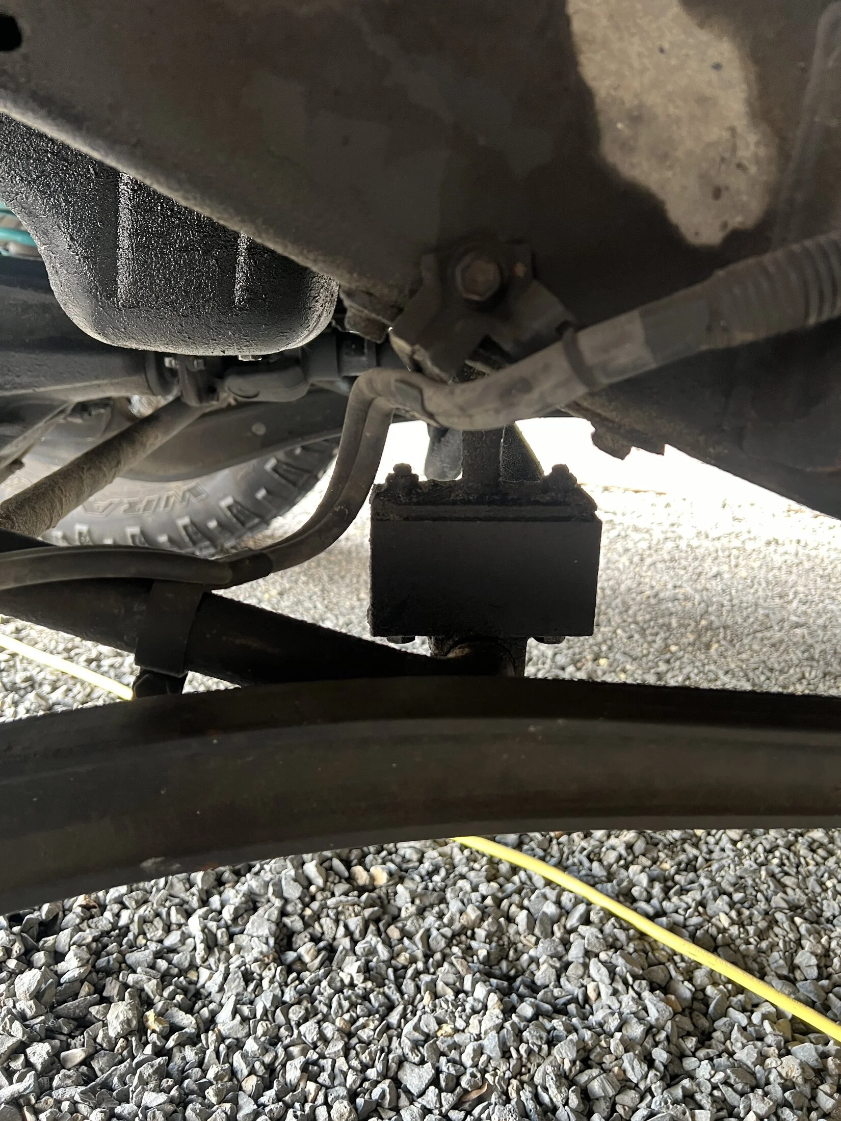

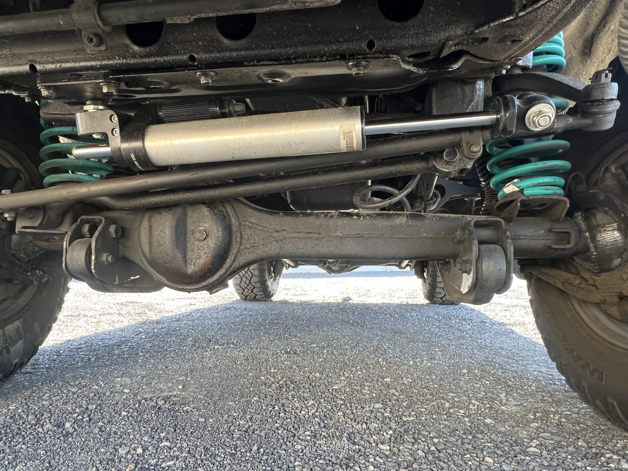

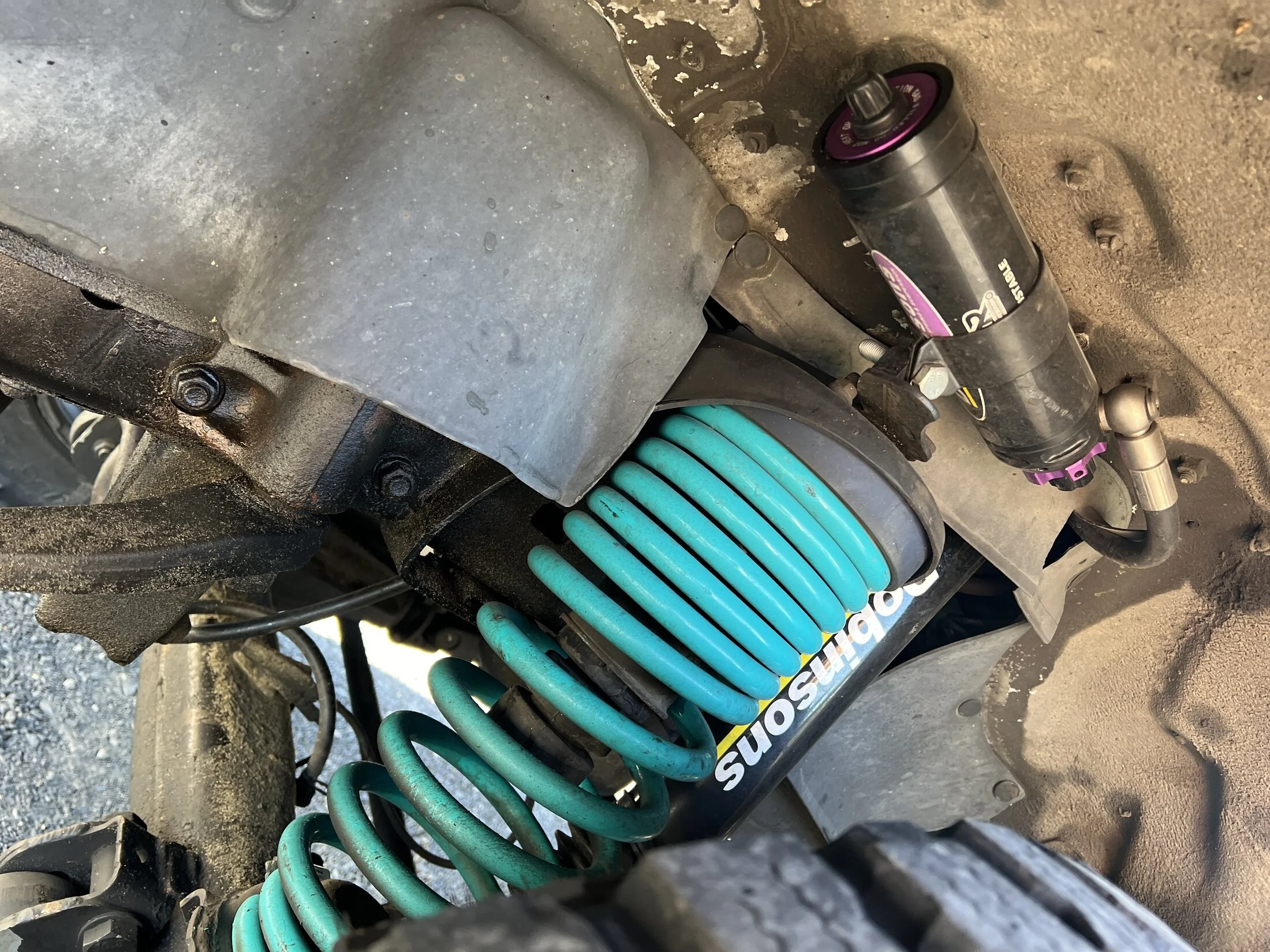

Some pics just for fun.

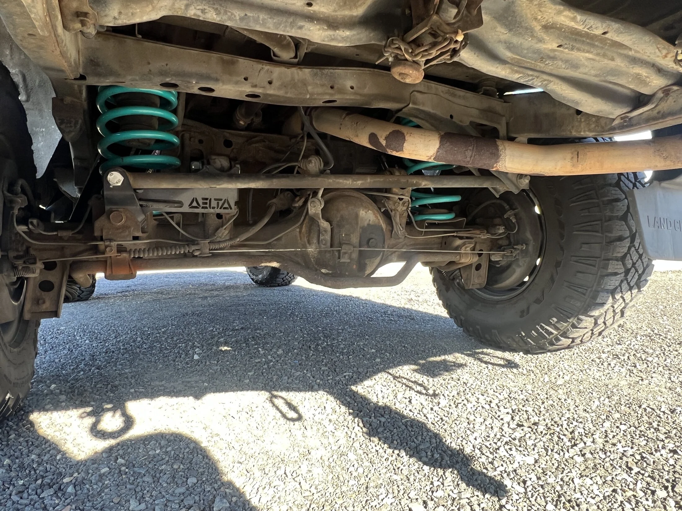

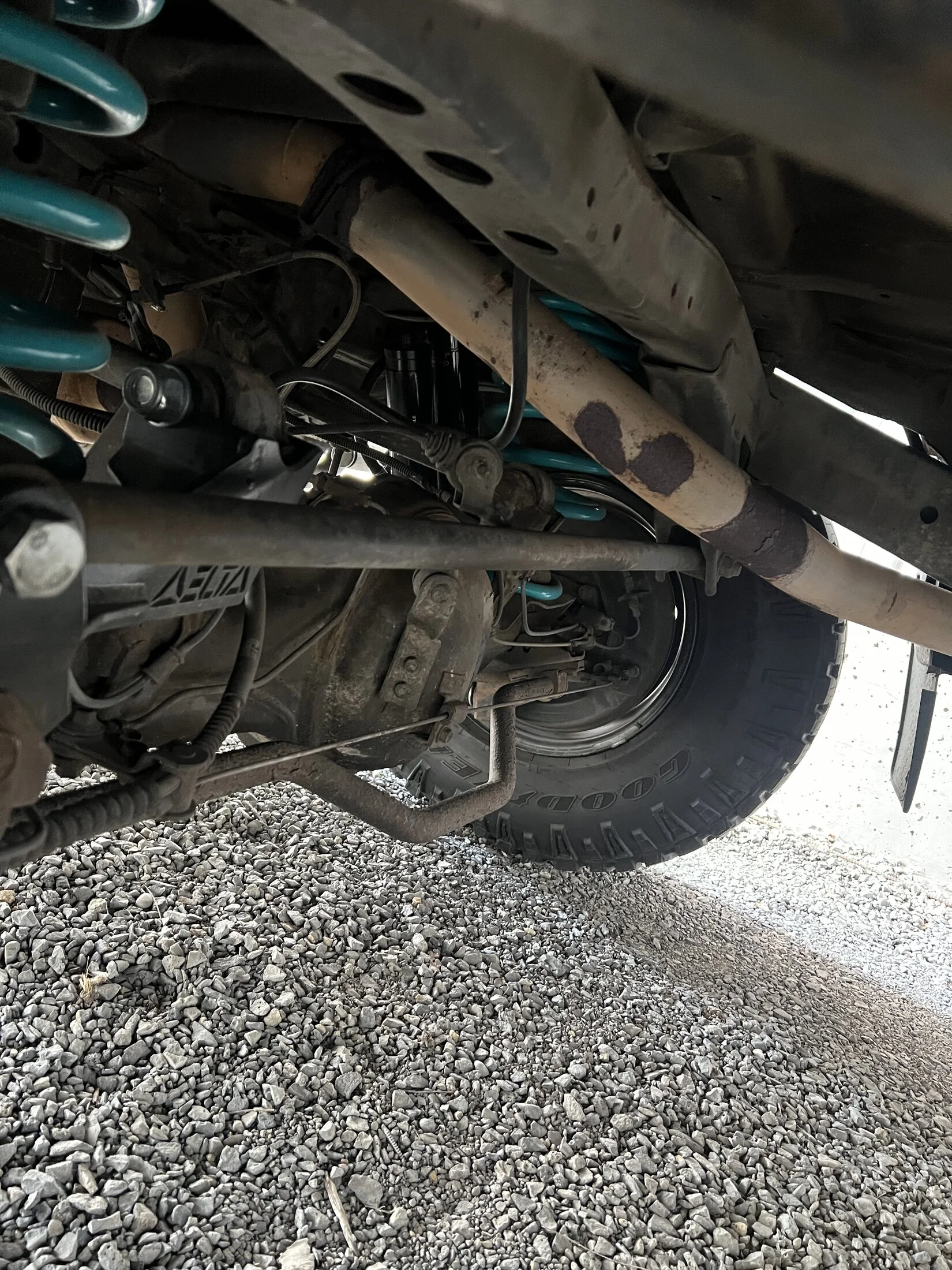

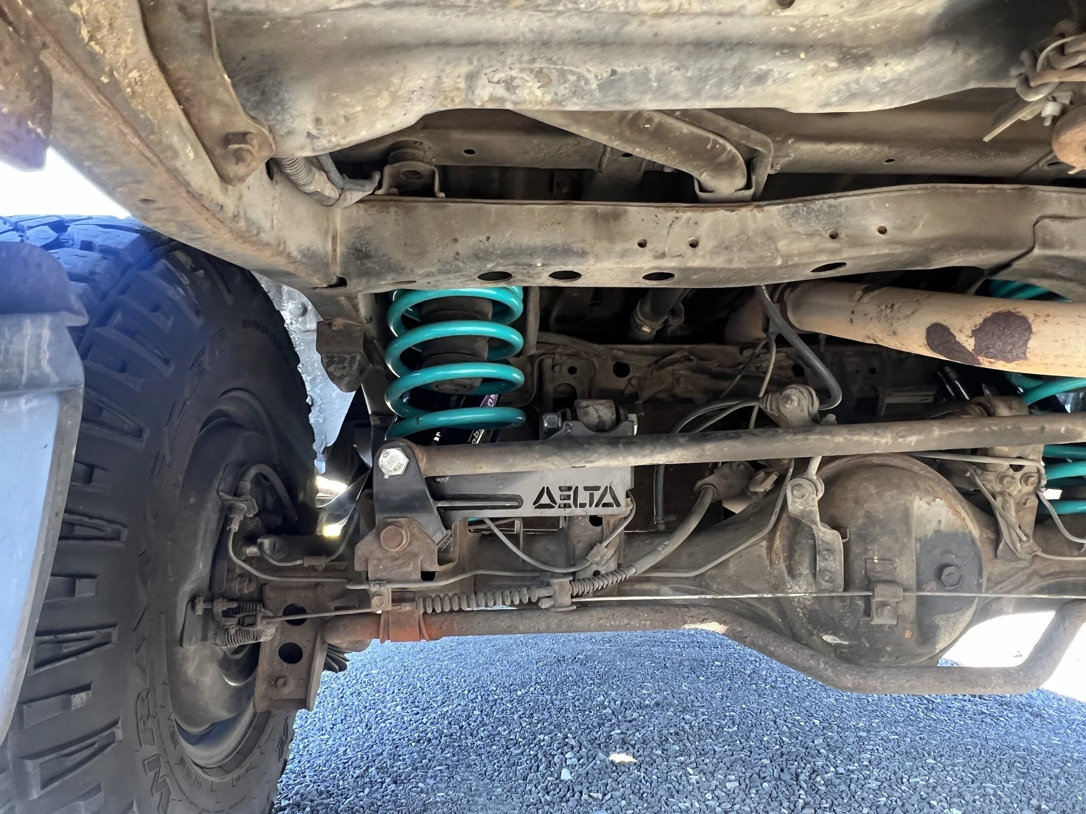

Just curious if this sway bay spacing / ends / brake extensions look similar?
The front sway bar looks like it has spacer blocks. That's the same way mine is done. The rear does not look like it's dropped. My lift kit did not come with rear sway bar adjustment, I added the extended HD links from LandTank. Landcruiser Phil also sells some nice ones.
I have not had issues with the coil springs popping out. I think with the factory suspension design your flex limits out due to the links or control arms way before the spring fully extends. You can kind of see in my avatar that my driver rear wheel is dropped as far as it will go and the spring still didn't come loose. I've even been fully flexed out without a sway bar (it got ripped off one trip) and no issues with springs. Springs coming out could be an issue if you went to a 3-link in front and/or redesigned the rear geometry. If you are concernd about it I think Delta Vehicle Systems sells spring retainers.
In your pics you can also see why the ABS lines aren't an issue. They are routed on or parallel to the links/control arms so they move as far as those move without stretching.
