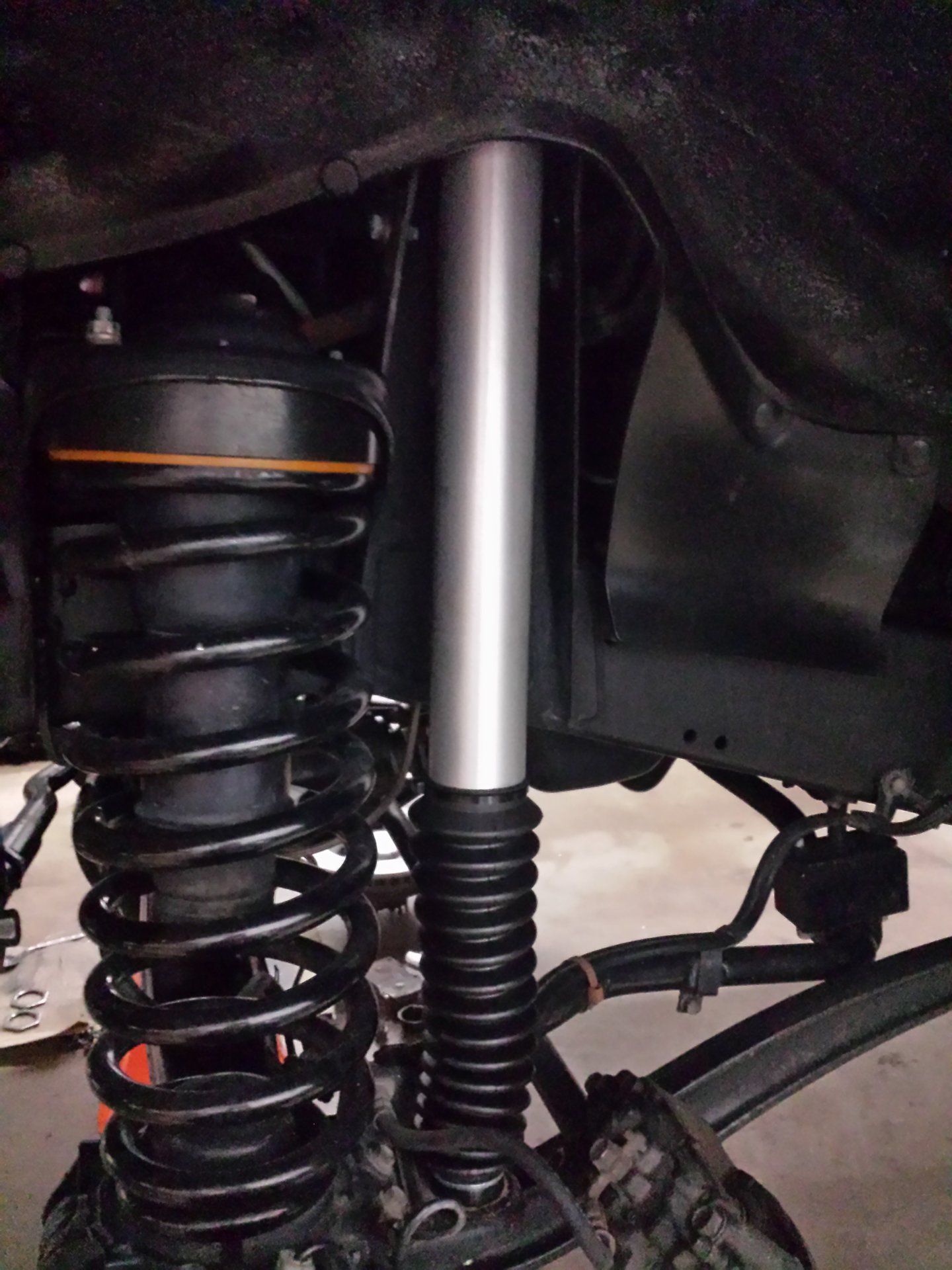

Last but most important, PUT A BOOT ON THE SHOCKS. Not even $15 for a set:
