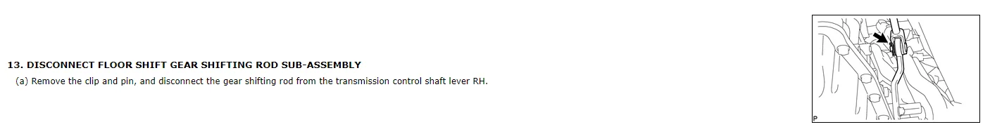

Check this clip and pin underneath the truck which connects the shifter to the trans and make sure it's secure...
Thank you both for the info and diagrams. So I did disconnect the shifting rod in the post from linuxgod, and the shifter in the cab moves freely, so I'm no longer suspicious that its gummed up or dirty. But that makes me nervous that it's something in the trans... not feeling very optimistic at this point.
