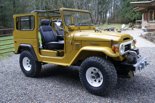

I was looking at the pic in Slow Poke's thread
attachment.php
and was wondering if anyone has ever made a soft top that just replaces the fiberglass portion of the hardtop, kind of like an oldschool hot rod?
You could still get some sunshine and air when its livable outside and quickly put the soft portion on when the weather changes. Wouldn't have to worry about finding soft top bows and this would still maintain the stockish look. Methinks that this would be way cheaper than a full soft top too.

Does he drive it around like that or was that just a pose for the tire pic ? What would you do about the back with the doors off ?
Are those cepeks 33x12.50 good looking tires
dunno how strong/rigid the sides would be w/o the fiberglass on it. They could wobble at speed. Could perhaps run some thread rod to connect the seatbelt mounts together and add a bar on the top rear above where the rear doors normally are.

We've been discussing trying that on one of the FJs we decided to do some different stuff with, it's a giant rust bucket anyway. Our plans involved bows in a channel and significant reworking of the hardtop sides to keep in structure without all the support the rear cross bar (ideally removed) and cap give. The B400 worked as the pieces are non-removable and planned when stamped. We're planning on welding the sides to the body and internally bracing it followed by skinning the inside of the top to keep the work hidden. For the average guy, this is not worth the trouble.
As far as the pictured FJ, if there weren't strong side winds then it'd be okay without the ambi-doors since the air would just flow through. I'd keep an eye out for it parallelagraming over time though.

It took me roughly 20 minutes to get a basic idea of how to attempt it, I think the easiest way to support it is to run tubing from the inside of the hardtop panel to the floor and frame it like that since the interior will be getting skinned with upholstered panels. The only area I'm not completely sure of is how to make the soft top weather tight where it meets the hard panels while still being smooth, I'm thinking possibly a rubber weather strip that mates to a flange on the panels.

Yeah, I agree it should be easy to support it at all door locations and even put one support across side to side about where the roll bar sits up there behind the front seats. And the toneau cover idea could work, then just roll back when desired. My fiberglass needs some work, but if I did something like this I would look for a spare set of sides to play with and just fix my current top. And I also agree with the Tiger soft top being easy to destroy and also looking a bit Heepish. Anyway thanks for bringing up the idea, gets my wheels spinning...:hhmm:
