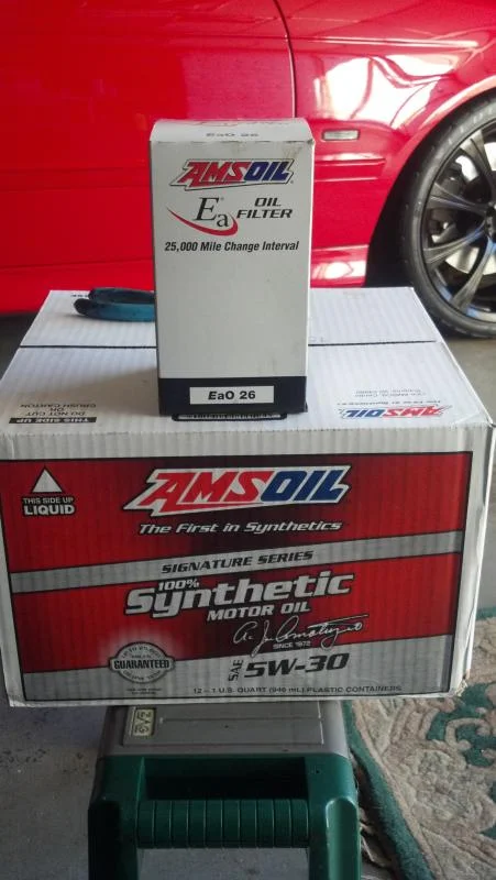

10 month 11k mile Oil Change
So it has been a little over 10 months since installing the Amsoil Dual filter system, 1 Full Flow, 1 By Pass. It took 10.5 quarts of Amsoil Signature Series 5W30
So 11,209 miles later, it time for an oil change. I did not want to wait until the middle of winter to do the next oil change.
The By Pass filter is changed every other oil change. I drained it and refilled it with fresh oil
The Full Flow Filter was filled with oil prior to install as well.
I also mailed off a sample for analysis..
Observations
1. Only added 1.5Qts of oil over this time
2. Front main seal seepage is gone
3. No excessive valve noise
4. Filter location kit has no leaks... excellent quality and design.
