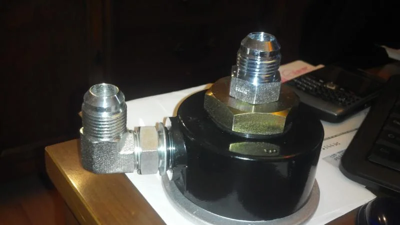

Block Adapter
1. Adpater assembled
2. Center Adapter
3. Outer Adapter
The block adapter also comes wth a extra plate for larger filters
Is the added distance/resistance to flow of any consequence?
I do not think that is a significant factor. The plumbing is pretty stout and should not impact flow.
I agree with you, Stu.
Your block adapter is quite different than mine - looks beefier.

where I can found this adapter .?
It came in a kit from Amsoil. This is an old adapter from like 10 yrs ago, or so. Not sure if you can get it anymore. The one Stu is using is the new or current adapter. The new ones look stronger, I'd go for the new adapter. Try this link: Amsoil by-pass filter mounting kits for more info. Not sure if Amsoil ships out of the USA. You might try e-mailing them.
Tapage, this is adapter I used. It say 3/4 - 16. Hope that helps

The filter adapter allowed me the flexibility to run the hoses safely back to the remote mount. As mentioned earlier I picked up a 45* fitting for the return line (Center fitting) which made things easier as well.
The toughest part was to tighten down the fittings. You will need 2 stuby 1" wrenches to completed this. :beer:

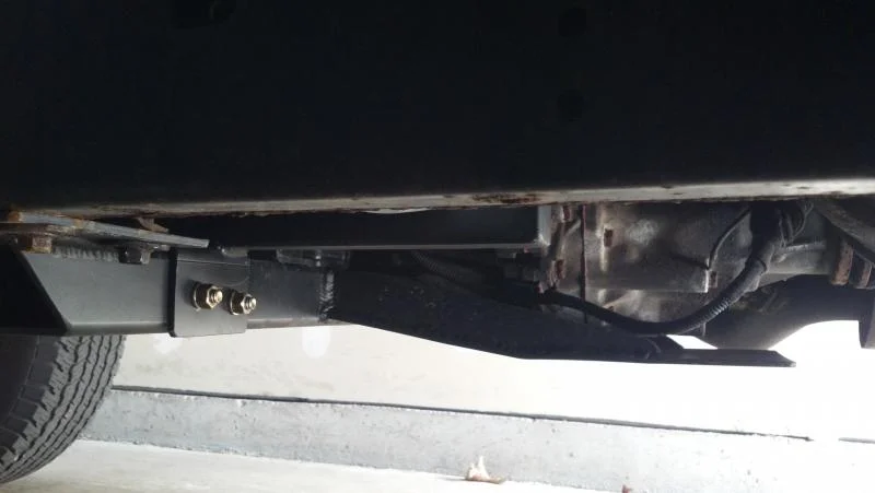

Final Install Pictures
2 Pics on the Block adapter installed. The out line run closer to the block. The return line, aided by the 45* fitting, comes back from the inner fender side. Care is taken so it does not interfere with the Steering column
Remote Mount
The remount mount is high and tight to the body. Far away anything the trails may throw at it. I had the move the metal line a bit to make sure there would be not rattling or rubbing.
Clearance
I am considering adding a protection plate from the Frame to the bottom of the mount. There are 2 captured nut in the frame that I can use. Possible over kill???
