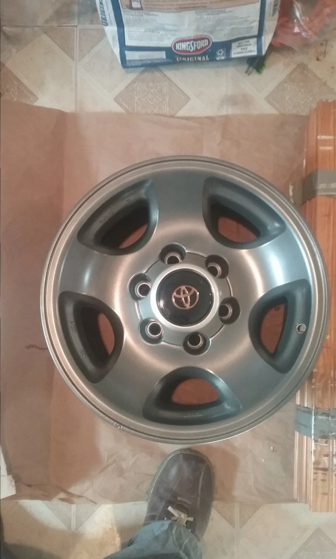

Not really and I didn't mind because I was going to paint them anyway. I am at work now, but I think I have some pics at home that I can share later. If you are going for the polished aluminum look, I am not sure my method would be the best route, but I would be curious to see if anyone has clear coated them after doing what I did? I think you would need a sealer of some sort though because the raw aluminum is going to oxidize and look dull fairly quickly.
EDIT: I found a pic of one of the finished wheels. I think they look good.
