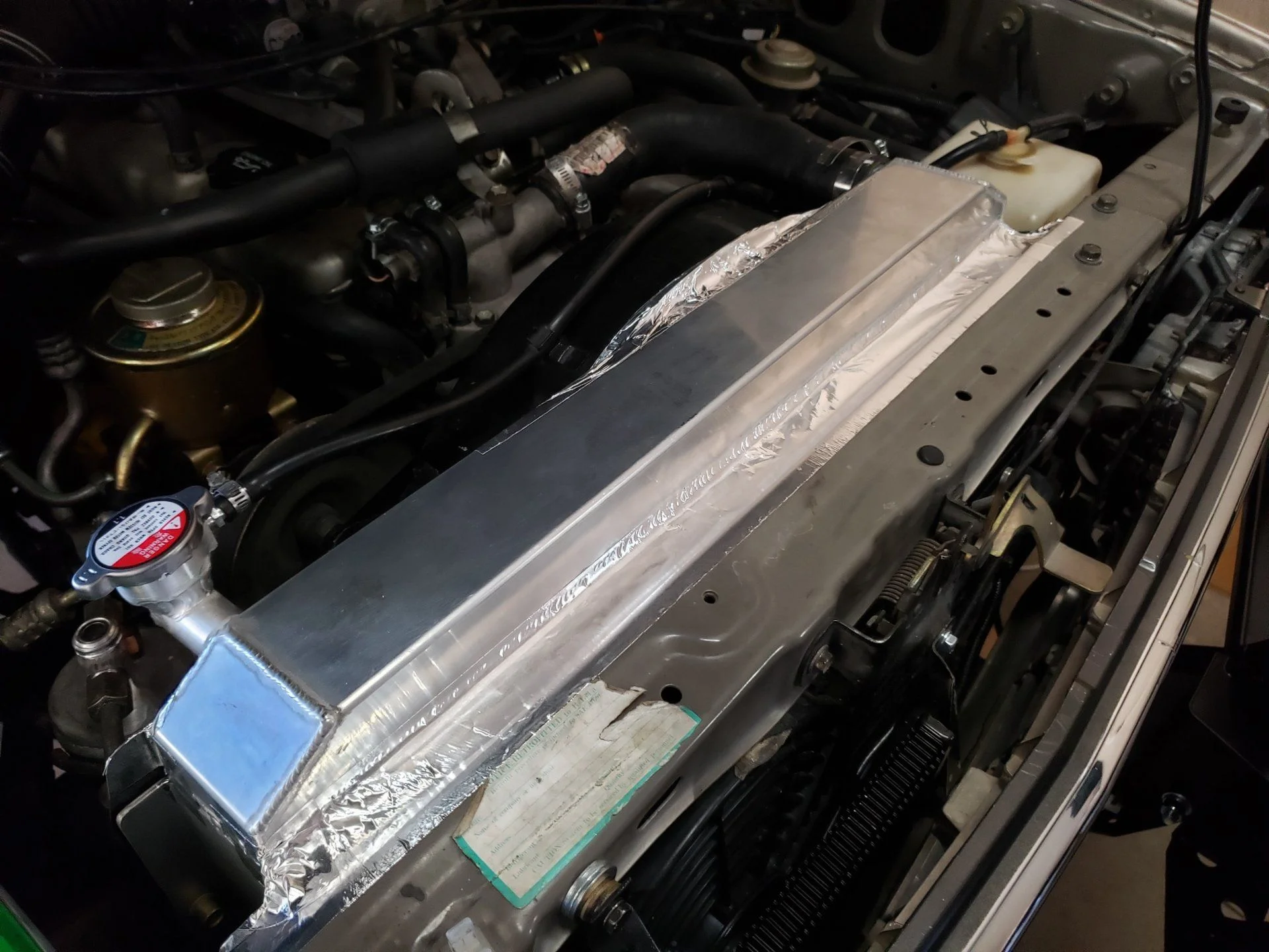

The fan shroud attaches okay, but with a bit too much air gap along the top arc. There is too much gap in front of the radiator that allows too much fan clutch-pulled air to bypass the condenser (and in my case, the secondary transcooler). This photo was my solution; aluminum furnace tape. This way the air is forced to pass the way it should. The gap in front of the radiator is only significant (about 1.5") along the top, not the sides.
