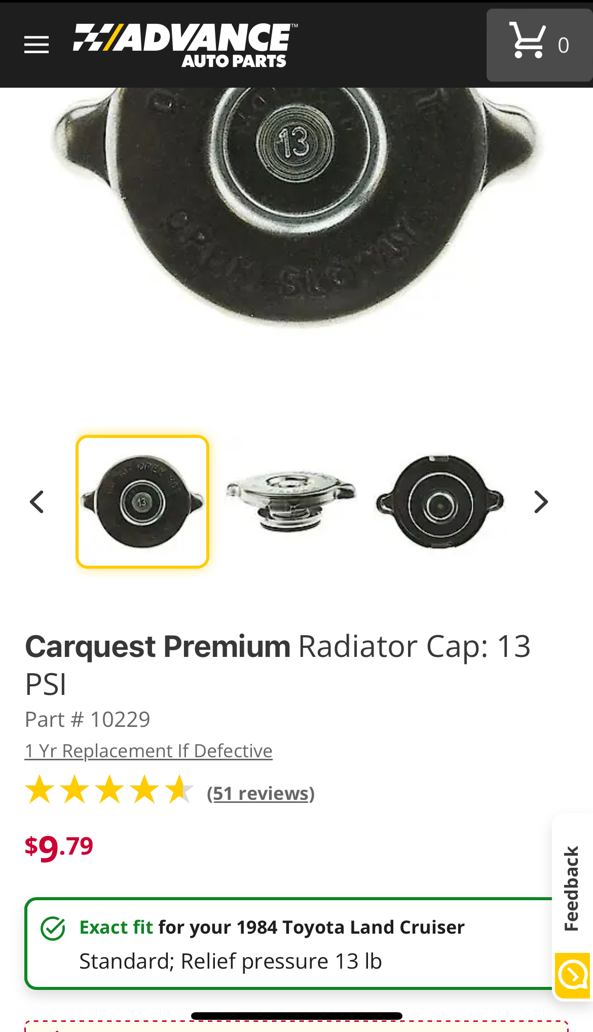

Does anyone know the p/n of this style radiator cap? It is on a 1984 FJ60 Land Cruiser with a stock 2F motor. It is leaking and I went to Advanced Auto Parts and they looked up the year/make/model and gave me a cap that was WAY too big. (p/n 10229)

There's a large style and a small style. Get one from your local dealership, or use the parts catalog to find the part number and order it from an online parts dealer.
The large cap was used until around 86, when Toyota switched to the smaller version. The 62 models also uses the smaller cap. It appears the radiator has been replaced and uses the smaller cap, Toyota P/N 16401-54750. I had the same situation occur when I switched my 85 to a Champion Aluminum radiator.
