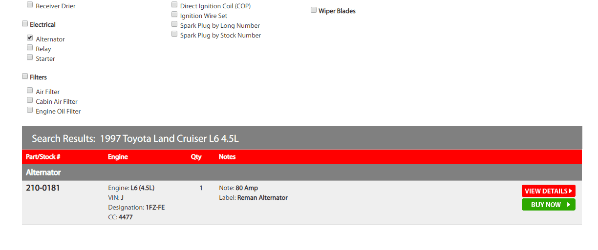

Do you have the part number handy? My initial search has not uncovered any "new" Denso. Only reman units.
I found our invoice. My error in noting it was new. It is the same part number you have listed 210-0181. Looks like I paid 178 including tax for your information. Read notes below and agree with the Kernal on different options and rewinding question. Another reason for just replacing. It was available from the local supply house from our shop. I do a lot of work with our shop. They are tremendous help in many ways. Let me do some work but also work on our Toyota's when needed. They will also get me parts that don't come from dealer.
Sorry for incorrect information on new but remanufactured should work for you. Working for us.
