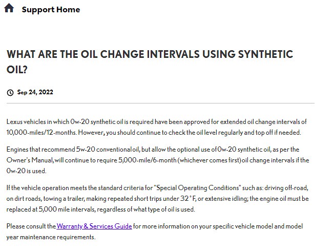

~25 years ago was getting new tires put on the Ex's car and the shop had a couple of auto trade rags in the waiting room. Read a great article on the move away from 3K oil changes it was started in California by environmentalist groups. And of course spread from there Country wide. I eventually went to 5K because I tick every box for "Special Operating Conditions" so not doing 10K and never will

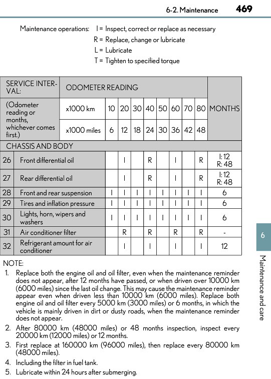

But if you look at the rest of the world for the Lexus GX 460 and here is the owners manual for Dubai
Dirt or dusty roads oil change is every 3,000 miles.
So this Salty Dog says this comment:
"I feel like older drivers carry with them decades-old "conventional wisdom" that is unnecessary, outdated, and in most cases invalid and illogical (e.g. the 3K mile oil change interval)"
Is illogical LOL.
Is illogical LOL.
Virtually all of us drive 99% of our miles on paved roads, even the "built rigs". There are, of course, exceptions to every rule, but the US road system is hardly representative of Dubai's environment. There was a time when 3k wasn't just for extreme environments. Yeah?
We have a clinic in Dubai it is very civilized and lots of pavement LOL. Not as primitive as some may assume and I don't spend near 99% of my time on pavement here. With the taxes I pay you would think they would pave more of the roads though.
They don't have to worry about most of the other special operating conditions it doesn't get that cold there. In fact environmentally it is kind to engines compared to Mn. Haven't been to Dubai since the war in 91 when I brought home a full page add for the new Middle East Land Cruiser

It took awhile but I have come to embrace 0W-20 synthetic oil for the GX even in the cold of Mn. 10K oil changes? Not going to happen here, basic engineering principals of wear and lubrication in environmental conditions haven't changed, even with Unicorn tears.
So in the 44 years since the last Iron Pig rolled off the production line, no engineering advancement in metallurgy, casting, machining, oil flow, oil passage design, CAD drawing and design technology, oil composition and additive advances have resulted in a retail automotive engine that can go longer than 3,000 miles without an oil change without significantly shortening its useful life? I find that hard to believe. I mean, you do you and all, but I'm totally okay with 10k mile intervals on engine oil.
