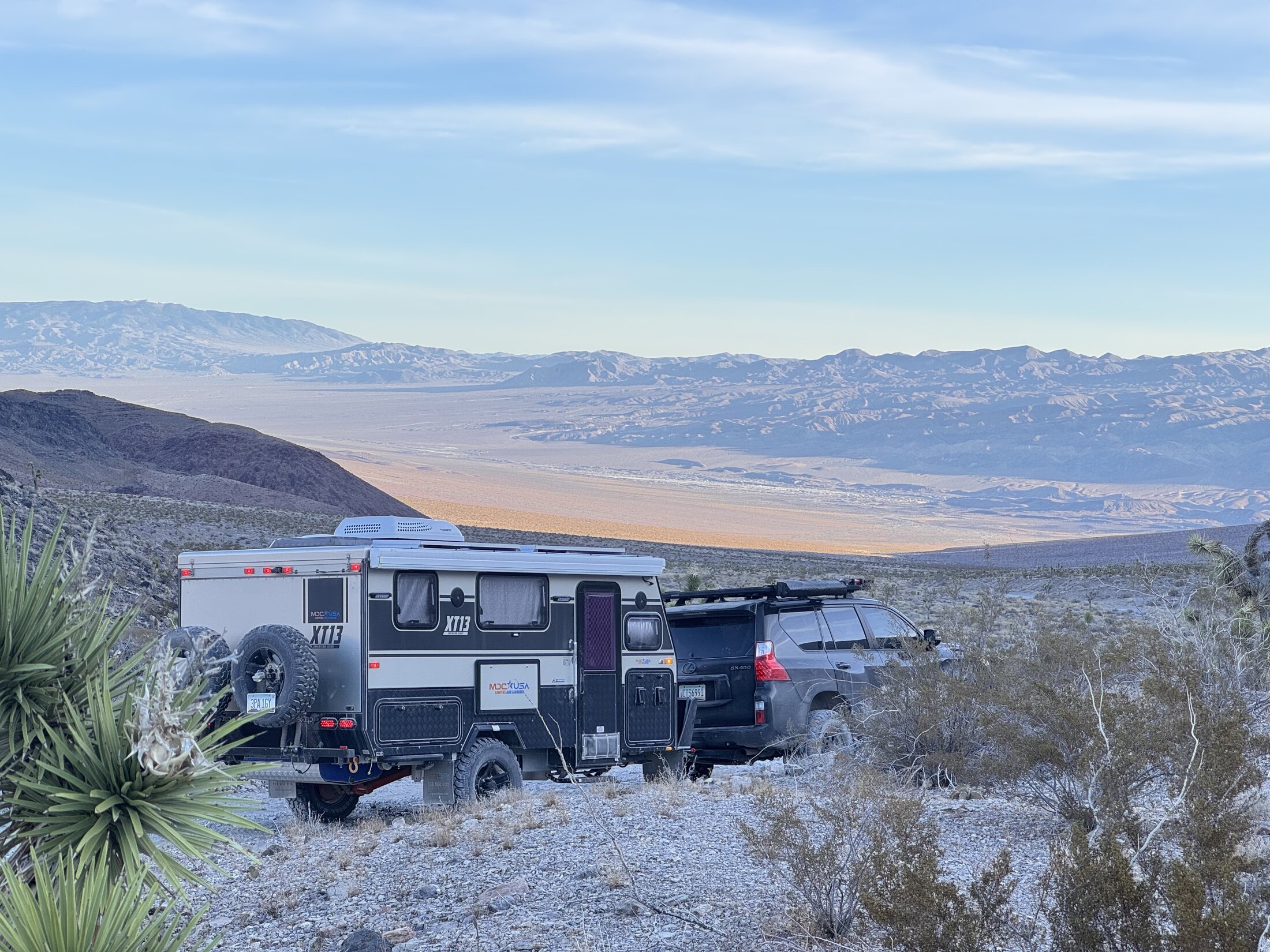

Heres some illustrative imagery:
“Oh what fun! We’re on an adventure of a lifetime”
“Oh isn’t this cool!!”
“Wait… why does the milk smell like baby puke? Oh crap… the nearest oulet it over that next range 🤦‍♂️
