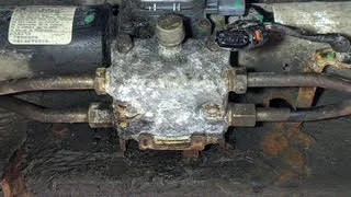

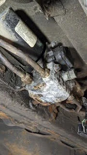

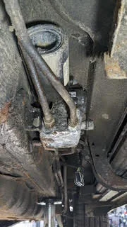

The KDSS control piece isn’t usually the leak point from what I have seen.. it is generally the stabilizers on each end of the vehicle.
It’s all really speculation on issue without codes though if no leaks present

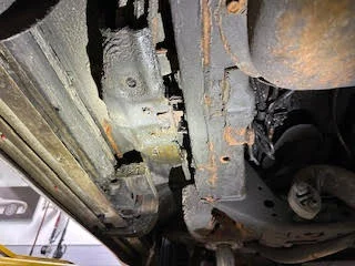

Behind that cover it could be massively corroded on the electrical. That area can hang onto dirt, small rocks, sand, etc,

Thanks. it sounds like it might be easier and cheaper to change one of those out, so was just prepping for worse case scenario. As for the cover, the vehicle fits the bill of being corroded under the cover because it was undercoated a lot in salt country, and the owner was not the type to ever remove the cover to clean. So as good the frame looks, it could be corroded under there.

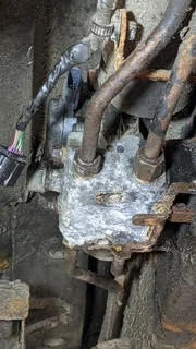

Stabilizer Housing Sub-Assembly 48006-60031 is leaking . got a quote 16k cad to replace everything . bought to local mechanic he said buy the assembly and i will do it he has the equipment for it . mostly due not rust and rocks stuck behind shield that damaged the unit . also i saw liquid under car from drivers side . see pic

Do you see the potential sign of leakage at those bolts on the shield? But yeah, it's as clean as it can get
No, but I don't do my own service. It's cheaper and doesn't take time out of my day for my mechanic to do it.
But... I have an excellent mechanic and he keeps me apprised of any leaks, or anything that may have potential of being an issue and he has never pointed out an issue with that. So I guess to answer your question, I/he does not see a potential sign of leakage.
cmattina thought he saw seepage, indicating a potential leak, around the bolt holes in the photo he posted of the car he wanted to buy. He was asking if you also saw leakage in that photo, not whether the bolts on your car were showing any leakage.
Ahhh... No, personally I do not. But the best way to tell is swipe one's finger across and see what comes off.
If it's moist, damp dirt, yeah, probably some seepage, but unless it's "wet" and/or dripping, for me, I wouldn't worry about it.
