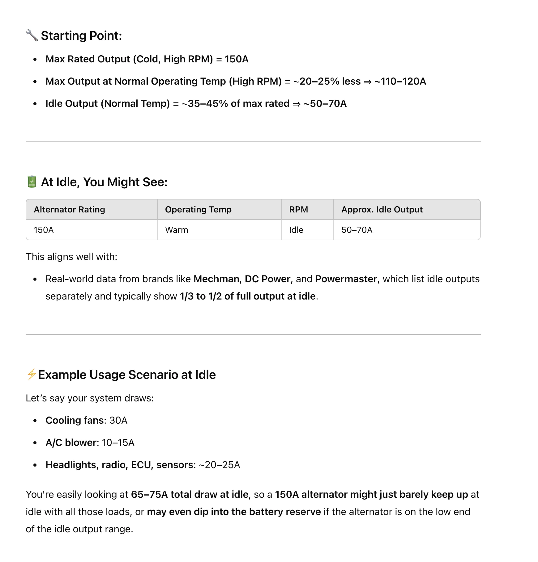

Setting up 6awg with realy back to trailer and it has a dc to dc. Wondering how much amperage I should expect at idle with all my lights and electrical in the truck off. I have the larger 150amp alternator they put in the dual AC models.

Probably easier to borrow a clamp meter and measure it. They are definitely not great at idle.
Just a general rule article
"So if an alternator is rated at a maximum output of 85 amps, its normal operating temperature maximum output is likely closer to 65 amps. Then at idle, its probably much lower—perhaps only 30 amps. With a pair of electric cooling fans that could easily pull 30 amps and an A/C blower fan at max speed requiring between 10 to 15 amps, it’s obvious that this has more than maxed out that 85 amp alternator at idle. "
It could always be AI Hallucination :) ...but it says for 150AMPs

@Acrad God I love Chat when it works. I never think to use it outside of work. FYI - You can tell it "don't hallucinate and cite you're sources and it will. In this one it cited Lexus parts pages and iH8tmud. Probably citing you : ) Here's what I got:

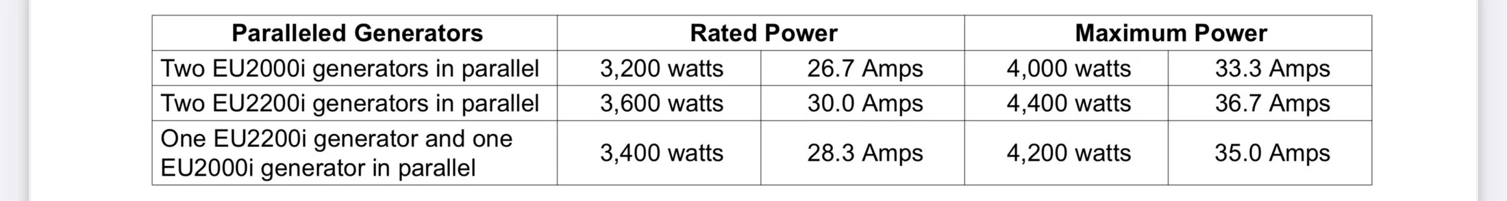

Respectfully…disagree… I’ve had (2) EU2000i’s since 2009.. great backup home generators. You can even parallel two together to double up the power.
No.. you aren’t going to run a large heat pump or AC but will gladly run a natural gas furnace, refrigerator, freezer, etc
