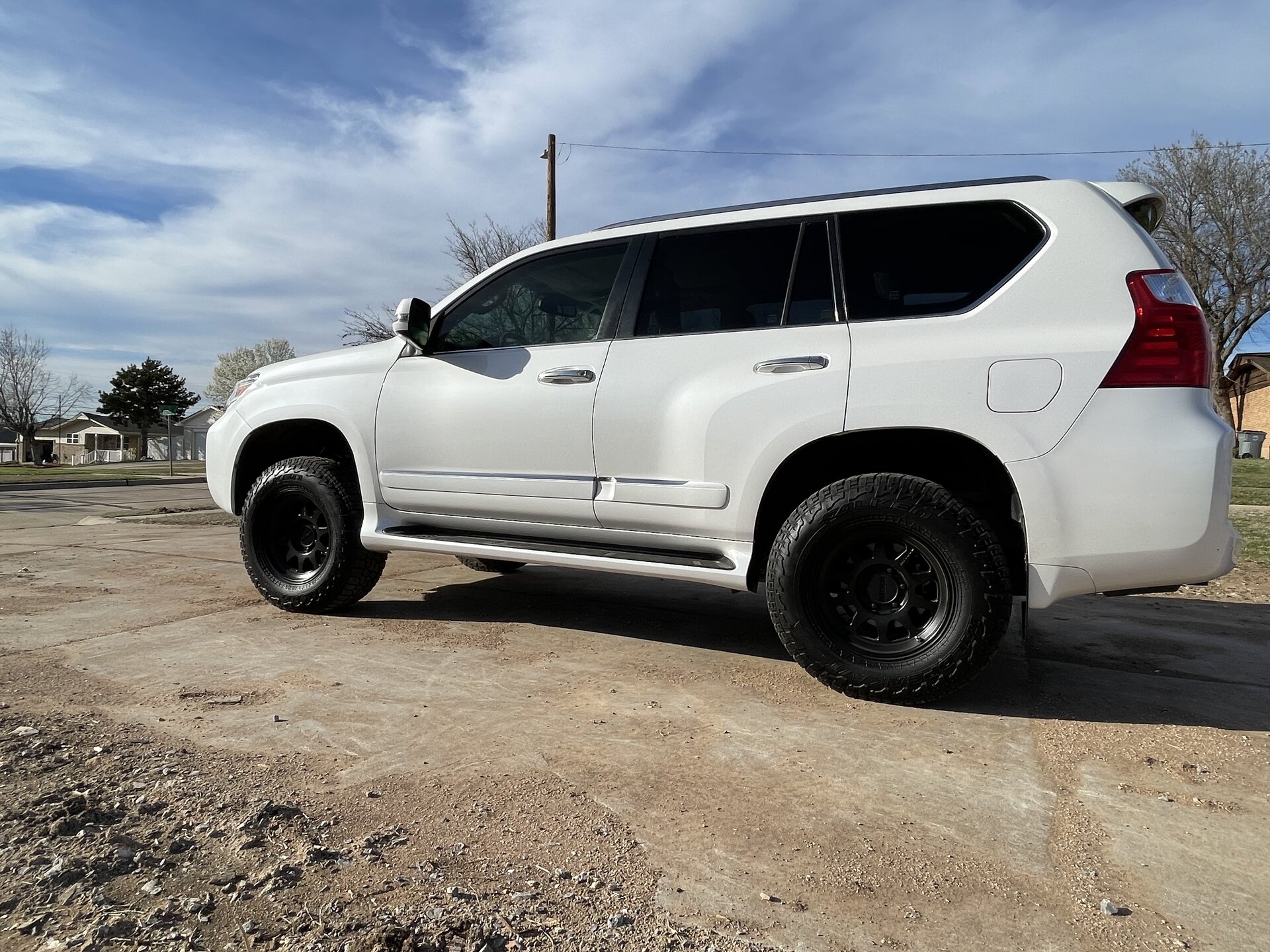

Installed these long boys this morning. I’m hellbent on keeping my airbags for some reason. Figured I would do it right instead of “tricking” them to lift the rear.
Shipping from Australia took about 2 weeks, but arrived in great condition.
If you can change airbags, you can install these.

I did the same riding on fresh tricked airbags. Kept going back and forth about springs or bags. Obviously, I decided to make the airbag situation better than what I had.
Since installing the Airbag Man bags, the ride is back to where is was. Smooth and not rough at all. I’m sure if I swap out my OME stuff for Dobinson or similar, the ride would be that much better.

Well @kody472 , got it all finished today! Only problem is, the rear looks like it’s sitting much lower than the front 🤔 I did opt for the 3in lifted coilovers, but was trying to go for a leveled look. I did add the airbagman spacers, as instructed, and the bags do raise/lower the truck. Not sure if I should have the front lowered some or maybe add some washers to the height sensor?
Yup! I added the second set of washers and it’s MUCH better. Now to figure out KDSS lean lol
Awesome! Can’t help with that. My GX does not have KDSS. Good luck man.

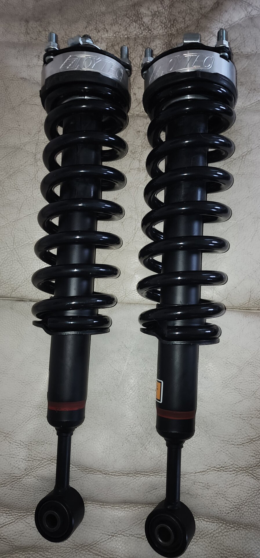

Great job on the Airbagman's! After lots of debate, I'm going with the extended bags and keeping my stock suspension. I bought an '07 with 135K. I wanted to get all new suspension and anyway, so, I put in a Toytec 2" preloaded spacer in new stock front coilovers so a can keep my dampening control. For the rear, besides the extended airbags, I'm using stock rear shocks minted to a 1.5" extension bracket (made for the Prado), that way I keep all the stock suspension and get 2" of lift front and rear. I have 17" Mamba M14 wheels with -12 offset, so I'm hoping for 33" wheels (255/80 or 265/75 or 285/70). I what to keep my running boards too, for now. Think the wheels will work without cutting body mount?
The offset might not allow that size without trimming. May need to go 0 offset.
