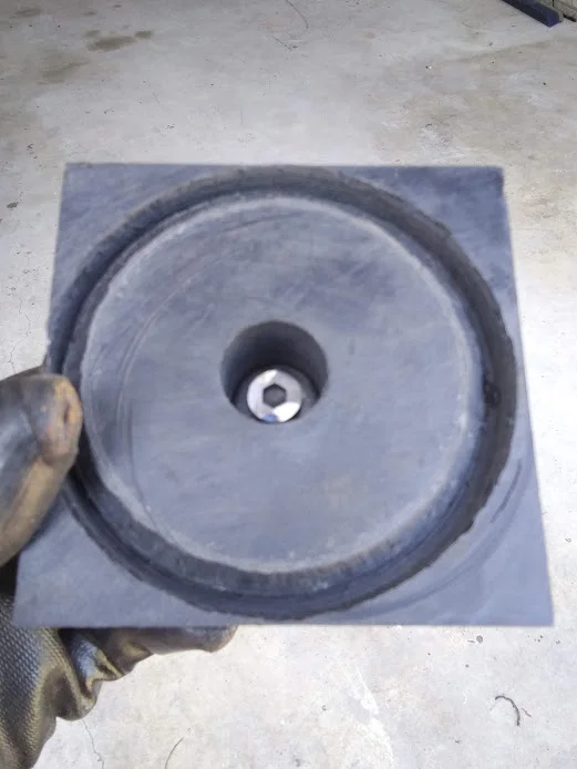

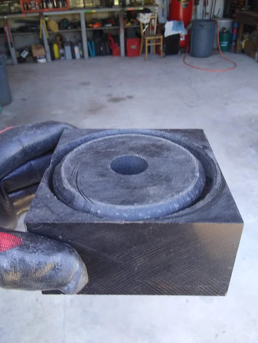

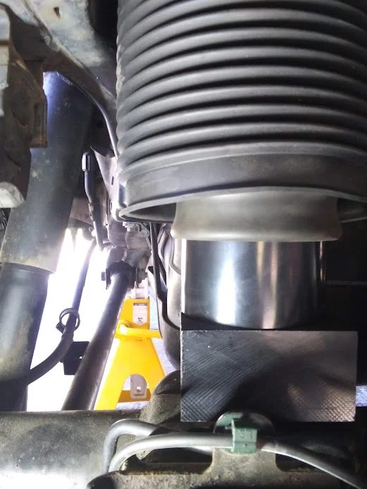

I recently posted this on another airbag thread. Thought I'd repost here since the other thread hadn't seen recent activity.
I fabricated some rear airbag spacers fairly easily from some high strength ABS 2"x 4"x 12" bar stock. The minimum bar length was 12" from Mcmaster-Carr. I used a 4x4x2 piece and left it square to provide a more solid base for the spring to seat on. I drilled a circular channel using a 3 7/8 then a 3 3/4 hole saw on a drill press. I went about 5/16" deep. I beveled the inside corner of the channel to accommodate the weld bead on the inside of the air spring base. In the center i used a 7/8' spade drill bit to make a hole for the locating nipple in the center of the air spring base. I drilled the 7/8 hole deep enough to accommodate the nipple with room for a bolt head below it to bolt to the axle pad. On the bottom of the spacer i used a 75mm forstner drill bit to create a circular indentation to seat on the circular raised portion of the axle mounting pad. I used a dremel to bevel the outside edge of the indentation, to match the angle of the slope that descends from the flat center portion of the mounting pad. I'll include some pics to clarify things a bit.
