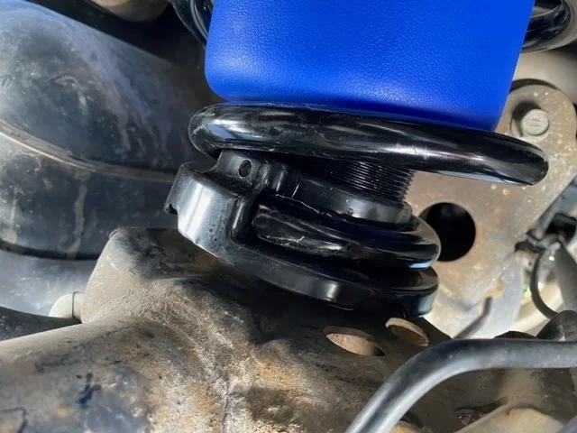

2) So, I ordered the adjustable airbag delete kit (perches and isolators) from Ironman. These the *adjustable* perches that screw into each other, so you have a safe 1" or so of adjustment (height, or lean if you have lean, etc). I don't have KDSS so lean was not a factor for me. Also ordered Metaltech's Super Spring (15% extra tension over Toyota OE 4Runner/FJ springs - designed for the weight of the GX's badonkadonk). Got those in stock height, unsure of how much lift the Ironman delete perches would add to 'stock height' springs - and no one could give me an answer. Easy install and we added about 1/2" lift from fully-bottomed on the perches to get 1/8" rake back into the truck front to back - again with the front end up about 1" on the 5100s.
Side-note: I also ordered some 20mm coil spacers from Ironman in case it all ended up too low and didn't need them - with the perches screwed back down some 10mm spacers would have worked just fine. Might add them in if the springs settle, rather than go more than 1/2" on the perch adjustment.

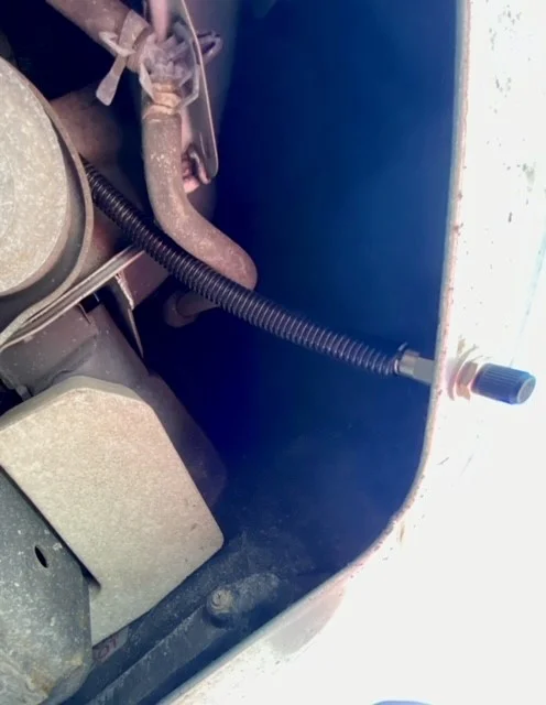

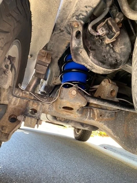

3) Added Firestone Coil-Rite bags inside the coils (W237604135) and plumbed air lines out to the rear bumper - for towing/loading heavy.

Adjustable perch
Terrible angle but drivers' side air mount
