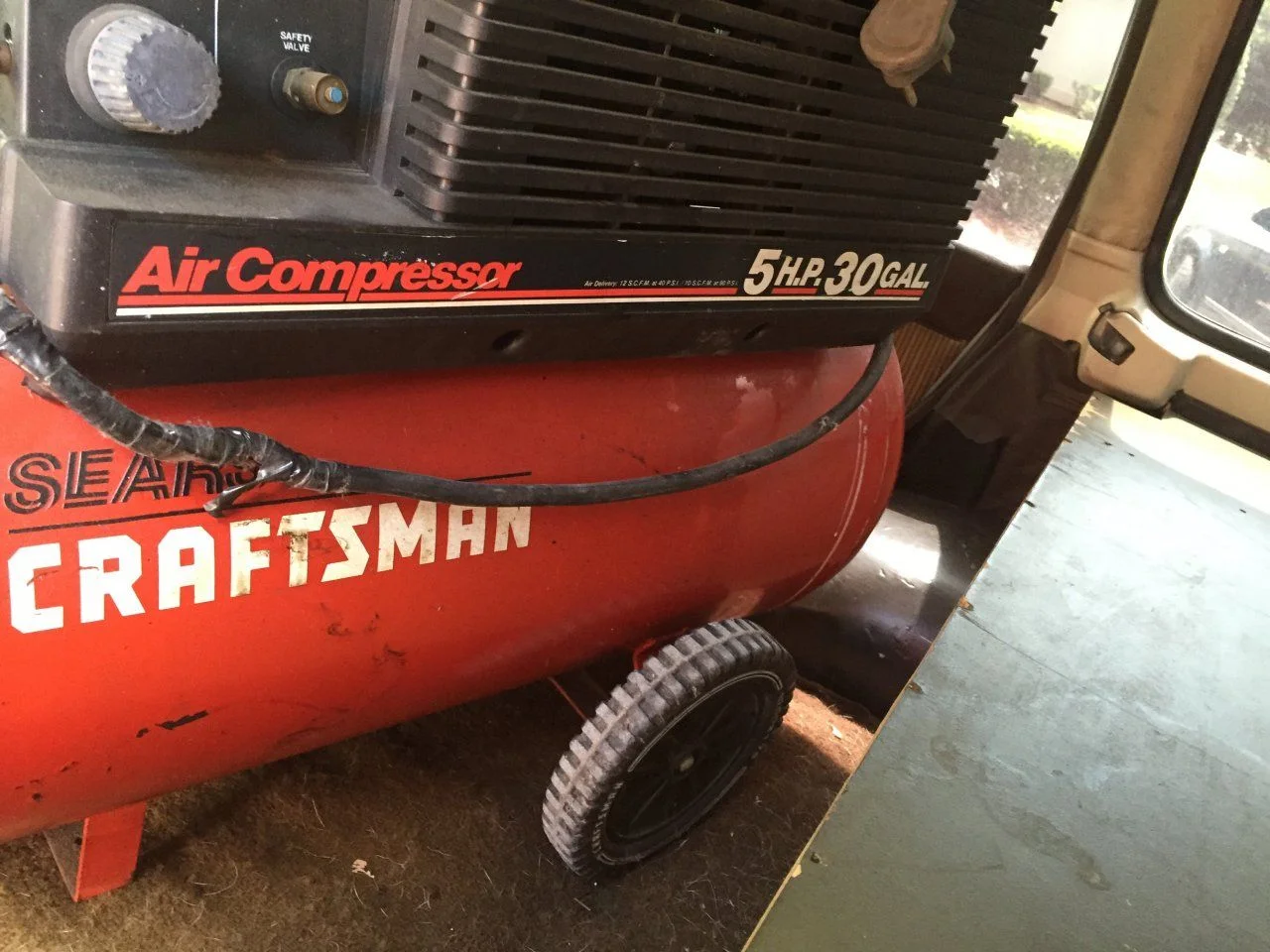

Ok just to close the loop....
I bought myself a used Craftsman compressor, to use for weekend bodywork/wrenching and ultimately to paint my fj40.
220 volt
5 hp (oiled)
30 gallon
12 scfm at 40psi
10 scfm at 90psi
125 max psi
Not sure if it's a single stage or dual etc. it's stuck in the back of my truck until I clear up garage space and some suckers that enjoy beer... That mofo is HEAVY!
Hopefully it will support my light needs... I take that back, hopefully it works period... I took a gamble, but the seller seemed legit but his new shop didn't have a 220v outlet, which is why he was selling it.
In the next 6 months I'll post back on performance using a DA, block sander, HF purple HVLP gun(primer) and HF professional HVLP spray gun(base/clear).
One less excuse to couch wrench... Time for action

You might have enough air for paint (might), but definitely won't for most tools. A DA sander uses a lot of air.
Does it matter how the condensng hose is oriented? Does it need to drain back to the tank?
I'll need to do some research on that one. I've seen some neat ideas on the garage journal (thnx @jblueridge, there's some good ideas all over that sight!) that removes condensation by running long zig zagging air lines on the wall. kinda the same principle that @Heirloom suggests.
I admit that my compressor is still in the backseat of my sixty, super heavy and haven't figured out where it'll live...
Once I try it out ill post a mini review.
Your probably right, lucky for me this is a monthly hobby, so all my work is usually time boxed to an hour or two max, therefore most projects are short.
