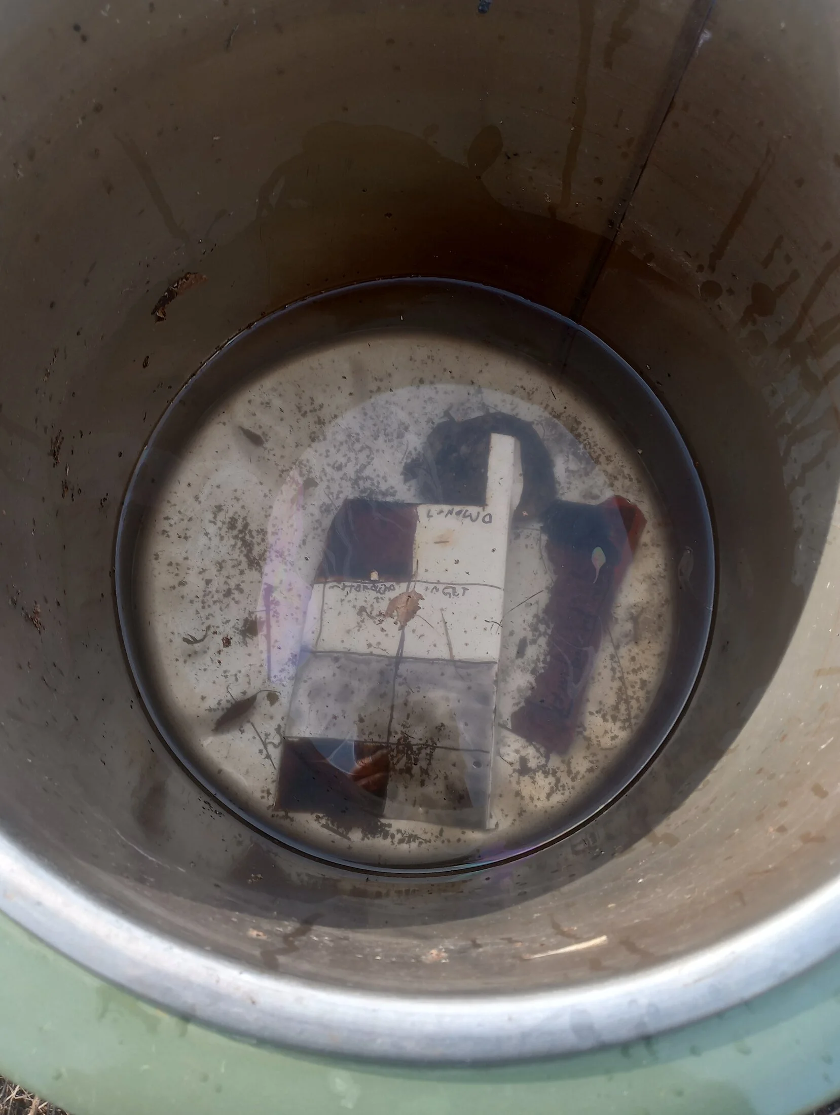

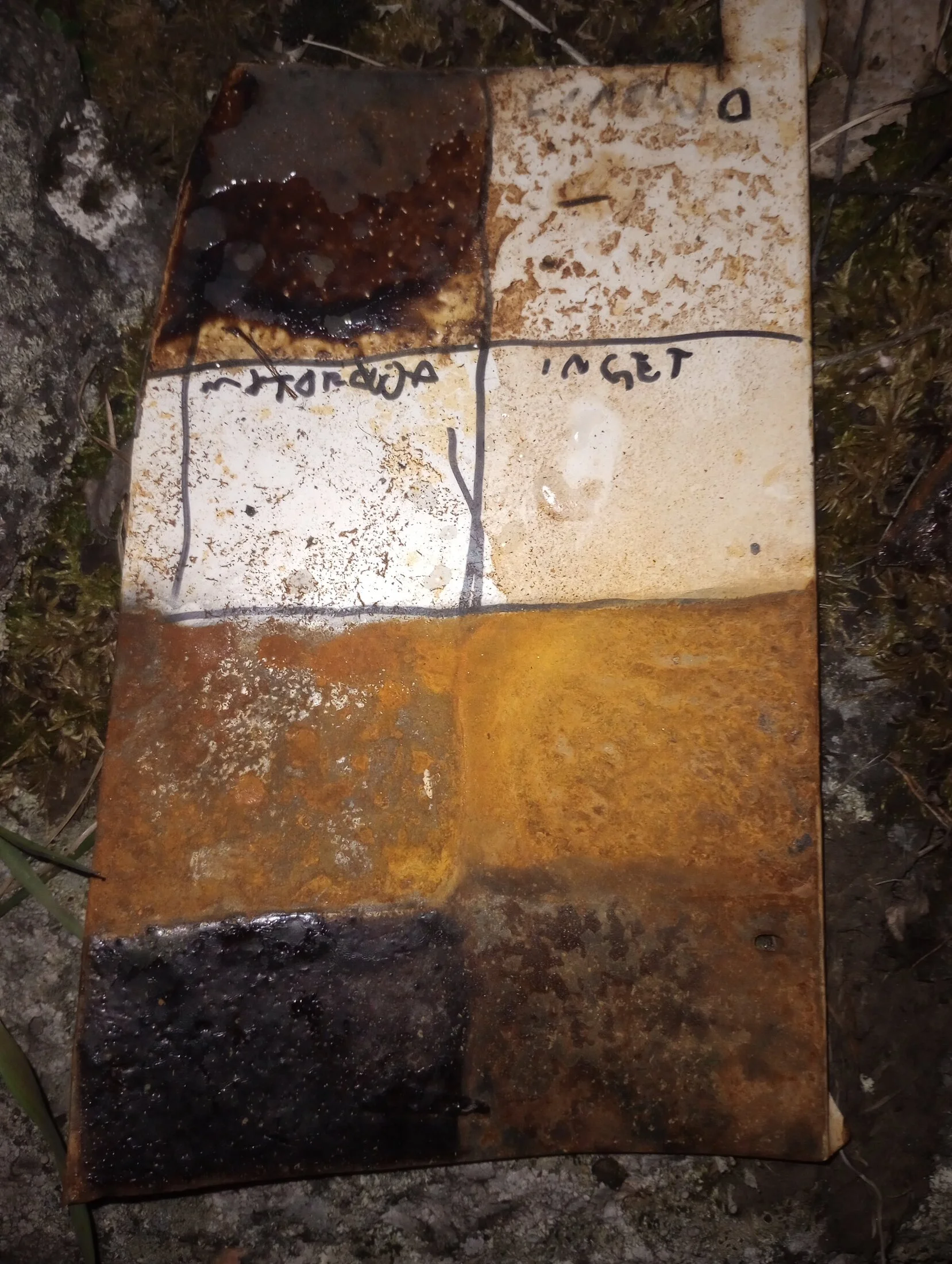

The experiment consists of coating painted, bare and rusty sheet metal with each coating.
The rusty piece is real 70 series steel, and is coated on both sides to avoid skewing the results by rusting from the backside.
Those are then put in a tub of very salty and slightly dirty water until we get a result.

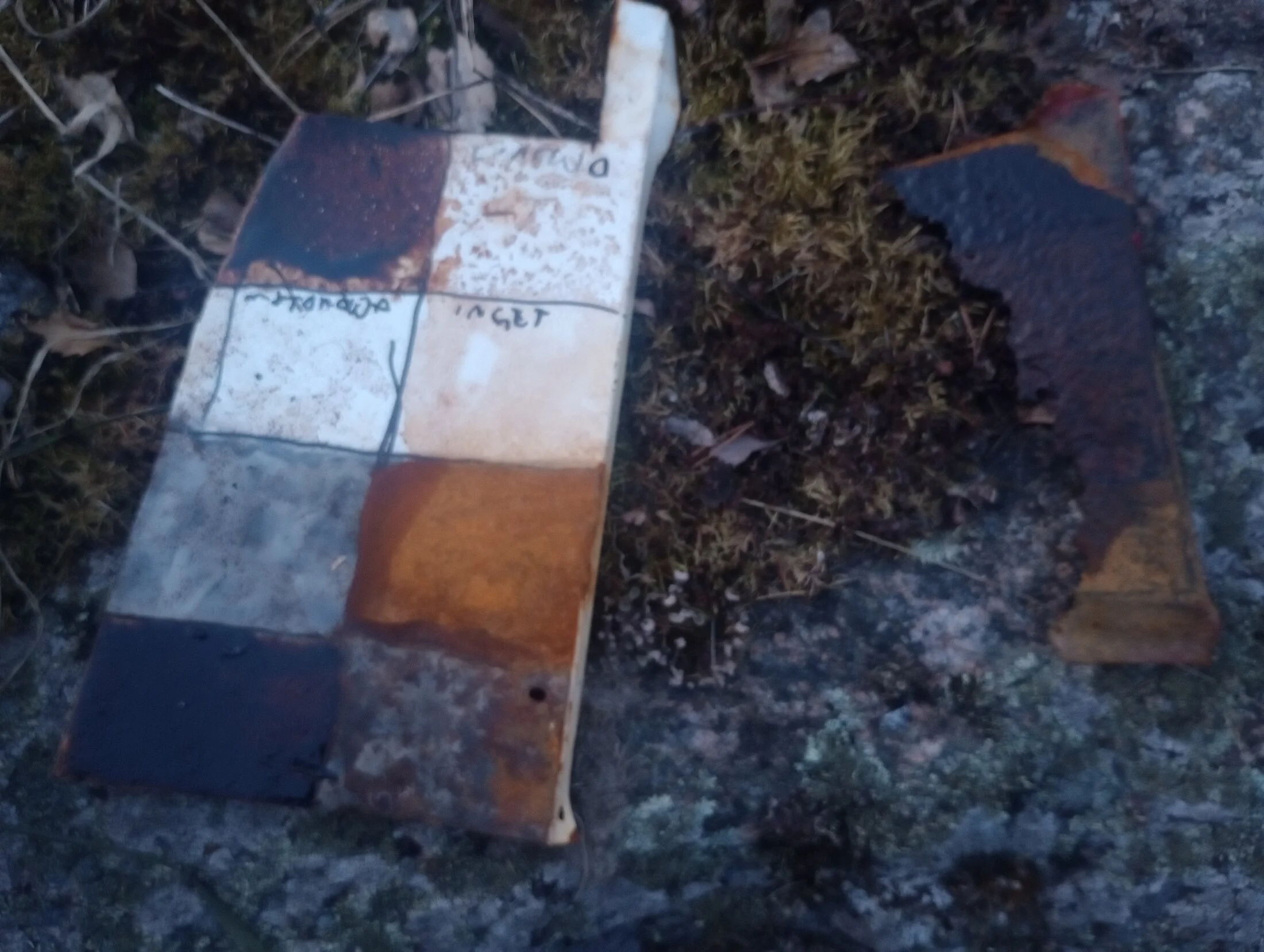

One week update:
To better simulate realistic circumstances I've decided to have the pieces out of the water for a while. They will be on this rock for at least a few days, but probably until next sunday just to make it easier to keep track.
The rust on the painted parts and the oiled unpainted parts is 100% in the water that hasn't dried off yet. The painted but untreated part has the rust stuck to the paint though, while on the oiled parts it's just floating around in the water.
The bare untreated metal has caught a lot more rust, but it can be removed just by touching it. I'm not sure if it's because they've been submerged or if it's because it hasn't rusted yet and is just much better at catching rust from the rusty piece.
The rusty piece hasn't progressed much, not even the untreated part, but there has appeared a tiny hole in the linseed oil part.
I have found another contestant for test #2: red lead paint, used on boat hulls. It's illegal in Sweden, so it must be good, right? It's a fair bit more expensive at 50€/l, but as it's a paint it should never need reapplying.
Now that the water has dried off I noticed something interesting: on the painted and bare piece, the engine oil is wet and sticky (as you'd expect plain oil to be), while the linseed oil has formed a dry hard surface. On the rusty piece it's the opposite, the engine oil is dry and the linseed oil is wet and sticky.

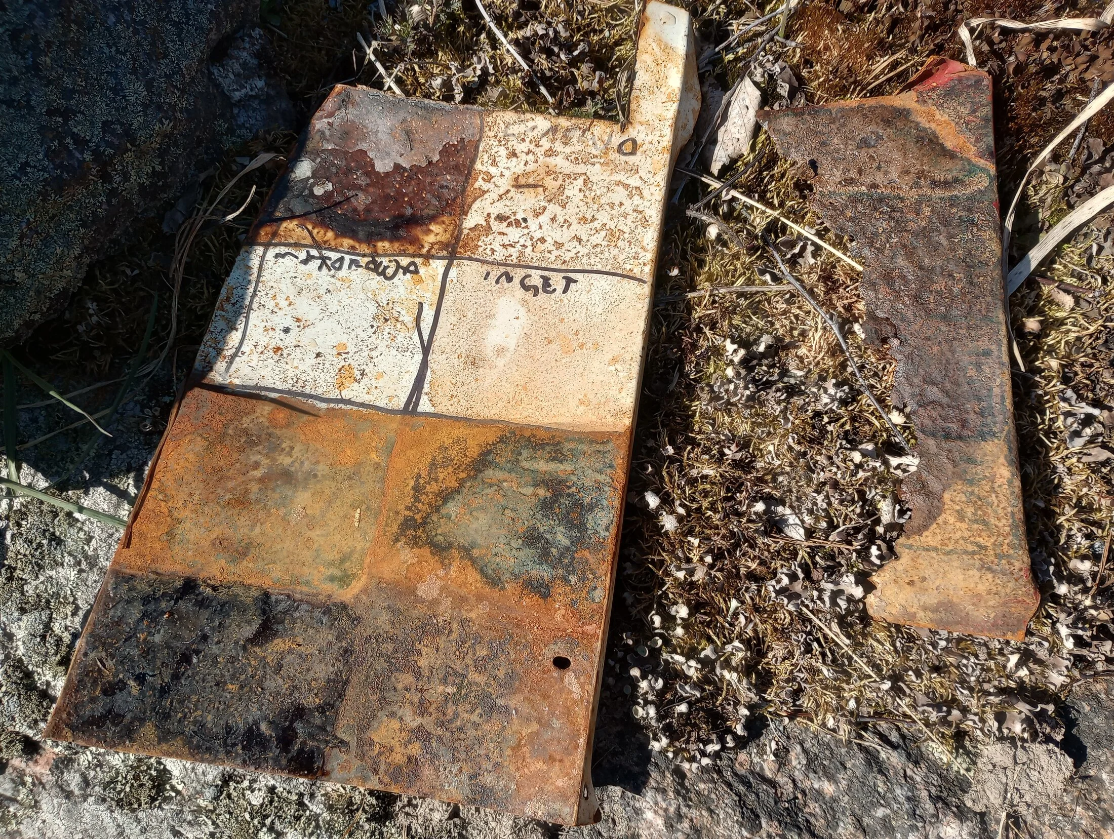

Two weeks update:
The bare metal with linseed oil appears to have started rusting. Hard to tell if the oil actually already has failed or if the loose rust just has stuck to the hard surface though.
The tar is dry to the touch where the layer is on the thinner side. Don't know if that's good or bad yet, but I'm pretty sure it's not hardening based on my previous experiences with tar. I have a can that's been standing without a cap for probably close to a hundred years and it can still be stirred.
I thought about doing some kind of abrasive test before putting them back in the saltwater but I couldn't come up with anything that would be fairly distributed and not way too effective.

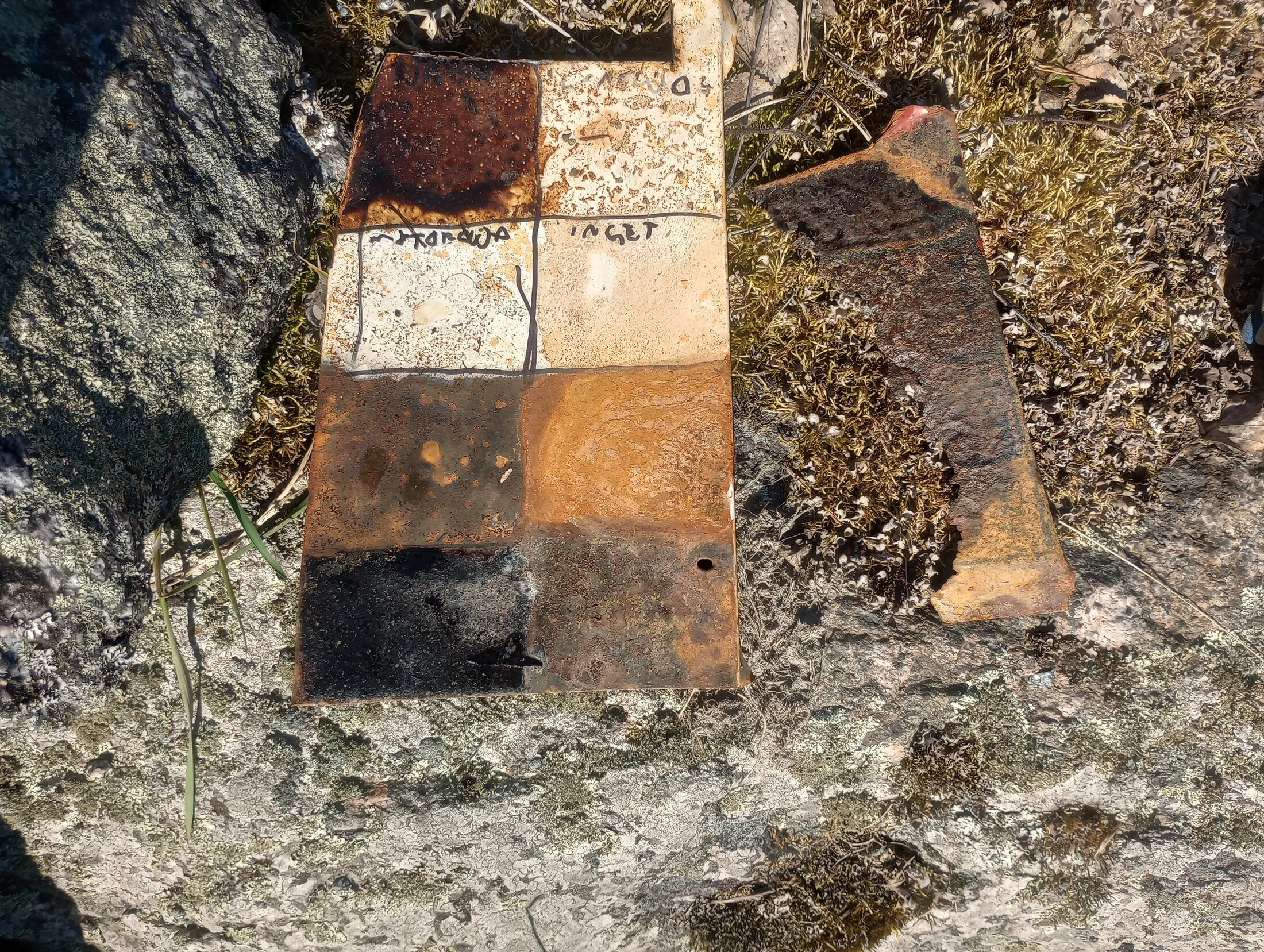

Three weeks update:
A layer of salt has formed over the pieces. There's definitely rust on both the engine oil and linseed oil parts of the bare metal, but the tar is still coping fine. There's no obvious changes on the rusty piece, except the hole in the linseed oil part has gotten bigger.

Four weeks update, only two and a half days late:
A lot of rust on the oiled and untreated bare parts. The hole in the rusty linseed oil part might also have grown slightly. Tar is still holding up fine, but the salt layer is still there despite quite a bit of rain in the last week.

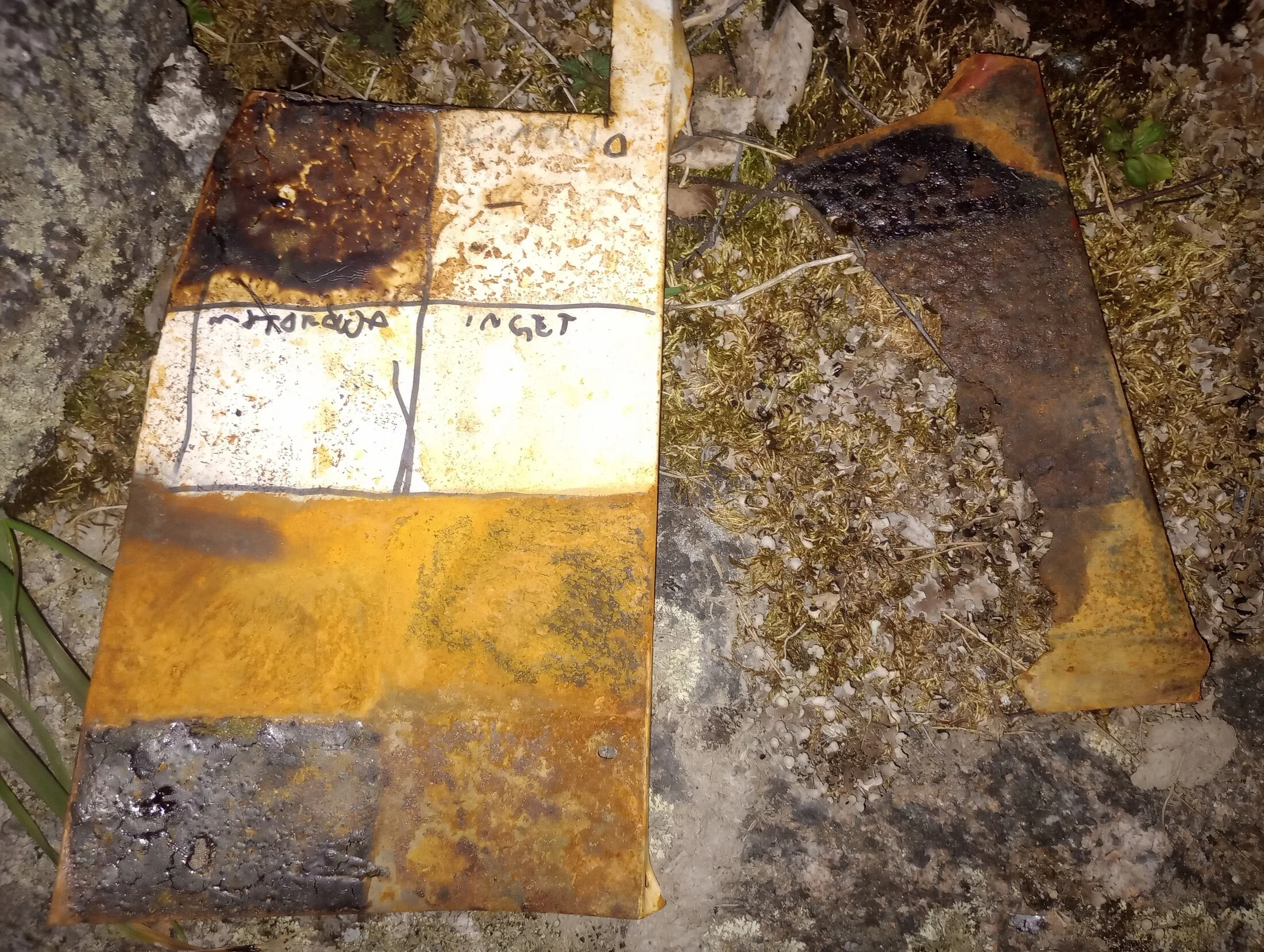

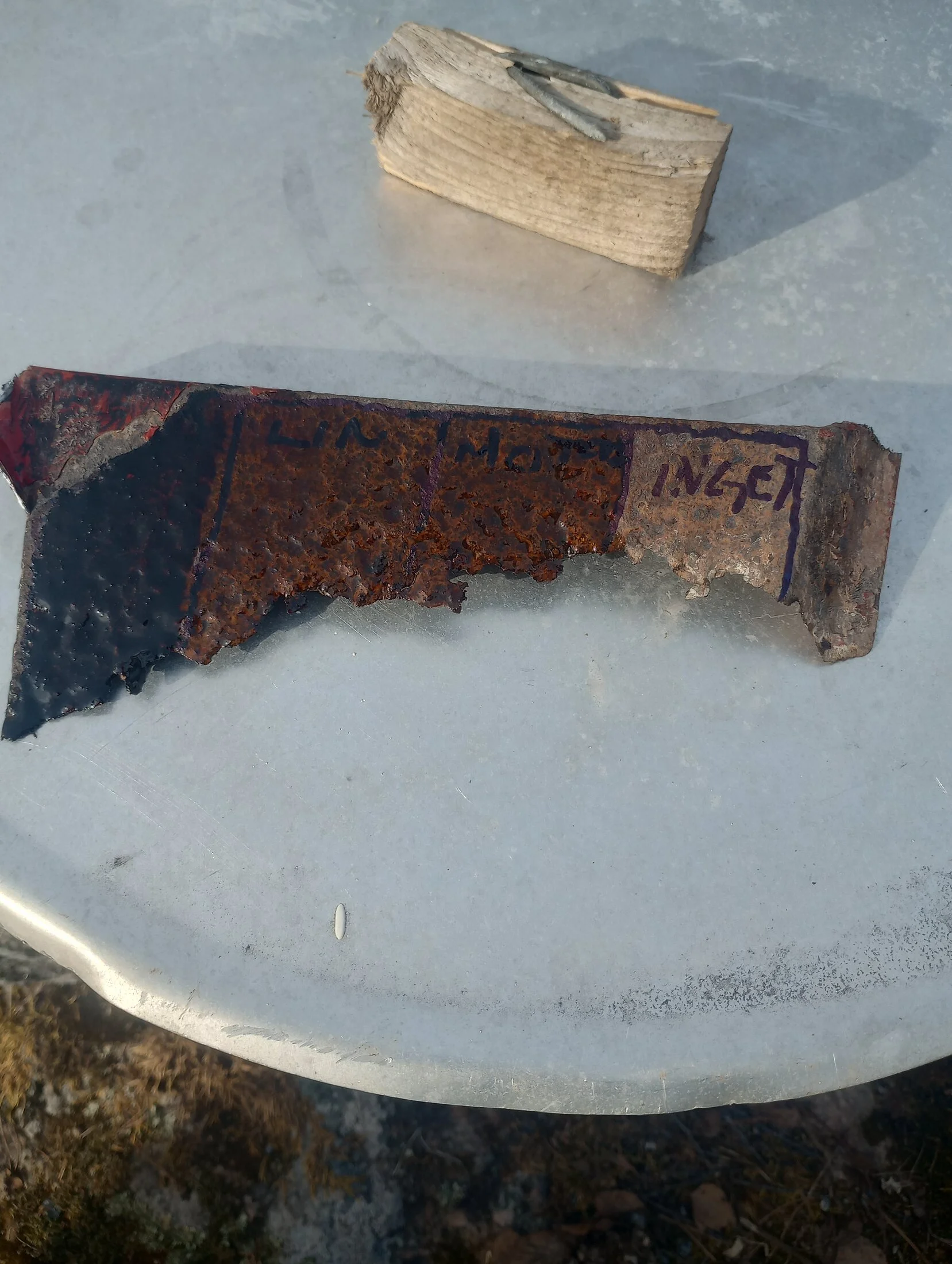

Five weeks update:
Apart from the usual hole in linseed oil on rust getting bigger there hasn't happened too much. The untreated metal is doing interesting things though. The tar is doing great as usual, but the untreated, engine oil and linseed oil parts are rusting in quite different ways. There's loose orange rust on all three, partly because the saltwater is full of rust, but the untreated part has formed a hard black surface and the linseed oil part is partly covered in a kind of plastic brown goop, with similar black surface underneath. The rest of the linseed oil part and the entire engine oil part has the kind of rust you'd expect from untreated metal.
All three tar parts are covered in a hard salt layer and are the only ones to be so. On the bare metal tar part the metal is still completely rust free, but the tar has gotten harder and thinner so I can't cover up the hole I just made to check.
I'm ready to declare the test done with tar as the winner, but I'll keep it going until I've gathered everything for the second test. Genuine fluid film doesn't seem to be available in any hardware stores, so I'll use this product from Motonet that claims to do the same instead.
Six weeks update:
Despite showing no signs of any oil left the oiled parts are doing different things. Linseed oil has formed a dark hard layer and if you scrape off the loose rust from the motor oil you find pretty healthy steel. The untreated part is the only one that has gotten pitted yet.
The tar is much harder than I would expect, but as opposed to Dinitrol it is very stuck to especially the rusty piece.
