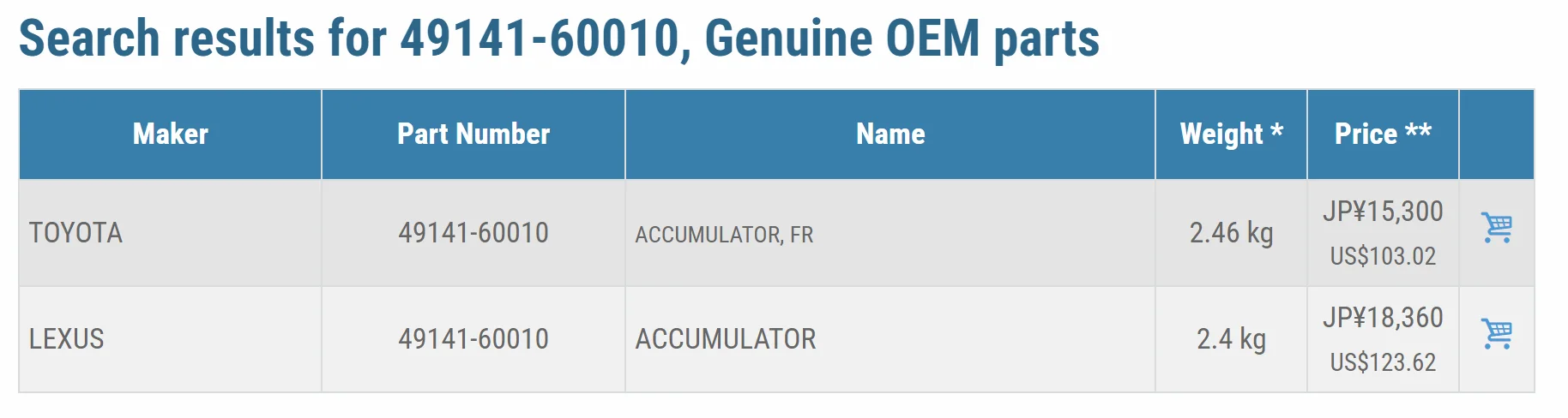

is there any reason to get the lexus globes over the toyota ones? (i ordered the height sensor, now kinda wanting to replace the globes).
Which height sensor did you get? Are the other two confirmed good?
There is no reason to change the globes unless the old ones are bad. First get heights and pressures right, then check globes by counting fluid use (markings on the reservoir). Then you will know the state of your globes.

So funny, the "Lexus" is 20% more for same part. They're the same, even the box likely the same.
lol that's what i thought, but just wanted to make sure. i also thought that aisin parts were identical to toyota aisin parts, but it sounds like that's not the case so I didn't know what to believe! the screenshot if from impex japan - have you used them before? that globe price seems too good to be true.
