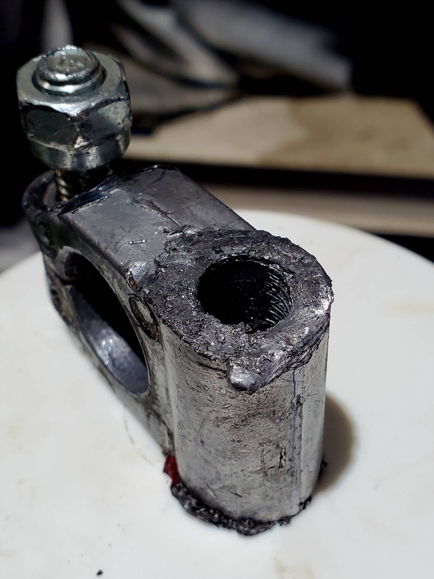

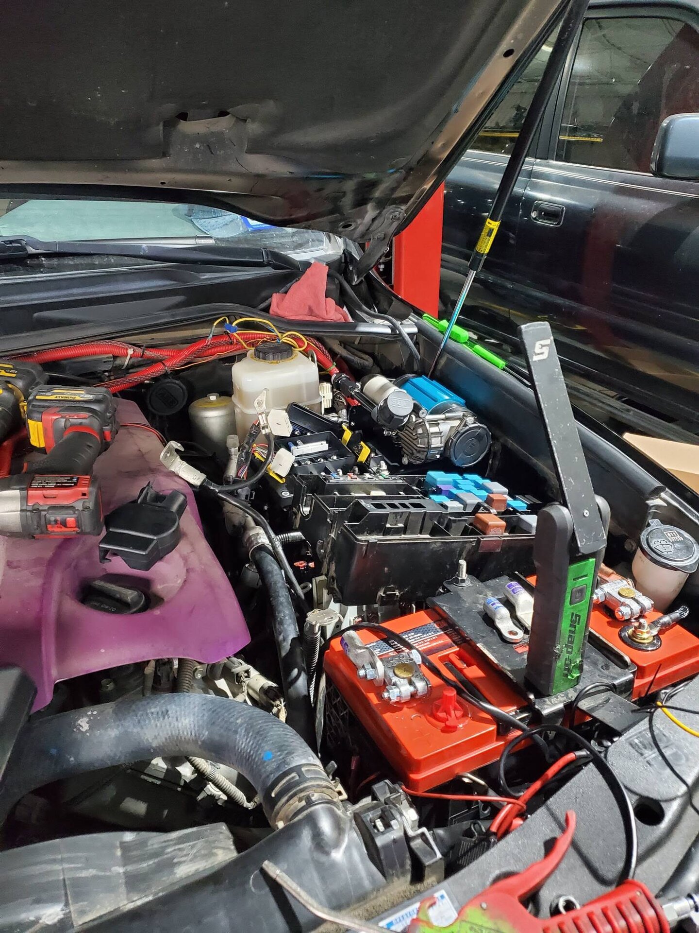

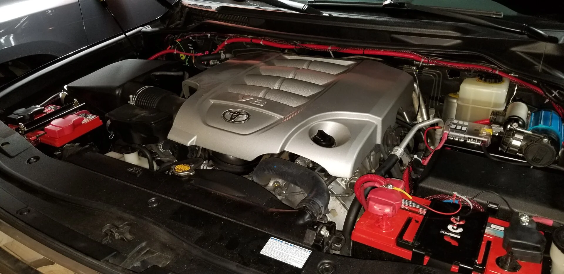

I added a dual battery setup to the 200 series several years ago. I used the Cruiser Outfitters Group 31 battery box, the Odyssey Extreme AGM group 31 and 34 batteries for starter and house, respectively, and the Cruiser Outfitters aluminum terminal extensions for the group 31.
I purchased a mini blade fuse diode alternator voltage booster from an Australian supplier. Unfortunately, it only boosted the alternator to between 13.5V and 13.8V, with rare increases to 14V. It wasn't optimal, but I made due with little else available at the time.
After a few years, I started having regular but intermittent starting problems, including just after full battery charging. I would often have to connect the house battery to jump the motor. After a few battery replacements and three different shops looking at it, the team at Tandem Automotive in Fort Worth figured out that the metal differences between the extension (aluminum), terminal block (lead), and bolt (steel) had caused significant joint corrosion such that current was unable to get through much of the time. An example of the corrosion is below. Although it could have been lessened by more liberal application of dielectric grease, corrosion would have likely still occurred.

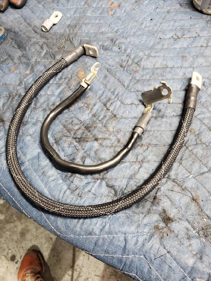

The stock battery cables were too short to use without extensions and I did not want this happening again, so I had Tandem do a 0 gauge replacement on the starter, ground and alternator wires (I realzed there are other ways to do an extension but I wanted a robust solution). Tandem also fabricated a custom mount for the ARB compressor and a new fuse/distribution panel. The effect has been noticeable, with a noticeably faster and stronger start and no more starting or charging issues.
The other thing I wanted to change was the voltage booster. For AGM, I wanted to charge at closer to 14V, and preferably a little over. I also was not too fond of a diode in place of a fuse for the alternator. The best solution I found was by Voltage Booster Pro here in Texas, but unfortunately they did not have anything for LC200s. However, Bryan at VBP was super nice when I reached out to inquire about LC200 solutions and he worked with me to create a solution that worked with my wife's vehicle (he had to modify the design for the Tundra due to a slightly difference in fuse and relay locations). It has a separate, replaceable fuse in line with the diodes, and also has a selectable "low" and "high" booster option, depending on your needs or battery type. It is called the "Spark" model, and Option "A" in the pull-down menu is for the LC200 (Voltage Booster PRO "Spark" (2nd Gen Tundra, 2nd Gen Tacoma, 2nd Gen Sequoia, LX570) - https://voltageboosterpro.com/product/spark/). The cost is a little higher than diode fuse options, but given the better safety and reliability (as well as the cost for having custom circuit boards made) I think the difference makes sense.
I am now getting around 14.2-14.3V at startup and 14V at warm idle on the "high" setting (I have not tested the "low" setting). Overall I am much happier with this solution and hope that it will provide me much better charging and longevity for the AGM batteries. I also like supporting a US-based company who does their own engineering work and has great support for enthusiasts.

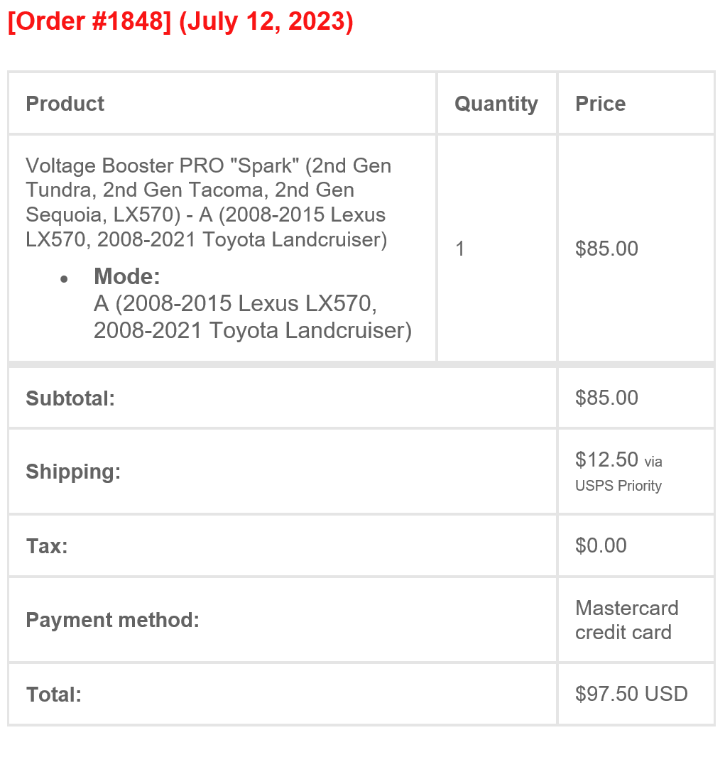

Well... I ordered one of the voltage boosters for my 2013 Land Cruiser:
It arrived today, but was the Mode B model, not the Mode A model as ordered, and will not fit/work in my LC200.
Voltage Booster Pro have not responded to my e-mail yet (it's only been a few hours) and the only number I found on their website dumps me into a Google mailbox bot which requires me to give them a name of the person I want to talk to - I gave them my name and left a message, then called back and left the name "Voltage Booster Pro" and left a message - but no response to either message yet.

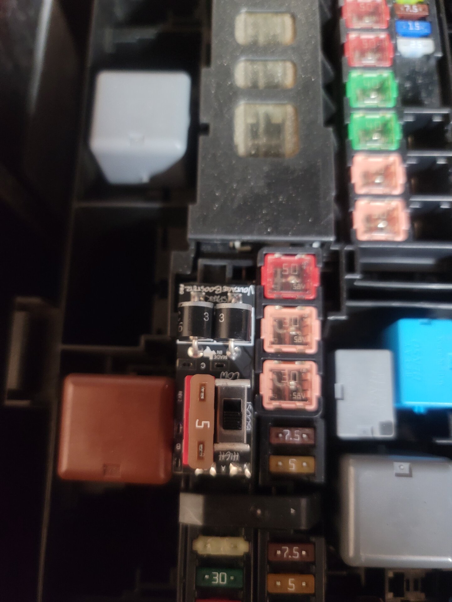

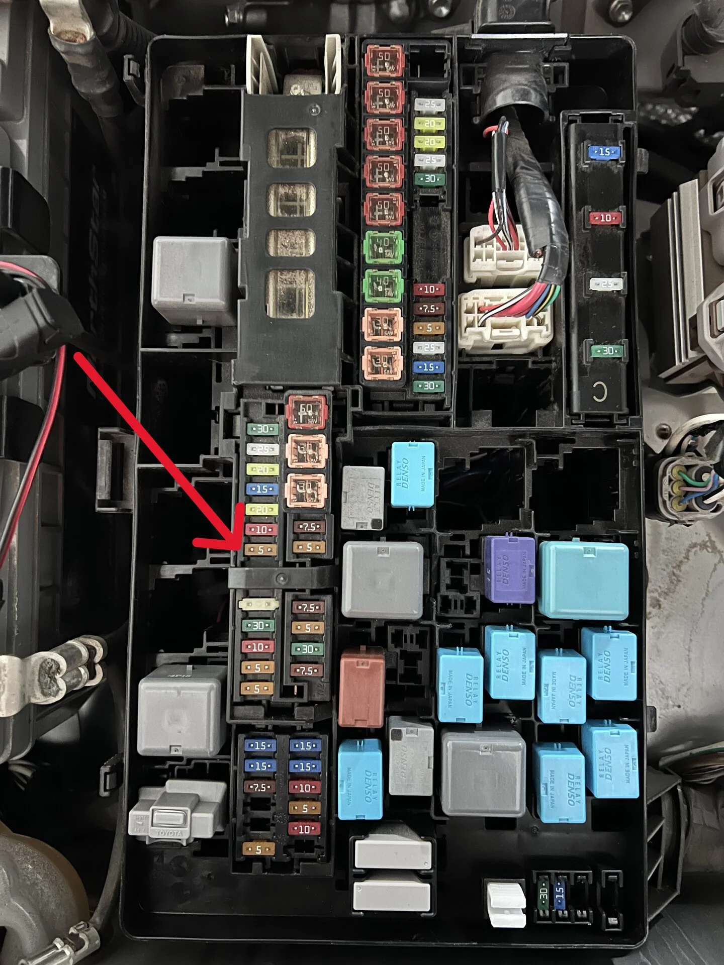

Here is a pic of the fuse box where the ALT-S fuse is located:

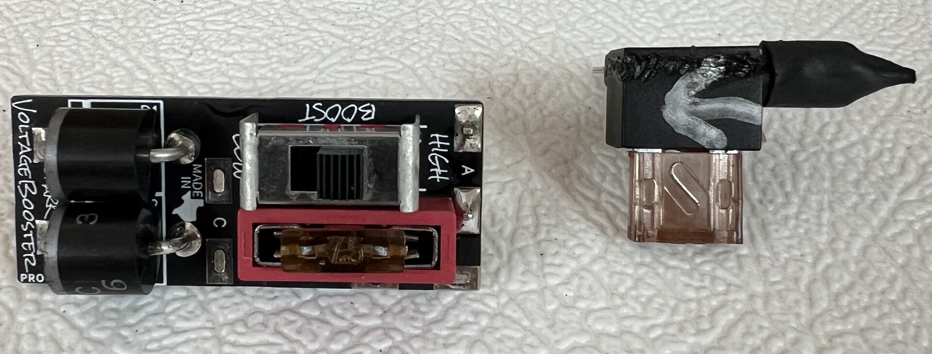

And a picture of the two voltage boosters being tested - VoltageBoosterPro on the left and HKB on the right [Note: the 7.5A fuse on the VBP pictured here was later replaced with the factory 5A fuse]:

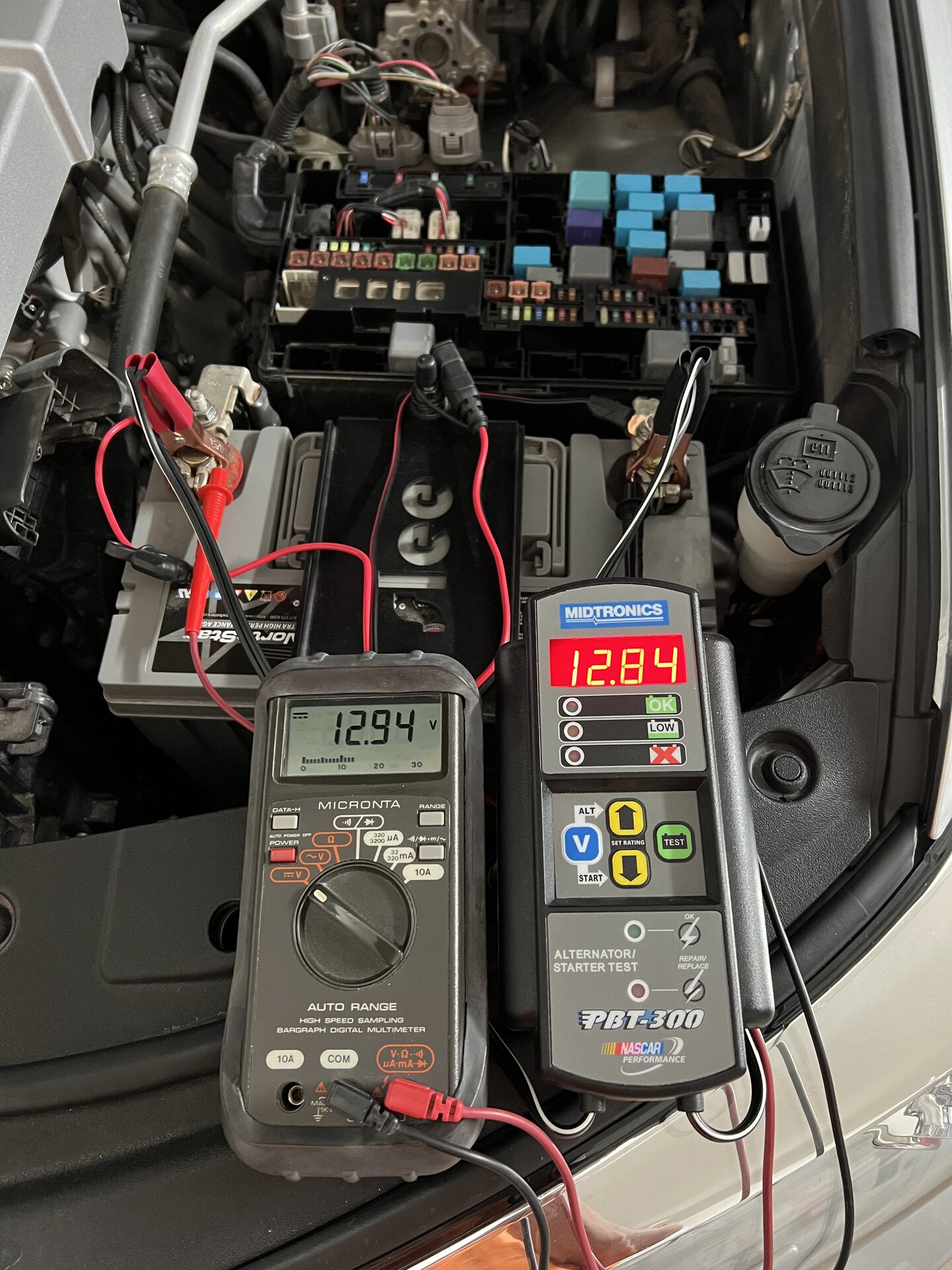

1.
After the LC200 had sat overnight, all electrical loads OFF, and the engine had not been started in over 24 hours, the battery voltage was measured at the terminals:
Multimeter: 12.94V
PBT-300: 12.84V
[Note: Throughout the testing, the multimeter read consistently about 0.1V higher than the PBT-300. I don't think this has any significant effect on the test results, so I have not pursued a cause any further. All conclusions and comparisons, however, will be drawn using the results from the PBT-300 dedicated testing tool.]

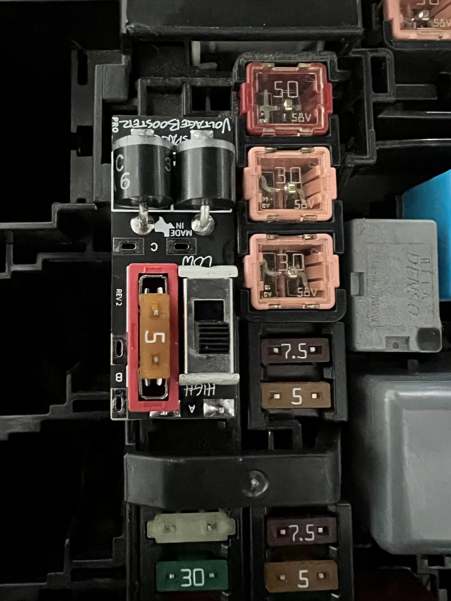

Here's what it looks like installed in the fuse box [new picture with 5A fuse installed]:
Voltage Booster Pro claims the LOW position provides approximately 0.4-0.5V additional voltage over stock and the HIGH position provides approximately 0.8-1.0V additional voltage over stock when performing their recommended tests.

  • Install Voltage Booster Pro, start engine and take a multimeter Voltage reading at the battery immediately after starting the engine: LOW: HIGH:
5. Measured VBP - LOW alternator output @idle:
Multimeter: 14.03V
PBT-300: 13.95V
6. Increased engine rpm to approximately 2,000rpm for 15 seconds and measured the highest average charging voltage for the VBP-LOW:
PBT-300: 14.00V
Voltage Booster Pro (VBP) set to HIGH:

HKB Voltage Booster:
9.
Measured HKB alternator output @idle:
Multimeter: 14.10V
PBT-300: 14.01V
10. Increased engine rpm to approximately 2,000rpm for 15 seconds and measured the highest average charging voltage for the HKB:
PBT-300: 14.38V

CONCLUSIONS:
1. Voltagae Boost Pro met their claimed performance gains.
Voltage Boost Pro claim:
In the LOW position, charging voltage @idle increased from 13.49V to 13.95V (0.46V additional voltage) as measured on the PBT-300
In the HIGH position, charging voltage @idle increased from 13.49V to 14.35V (0.86V additional voltage) as measured on the PBT-300
2. When set to HIGH, VBP meets the Required Cycle Service Voltage for my battery.
Required Cycle Service Voltage: 14.4 – 14.8V Maximum @25 DegC (77 DegF)
VBP-HIGH @2000rpm delivers a charging voltage of 14.40V @95 DegF
Note: AGM batteries should be charged at lower voltages when temperatures are higher. In general, a default temperature correction of -25mV/DegC or -14mV/DegF should be OK for charging all AGM batteries. If you are really curious, there's a lot of good info on this site: WORKSHOPPIST.com What that means for this test, where the ambient temperature was about 95 DegF, a corrected Cycle Service Voltage should be reduced by about 0.25 DegF, so the corrected spec would be:
Required Cycle Service Voltage: 14.15 – 14.55V Maximum @35 DegC (95 DegF)
After installing the VoltageBoosterPro set to HIGH in my LC200, charging voltage was boosted to a level sufficient to charge and maintain my AGM battery in a healthy state.
Let me know if I inadvertently screwed anything up.
